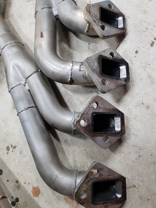

Well, I have managed to change out the valve springs to 140 on the seat and swap over to my usual oil. I still have some jobs to do. As it has all new mounts engine/trans sits a little higher which means that under power the left exhaust is hitting the trans crossmember. Also the chassis mods mean the handbrake mechanism is compromised so I will make another trans crossmember soon to maximise clearance & fix the handbrake. I also need to get the surge tank/pump out of the engine compartment. On hot days the heat soak into the fuel is terrible & I think I can actually hear it boiling in the tank after a while! I am surprised at how well it goes though. The gear change to second is more violent than before & I have lost a strap from one of my leaf springs which probably does not help. It just goes to show that the previous cam was a bit too large for combination but I do miss the rumpty rump! The only thing different apart from the cam is a zero decking, a light blend of the inlet manifold at head area and removal of a step in the headers. I am guessing this made a significant difference. The headers used to impinge on the top of the port a little less than 1/8". This cant have been good. The Sniper tuning is going well and it runs really good. Just have to dial in cold starts a little better. When I have sorted out a couple of the issues mentioned I will really let it rip.
Pics of spring change & header blend.
« Last Edit: January 17, 2021, 04:43:05 PM by 66FAIRLANE »

Like the size of your diegrinder ;D

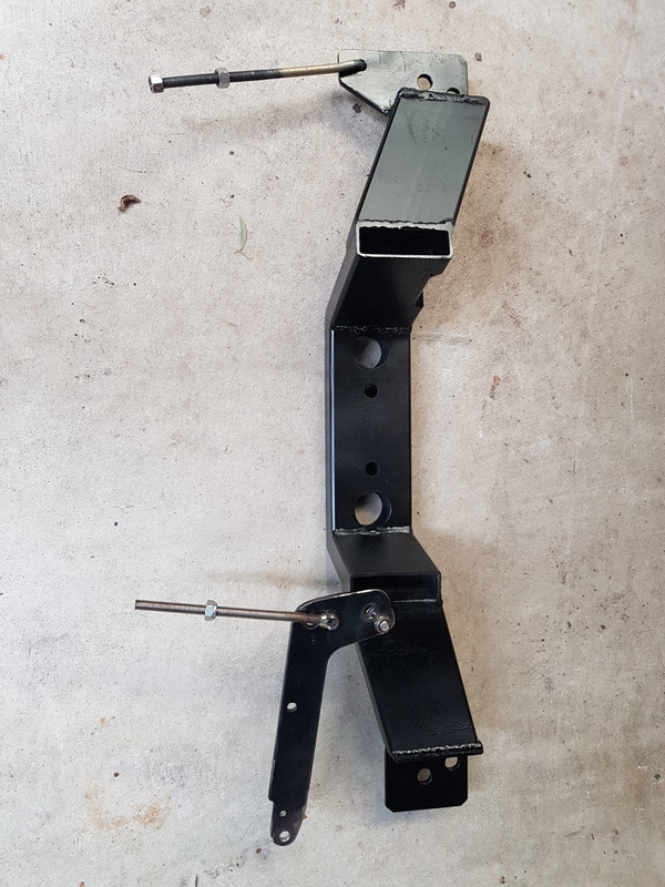

« Reply #74 on: July 19, 2021, 05:47:59 PM »
Well I finally got some clean air for a couple of days to make a new trans cross member as the one that was in there was a modified C4 one and the exhaust tapped it on acceleration. I hugged the floor as much as possible and have gone from under an 1/8th to over an inch clearance on each side which will allow me to remake the exhaust with higher collectors (I like low cars). But that will come later. I also used both bolt holes at the chassis mount to make it more rigid. At least I can now give it the full beans without anything hitting....I just need it to stop raining. I also relocated the surge tank to the rear and ran two brand new fuel lines. Having it horizontal is yet to present an issue.....except when I forgot to re-hook up power to the lift pump....it would stall around right hand corners. But at least I know if I loose the lift pump it will still run enough to get me home.
