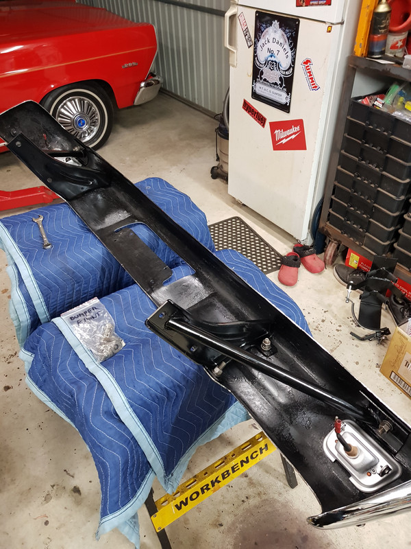

Both bumpers have been cleaned up, had their brackets and bits blasted, painted & they have been refitted to the car.

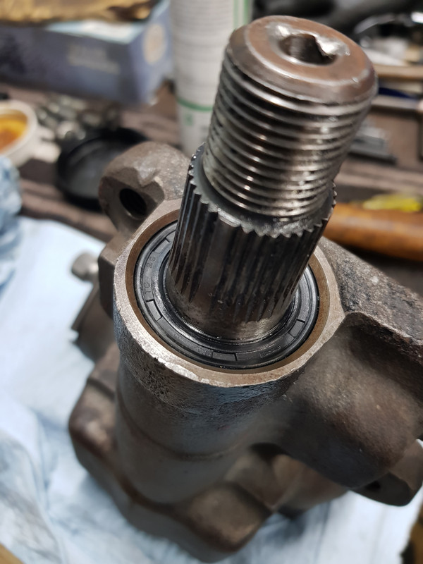

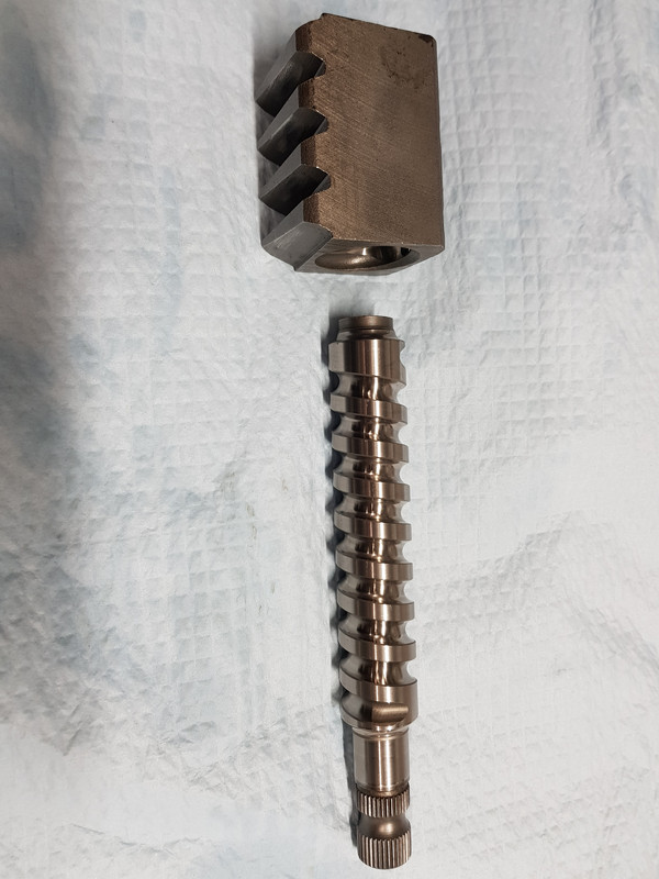

The steering box was disassembled, cleaned, inspected, deemed to be in good condition & reassembled. There are a couple of points of interest here. Its an Aussie 16:1 box but most likely just an opposite hand US item so take these points with a grain of salt.
1) I was advised by Randy at Stangersite that my box should most likely have 54 balls in it. It indeed did have 54. But there was space for another two with room to spare,.... so in they went! I can't really see why you would want significant space in a worm drive system so time will tell. Will be interesting to see if the steering response tightens up.
2) Bottom seals were hard to come by in Australia and as I wasn't removing the needle bearings (all looked good) the seal would be hard to remove without damaging these. There is however a largeish, for want of a better word, counterbore in the bottom below the seal bore. It looked to be concentric to shaft and rough measurements couldn't prove otherwise so I thought I would see if a seal could be sourced with the right ID for the shaft that would fit in the counterbore. There was nothing imperial. But as luck would have it a metric 43x28x7mm fitted in just right. So the original seal stayed in place & this went in over the top. Could be a handy fix for sealing the box while still in the car.

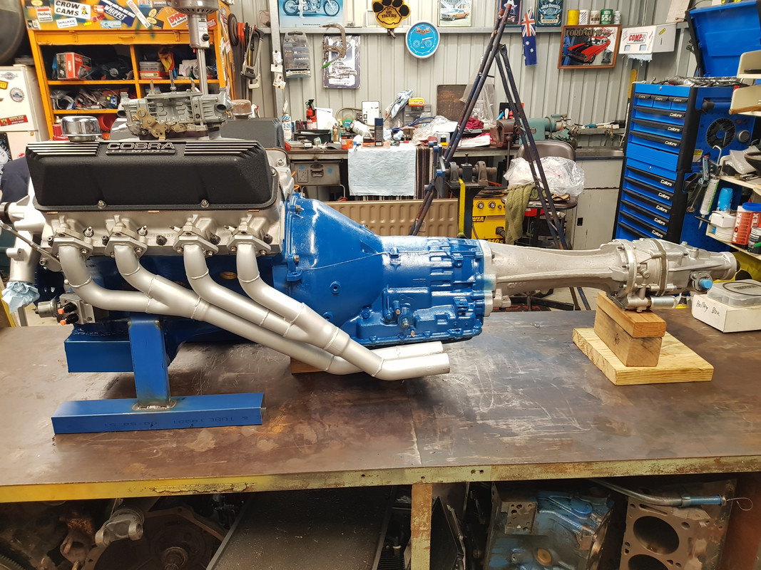

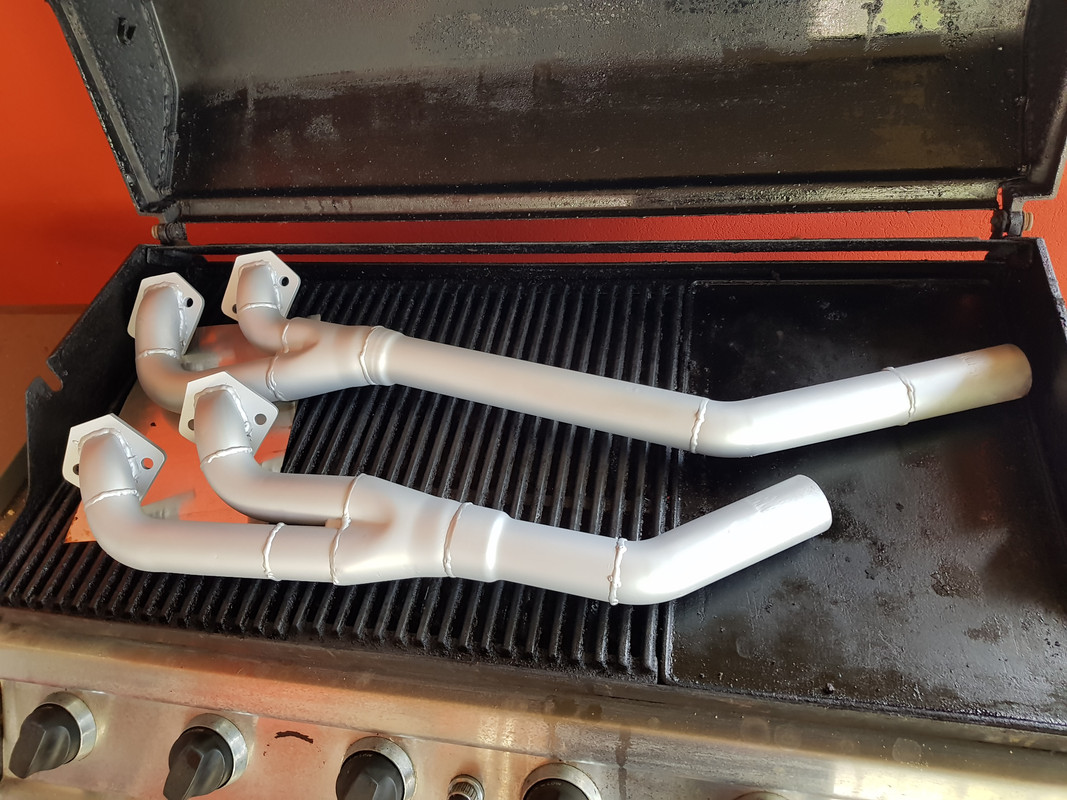

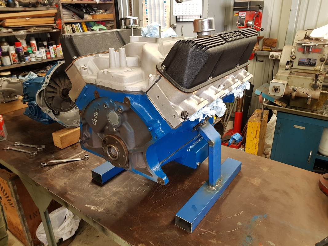

Ok, small update. My ceramic coated headers were looking a little worse for wear after 20+ years. Not wanting to fork out for another coating I decided to paint them with the best high heat paint I have found (Rustoleom) just to freshen them up. Luckily they fitted in the BBQ so I could give them a few heat bakes :)
Also made some stands & got the engine onto the bench where I can fit the flexplate & then mate it all up to the trans.
Re: 66 Fairlane Hardtop gets a birthday
« Reply #50 on: June 29, 2020, 07:57:20 AM »
Andy, I think you're going to love the smell those headers make after they've been in the Barbie.  Make sure you've had lunch first so you don't get too hungry!   Did you blast them first before the Rustoleum treatment?

Hi Bruce. No didn't blast them. The ceramic coating was still reasonable. Just rubbed them a bit with abrasive paper & wiped them with prepsol. Will see what happens.

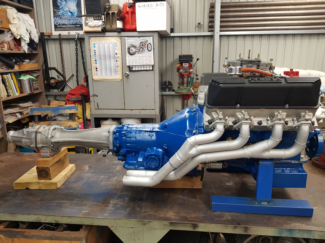

« Reply #52 on: July 05, 2020, 08:30:46 PM »
Managed to get everything bolted together on the weekend. Little bit of work left to do cleaning up & painting ancillary brackets & stuff but my main attention now turns to the engine bay prep. It looks so cool sitting on the bench I almost want to leave it there!

« Reply #53 on: July 05, 2020, 11:36:21 PM »
Very cool, making progress is always a good thing. Are the exhaust headers custom made? I can`t imagine that there are many companies building headers for FE powered RHD Fairlanes! I can imagine having both the starter and steering box on the same side eats up a lot of what little space a FE Fairlane (or Mustang) normally has. Good thing you don`t have clutch linkage to squeeze in there as well.

« Reply #54 on: July 06, 2020, 01:05:20 AM »
Hi Rory. Yes I made them 23 years ago. And you are right, there is not much room, hence the decision at the time to go tri-y design as it would be a nearly impossible to get 4 pipes out that side neatly. In Australia most of these era cars had hydraulic clutch sets ups which would make it easier....although I think the MC would hit the rocker cover....I do have a toploader lurking around.

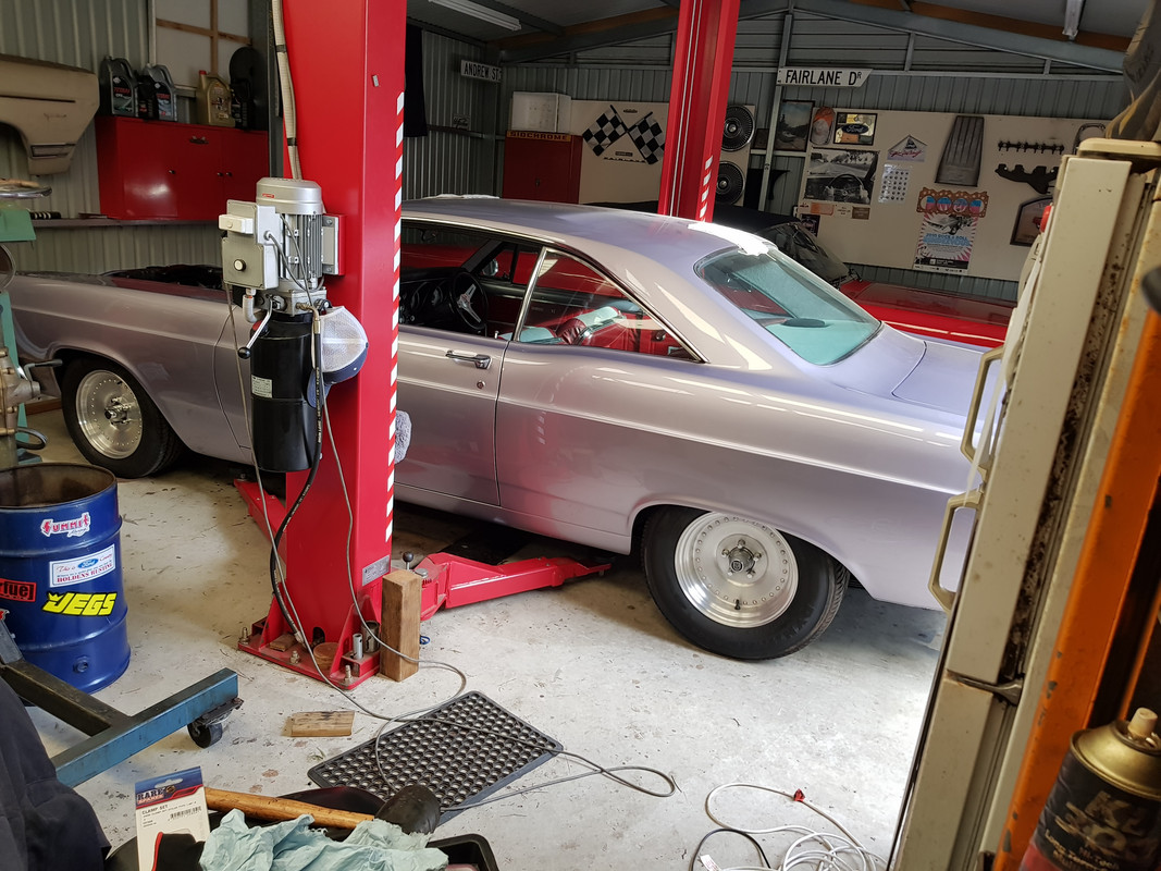

« Reply #59 on: November 18, 2020, 06:44:52 PM »

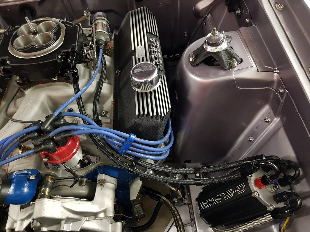

Well it's been on the road for a few weeks now. Did a cam break in, drove it about 20 miles & dropped the oil. It seemed to free rev quite snappy but I was a bit disappointed with how it went on the road and was starting to doubt my cam decision. I was aware though that the carb was straight off my other engine and would most likely be too fat everywhere. Having the EFI to put back on I was not going to mess with the carb. So I put another lot of 'break in' oil in it for now and and refitted the Holley Sniper. After it sitting around for 2-1/2 years I was worried about it drying out & whether it would still function properly. I can report that it is operating properly and it is chalk & cheese. Picked up power significantly everywhere & I think I will be happy with cam choice (although I miss the rumpty rump). I am yet to see how it really goes as I have break in springs (85lb on seat) still in. Need to swap springs, another oil change, do a bit more tuning on the Sniper & let it rip! Also contemplating moving the Pump/surge tank as it gets nasty hot under the hood. A few pics 'caus pics are good. :)
