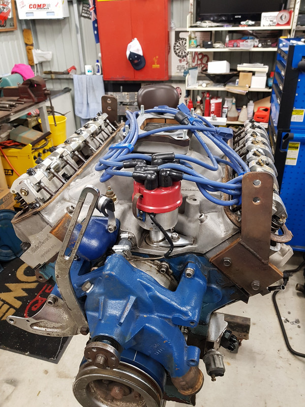

My hand was sort of forced last year when I forgot about a leaking water pump & drove it, rather hard & ended up with all my remaining coolant in the sump. So out came the engine.....you know how it goes from there.

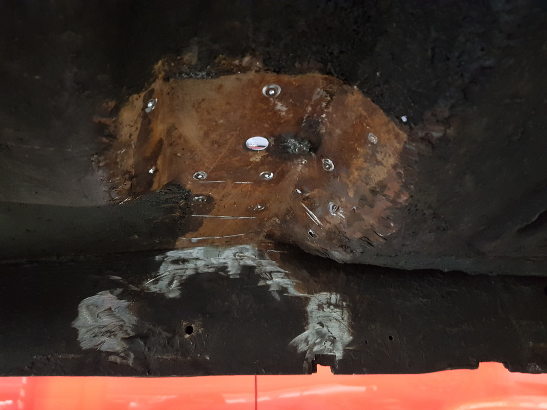

Pics of the car before. Yes it looks like there is nothing wrong with the body but there areas of filler making its presence known.

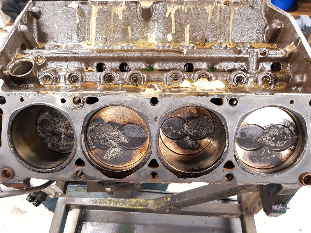

Pulling a rocker cover exposed this
Engine coming out & on stand

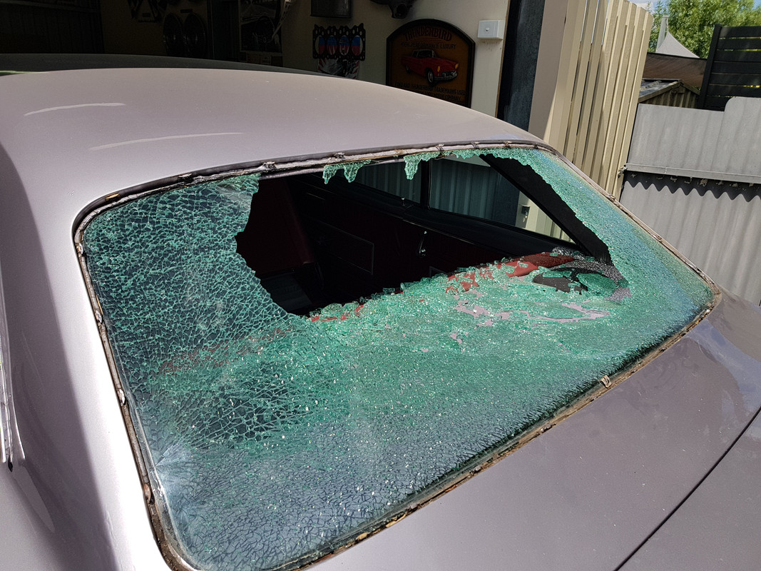

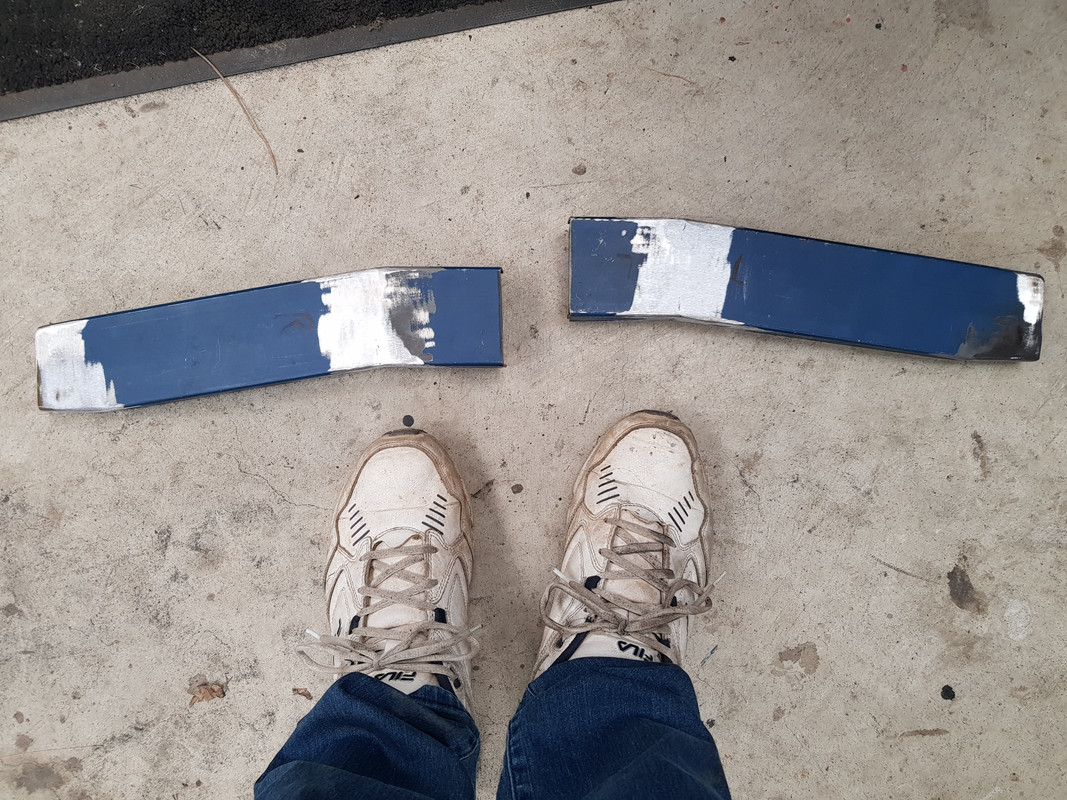

With engine out I decided to fix up the hump where I had cut it to fit the GV overdrive. So I dropped the trans onto the ground & attempted to slide it out. Car was a little low & I couldn't slide it out by about an inch so I jacked up the front corner probably about an inch & a half, reset the jack stand dragged out the trans/OD unit. Feeling pretty good with myself I had a beer & walked away.
Let me say at this point the rear window had been 'stuck' in by a previous owner. The proper seal was not present so the rear window was a stressed member. I was always surprised out how little this car twisted when jacked up.
8 weeks later I was in the shed looking over things when BANG & I mean BANG!....this happened. I had forgotten to lower the front corner.
This took the wind out of my sails for quite some time & it was several months before I got back into it.

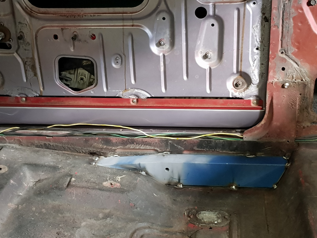

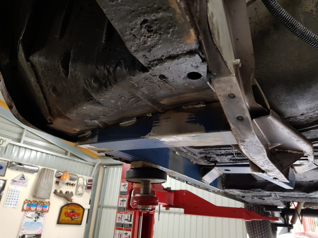

I have always wanted to put sub-frame connectors in this car, especially since it has the front cut off to convert it to right hand drive, so now seemed liked the perfect time.
I have seen a lot of people put RHS from the transmission carrier arms (for want of a better word) through the rear floor to the rear torque boxes. I didn't want that so after I examined how Ford did it (I have a convertible too) I decided to go down the sills. I like my cars low so ground clearance is also an issue.
I removed the small brace where the front seat bolt goes & cut a hole to get to the rear torque box.
Fabricating & inserting the sill braces

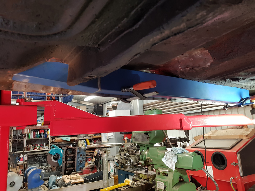

I figured I would concentrate on the body & hopefully the Aussie dollar would improve before I buy engine parts. That has not happened yet!

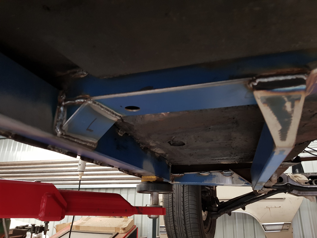

Next up was to box in where the seat fronts bolt, similar to the convertible.
I also made up braces to go from the trans arms to the new box section.
Then I had to fabricate some braces to help tie the Sill braces to the front torque boxes
  • Posts: 605
  • Andy
Re: 66Fairlane gets a birthday
« Reply #4 on: July 25, 2019, 09:02:26 PM »
Well yesterday I finally got it all welded in. Well mostly, I still have some tidying up to do. This should stiffen it up substantially!

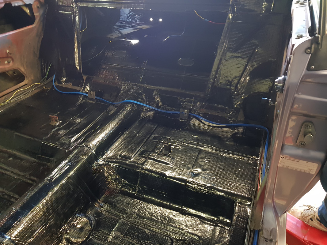

I have applied some body adhesive to some of the seems underneath and now it just awaits paint. Inside I have applied Chinese Dynamat rip off (about half the price). I thought this might be fun. Noooo!! It takes quite some time and the fun stopped after about 5 min. Its hard work getting into all the crevasses. Nearly done, just one door to go. I have also cleaned up & reconditioned the shifter & hump. A little more wiring to tidy up & the carpet & seats can go back in.
