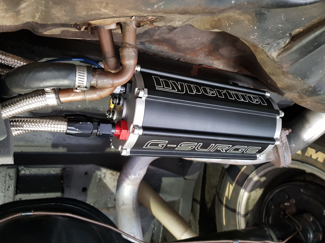

What spot did you end up mounting the surge tank?

« Reply #76 on: July 20, 2021, 05:07:28 AM »
I will take a pic for you in the next couple of days. Actually fitted pretty good.

« Reply #81 on: July 23, 2021, 01:58:43 AM »
Here are a couple of pics of the surge tank mounted. Still have a bit of tidying up to do.....one day. There is a small carb type pump that pumps in one of the side fittings. The top fitting returns to the main tank and of course the EFI pump flows out the bottom. The EFI returns to the other 'side' fitting.

« Reply #82 on: July 23, 2021, 09:54:08 AM »
nice fix that should work well in that spot
