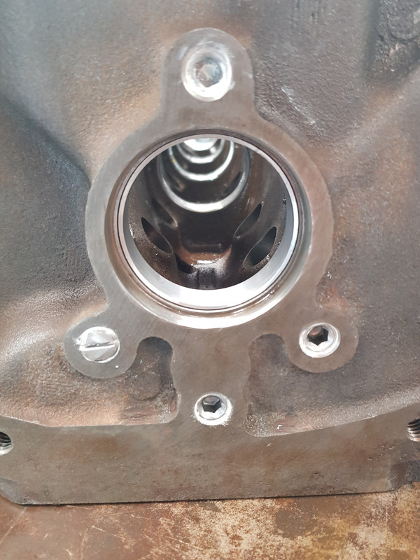

Just a brief update. Travel, family commitments & a persistent back injury have meant time not a lot of time on the car. I have managed to get the windscreen trim & wiper panel back on. Very scary procedure on a freshly painted car! The window mechanisms were very tight so out they came & had a soak in petrol. Several soaks & lots of compressed air later they were ready to lube. I used boat trailer bearing grease in the gear mechanism & silicon spray lube on rollers & spring area. The spring was prised open with a screwdriver for cleaning & lube. Managed to get them back in & one window yesterday. The difference is amazing. Have placed more sound deadener inside the doors on the outer skin & am doing more now in the boot (trunk :) ). Have my block back from the machine shop. They hit porosity in one of the bores & fitted a sleeve. I now have to dummy it up for zero deck & return it. Hardest thing is finding the time & having my back hold up.

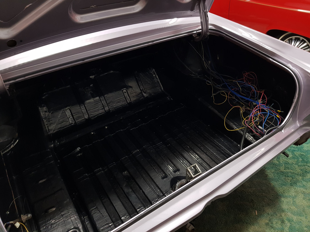

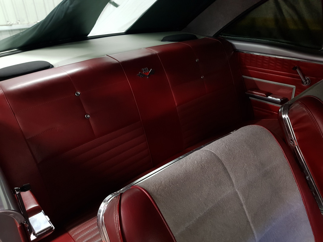

Getting more done as my back allows. Have full interior back in car, boot (ok,...trunk) fully sound deadened with carpet & battery box back in.

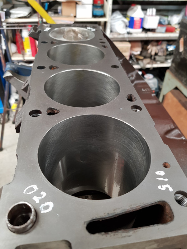

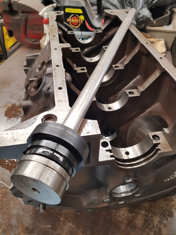

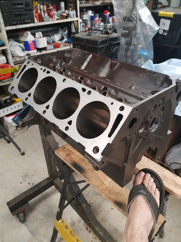

Managed to dummy up the block for final decking yesterday. I just used one rod & piston & cycled it through the 4 holes. Checked with a depth mic & then straight edge & feeler gauges to confirm. Will most likely gap the rings while I still have the block & then while it is at the shop I can assemble pistons, rods & rings in preparation. A few pics.

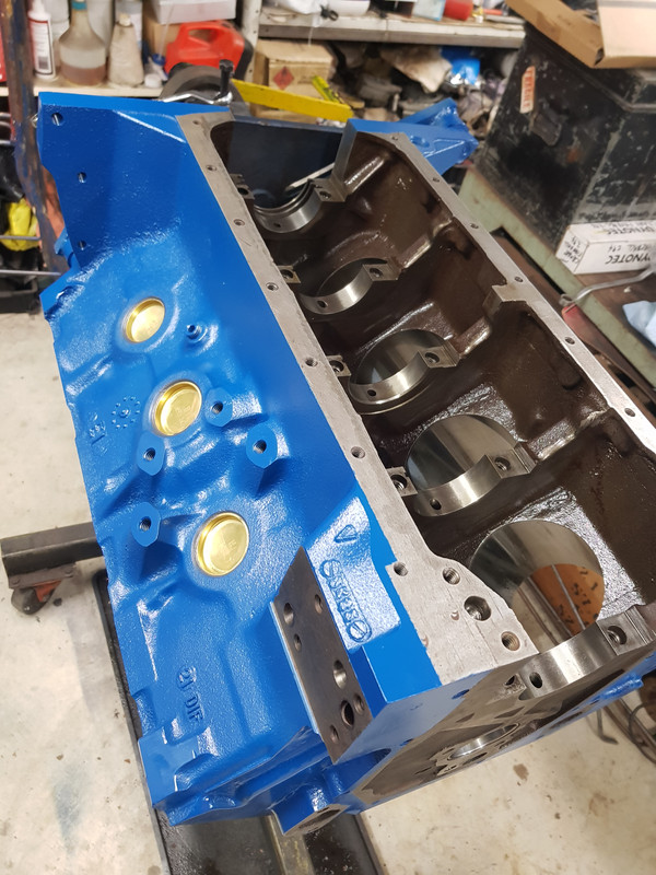

Got my block back from the machine shop zero decked. On to my bench, cam bearings installed & rear plugs in. One of them a previous owner had taped UNC so a special plug was made from a bolt.
I then had to wrestle the block onto my stand by myself due to the Chinabateatingfuckwit disease isolation. So I thought I would do the right thing and at least wear Chinese safety boots! Probably the last time as the weather is turning cold here. Block got painted, more plugs in, bottom end and cam in and all clocked up. That's how it sits now.

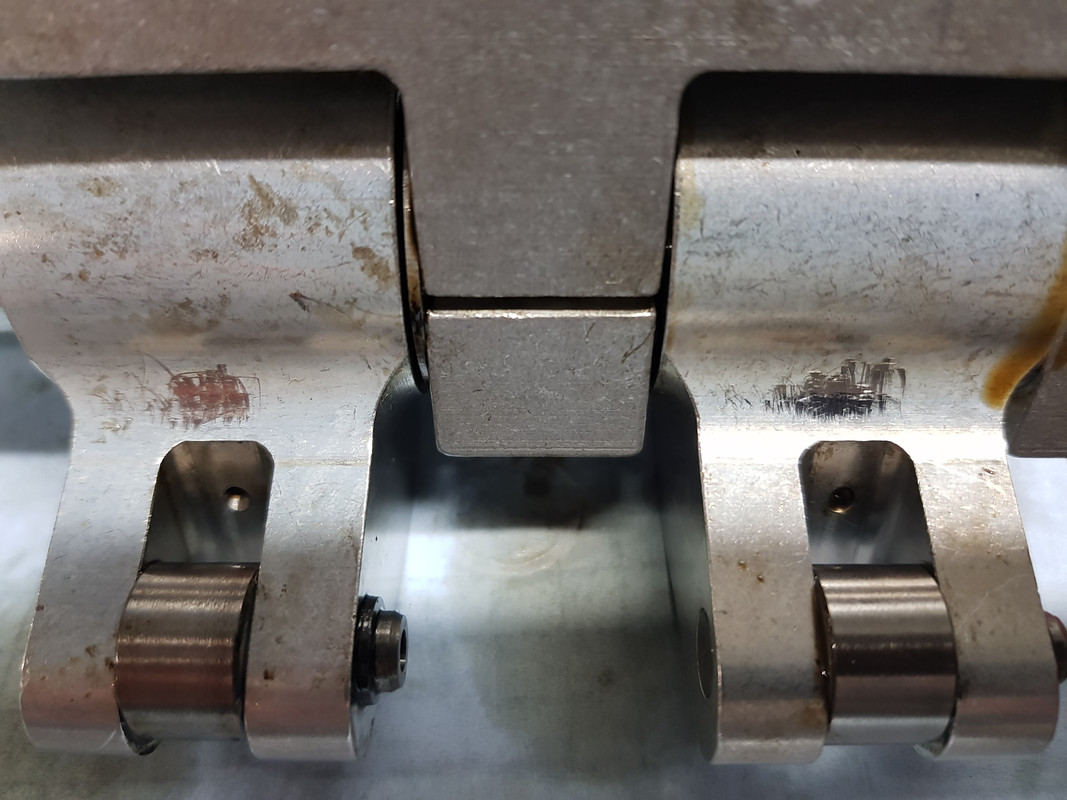

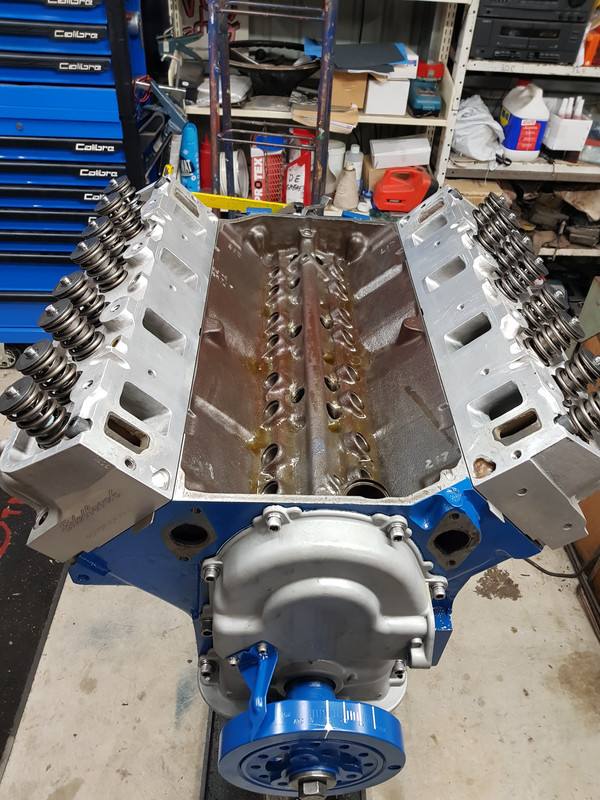

Not much of an update but I have made some progress. Bottom end is in and heads back on. Currently measuring up the manifold as its going to need a tickle to sit properly. Looks like a bit of an angle top to bottom on one side (005 to 0020) and a straight 020ish off the other side. Also dummying the rocker assemblies to see if everything clears the holes. There is some evidence on some close conversations between pushrods and the bottom of the pushrod holes in the manifold. Also between retainers and underside of rockers as pictured.
I checked my valvetrain geometry mathematically. I measured the height of the fulcrum point of the valve (centre of rocker roller) from the rocker stand pad. Then deduced how far that was at mid lift (taking lash into account). Then for the rocker to be perpendicular to the valve at this point (line between valve fulcrum & shaft fulcrum) how far off the pad my rocker shaft centre had to be. This will give the same arc travel above & below midlift thus giving the smallest tip pattern & maximum use of rocker ratio...……...I think. Anyway the figures ended up that I need the shafts 050 higher. For a street engine I think this is close enough so won't be shimming stands.....unless someone can convince me otherwise.
Heres a few pics.

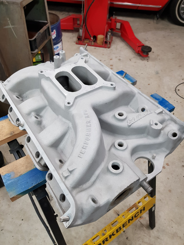

Have my manifold back from the machine shop. It needed a bit of a nibble to sit down properly. .020 to .030 on one face & a straight .020 off the other. I dummied it up with rocker gear again and the tubes on one side are very close. They may again 'lend their support' to a few pushrods....or maybe not. I did a little blending on the sides & roof of the port & it is ready to fit on permanently. I also have my sump cleaned and painted ready to go. Just need to clean up some more bits & it's full steam ahead. Seems like I spend most of my time cleaning stuff!
