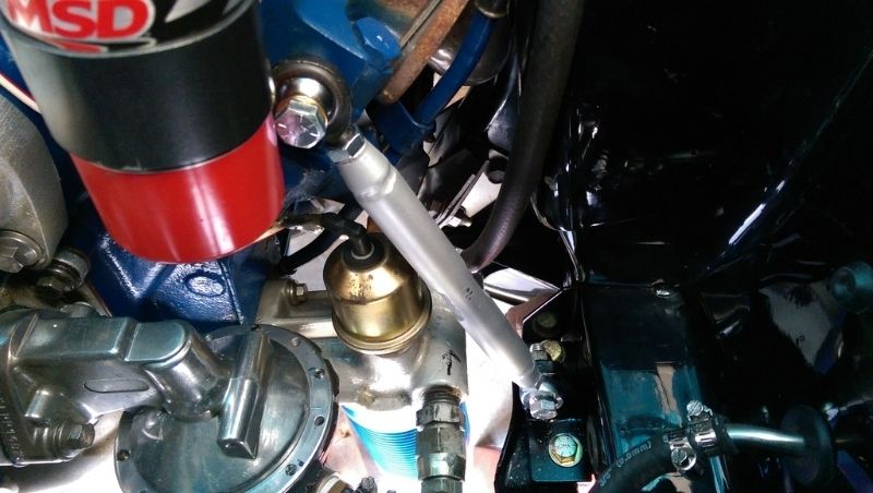

First, something I've wanted to do for a while but kept putting off, I finally made a torque strap for the engine. One reason of course was safety, not wanting to take out the hood, radiator and a bunch of other stuff in the event of a motor mount failure, the other reason, to stop my header bolt from pecking at the shock tower, which amplified inside the car and was annoying. Being factory MR heads, they don't have the side exhaust bolts, and it's readily apparent why Ford needed them in shock tower cars.

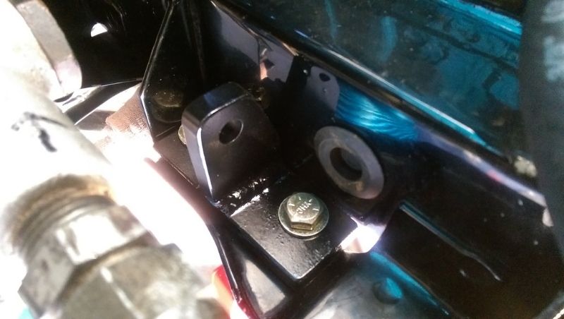

Since I don't run a sway bar, I made a bracket to bolt onto the mounting point on the frame. It's perfectly inline with the head, so it was a great spot to make an anchoring point.
Then I welded some rod tubing ends to a piece I made and bolted it to the head and bracket. Hopefully there isn't enough leverage against the bolts to break it. That's the plan anyway ::)

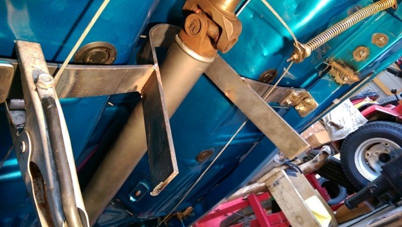

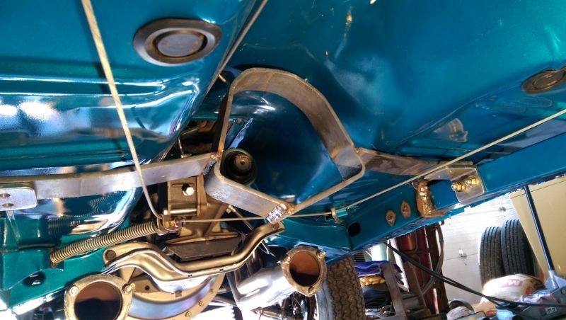

Then I made a driveshaft loop. Something that I should have done LONG ago. I didn't like the generic versions that you could buy, they just look like they're a 1-size-fits-all kind of deal, which they are. I also needed something that hugged the floor a little better since I have my exhaust tucked up kind of high, against the floorpan. A bar that went straight across would have interfered with them. Since I just installed the subframe connectors, it was the perfect place to bolt the mounts to. Here's a shot of the mounting brackets and the loop about 3/4 done.
And here's the finished deal.
I didn't like the way the bottom of the strap came together, it was supposed to overlap more for strength. So after the Reunion, I'll cut that bottom section out and make a smoother bottom loop, overlap it on the sides more, and weld it in. I laid some extra heavy welds for now though, so it'll serve its purpose. I also ordered a Mark Williams driveshaft with 1350's at both ends with their slip yoke. When I was finishing the car, I used a stock yoke with the 1330 and had a local company weld me up a shaft with 1350's to match my rear. The front was always a weak point, and that was not a good thing. The new shaft is chromemoly and should hold up nicely. It's supposed to be here tomorrow. Except for some paint touch-up and my line-lock, the car is done and ready. Until I decide what I want to do next to it ::)

I'd leave the center section as is. It looks mighty strong if not 100% sexy!  ;D
