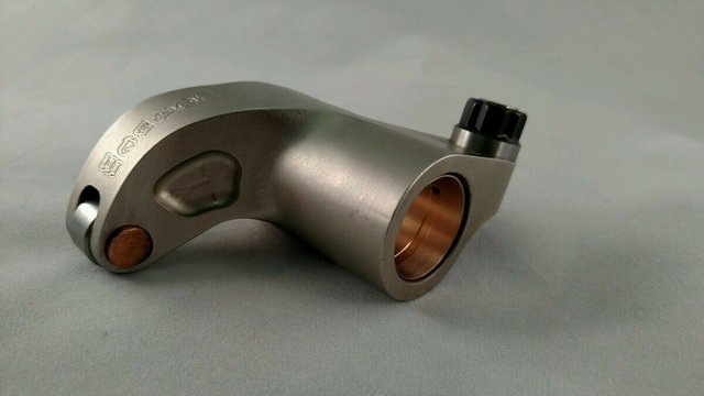

OK, here's a quick update.  Lots happening on this project but it all seems to take too long >:(  Right now I'm trying to finish up the rocker arms, which are the biggest hurdle to getting back on the dyno.  The picture below is of two of the rockers that are nearly finished, plus some of the raw castings that I start with:
Here's a close-up of the two rockers that are mostly machined.  You'll notice that the intake rocker isn't finished on the adjuster end.  This is because I have not yet completed the fixture necessary to put the hole for the adjuster in that rocker at an angle, to match up with the intake pushrod angle.  The fixtures are the long pole in the tent on this project; they seem to take forever to machine.
The photo below shows the first fixture that is used to machine the rockers; in this case the rocker castings fit into pockets in the machined steel fixture, they are clamped down with bars that go across the fixture, and then the holes for the rocker shaft and roller tip shaft are machined.  This particular fixture took 4 days on the CNC to get those pocket cut right:
There are a total of four fixtures that are needed for the rockers, and I have three of them machined, and also have run the first pair of rockers on them.  The fourth fixture is the one that puts the angled adjuster hole in the intake rocker, and I should be done with that one in a few days.  Then I can write the programs to machine the adjuster hole, and test machine the first intake rocker.  Once that is finished, I can machine a complete set of the rockers with just a little more work.
However, there are also rocker parts that need to go off to heat treat yet, and that will take 7-10 days, plus I need to order new pushrods which will take a week or so, so I'm probably 2-3 weeks out before the engine is running again on the dyno.  I was expecting to be running by now, but as usual there have been delays.  In fact, I had a CNC machine that I use for a variety of products, including these rockers, come up with an electrical fault a couple weeks ago, and it was down for over a week.  Plus the motor on my air compressor went out, so I had to get a new one of those, and of course the first one I got was defective, and quit after two days  :(  Everything is up and running again now, but you can never tell what is going to happen to slow you down.

Those rockers definitely give a warm fuzzy feeling now that they're in steel.
Impressive work on the fixtures. I was picturing something that did one rocker at a time.
Re: Update on the FE Power Cylinder Head Testing
« Reply #71 on: November 21, 2020, 09:08:30 PM »
Thanks for the kind words.  Doing one rocker at a time would not be economical; too much setup time, and my own time, to make them saleable at any reasonable price.  In fact for operations 3 and 4, I can only do four of the rockers at once, but I can live with that and still keep the costs down.
