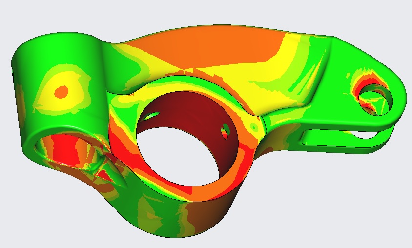

My pal Bill Conley took the first iteration of the designs and ran them through his FEA  program, to see where they were stressed with 1000 pounds of valve spring pressure.  Bill's help has been crucial to this effort, and right away he thought the designs had promise, but could use a little tweaking.  I would not have known where to add material or how to analyze these designs without Bill's help.  We went back and forth on this a few times, where I made modifications to the file and Bill analyzed them, and we finally had an intake and exhaust rocker design that looked solid.  The pictures below are from Bill's FEA software program, showing areas of stress in the rocker arms with the aforementioned valvespring pressure.  Red areas are to be avoided if possible, but Bill thought that based on his experience the red areas on these plots would not be a cause for concern.

The areas in red were not where I was seeing failures on the aluminum rockers on the dyno, so it seemed like I could proceed with these designs.  One concern about the steel rockers was weight of course, but these designs turned out to be nearly as good as the aluminum rockers.  Moment of inertia is a measurement of how a body resists acceleration forces, and is the key metric for achieving a lightweight valve train.  According to the FEA analysis, the exhaust rocker has a moment of inertia only 8% higher than the aluminum version, which is not much of a difference.  The intake rocker is even better, at only 1.5% higher; basically it is so close as to be the basically the same as the aluminum version.

In the meantime Bill and I got to talking about fatigue life of the steel rockers; I was curious about what could be expected there, so Bill ran yet another analysis to figure this out.  In the charts below the different colors relate to a baseline of 50 million cycles.  Orange is exactly 50 million cycles before the onset of fatigue issues, yellow and green are more cycles, and red is less.  Again based on Bill's experience the red areas are not a major concern.
Exhaust Rocker:
Intake Rocker:
This analysis again assumed a 1000 pound valve spring when the valve is fully open.  The 50 million cycle number should go way up with lower valve springs pressures, like 800 or 600.  So based on this I'm feeling pretty confident about this design.  The dyno testing will tell for sure, at least in the short term.

I don't know if Bill is plotting "effective stress" or "max principal stress" but "max principal" (or max principle as engineers often spell it) would get rid of any red areas that are in compression, since those aren't likely to be fatigue failure points.
Maybe the color fatigue plot is looking at max principal stress (and/or max shear stress), so those colors would more represent possible failure sites.
Werby -  The stress plots are actually Von Mises stress values.  It's similar to Max Principal, where you're getting one effective max number for each tiny cube of the rocker body.  (For non-material science nerds, there are stresses acting on each face of the tiny cube, plus shear stresses across opposing faces of the cube.  You want one number to measure how each tiny cube is doing overall...)  Von Mises stress tends to be more accurate than Max Principal in my experience on these types of things.
The fatigue plots are for a whole other phenomenon - development and propagation of cracks.  It uses the "Unified Material Law".  Stress doesn't kill parts that are repeatedly loaded.  Cracks are the culprit.  That's why the plots look so different.  The colors show areas where cracks are most likely to occur.  They don't always match the areas of highest Von Mises stress.  Interesting!

Interesting stuff.  Especially this particular stress diagram.  I acquired a box of Harland Sharp parts which included a couple of their aluminum rockers that were literally peeled away from the adjuster boss right where that red spot is.
