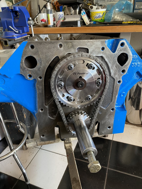

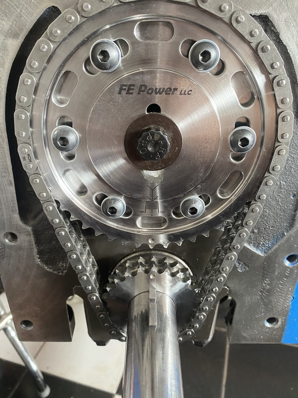

« Reply #125 on: April 10, 2021, 03:17:12 PM »
I know it doesn’t sound like much but it was the better part of a morning for me.
I installed the timing set. I know you should be able to throw those on in a minute.
But I think I found something else you only think about when you’re doing everything yourself.
The Pioneer PK-9 keys need a little massaging. At least to fit on Mr. Browns beautiful timing set.
Jay told me he likes a tight fit (two, three.....joke) so he makes them that way. On a Scat crank snout it’s pretty darn tight. The Scat snout is a good .001 bigger than the gear inside diameter. I could have gotten it on but I didn’t want to beat on my junk (two, three....next joke) that much. After talking to Jay and him assuring me I was ok I started to cold fit the gear onto the keys and snout. I could have heated up the key and been ok but I was a bit worried about the key fit. They were 2 or 3 thou higher than the gear key way and would not fit in the keyway. So I took some fine grit Emory cloth to the inside of the gear and filed the keys down a couple thou. After two times trying for a fit it finally went on and good and snug as it should be. Totally aware that I could go overboard on filing but it has a nice tight interference fit.
Effortless rotation on the crank and cam together. It really feels wonderful.

Re: CJ love
« Reply #126 on: April 10, 2021, 05:01:55 PM »
Couple things you can check here:
1.  The lower right thrust plate bolt is often too long, which blocks off the feed hole from the front cam bearing to the distributor shaft/gear.
2.  The length of threads inside the cam can vary from core to core.  I always do a depth check from the outside of the timing gear to the depth of the cam bolt hole.  I have ARP cam bolts in 1.5/1.75/2.0 lengths and they vary from build to build.  You want adequate engagement, but obviously not too much so that the threads bottom out before it's tight, or not enough that the bolt strips out when torqued.
3.  Check for adequate camshaft end play.  I surface grind new thrust plates, 10 at a time, so I can have adequate thrust plate.  Out of the box, they generally don't have any end play, or just a couple of thou.
4.  Make sure you have clearance between the cam dowel pin and the cam bolt washer.
Re: CJ love
« Reply #127 on: April 10, 2021, 05:26:35 PM »
Thanks I did check the length of the cam retainer bolt.
With the retainer thickness it clears great. Jay supplies the bolts with his set. They have a low head and are correct length.
I did check the cam bolt, all good.
I used the original retainer plate.
Cam has .0085 end play
The cowl pin does stick out about .017

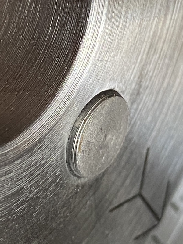

Re: CJ love
« Reply #128 on: April 10, 2021, 05:42:54 PM »
You need to whack that dowel pin off so that the washer isn't loaded on one side.  The pin needs to be below flush.   It only needs to stick out when it has to engage a one piece pump eccentric.

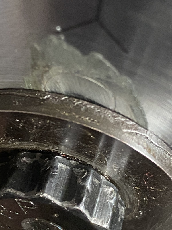

Re: CJ love
« Reply #133 on: April 11, 2021, 01:48:46 PM »
Well I promised I would show this build warts and all in order to pass along lessons learned.
Here’s a wart. I attempted to take the timing gears off to get to the dowl pin to cut it off. But. As I was trying to pull the gears I decided I could not get the crank gear off without damaging the chain or bending the gear. So I reverted to my shade tree mechanic background and ground it down just below surface. It’s a very inelegant fix but it is a fix. And it hides mostly under the washer. Ok, lesson learned.
