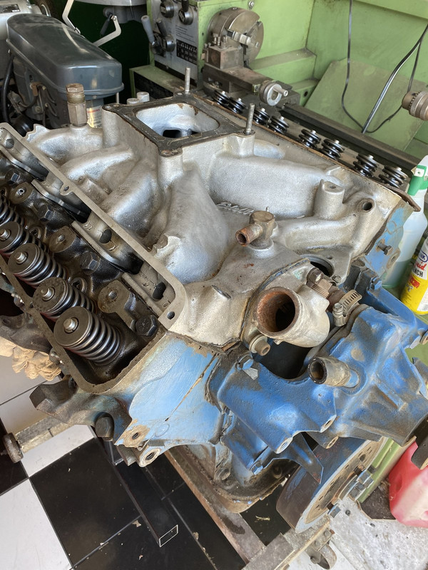

Got the new CJ home. Figured I do a thread on it as it will be an interesting project.
First the numbers. It is a 9C5 date coded block. C scratch on the rear. Partial vin stamp is 9H572337.
The heads are much later in the year one is a J, one is a K. The J head has a broken exhaust ear and a crack in the valve cover rail. Greg the gent I got it from has a replacement head for it. It comes with a Streetmaster manifold installed. I have been offered a CJ manifold and am undecided on if I’ll use it. It also came with adjustable rocker arms with hydraulic lifters. There are no exterior weights on the flywheel or damper. The paperwork that came with it shows balancing. It does not say internal and I haven’t gotten to the crank yet to check.
I’m waiting until I get a little farther into it before I decide what to do with it. But my initial thought is to put it in my Fairlane as I will be moving next year and it would be nice to have the Fairlane mobile.
Here’s some pics. Check out the China rail sealing.
BTW I understand about welding iron but wonder if there is still anybody out there that can fix it. Shame to lose an N head.

I would have to go look at the CJ in the 66 but that hole might not be used depending what side you put it on...I would be more concerned with the condition of the valve seats..In my experience unleaded fuel and FE heads don't mix...They are tricky to put seats in as there is not much material left if they blindly get machined out...
If HP is a goal I would leave the intake alone otherwise grab the stock one,vintage F-427 or a Perf RPM.....JMO..

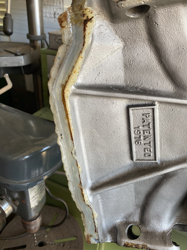

I have a guy here that can fix that head.
Shame on whomever used the silicone like that.   And extra shame on whomever put the restrictor in, then put a helicoil in on top of it....LOL
I bet that engine would be a fairly strong runner as it sits, especially if it has an aftermarket cam in it.

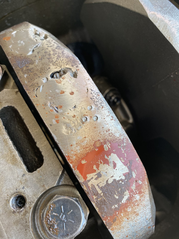

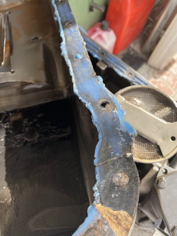

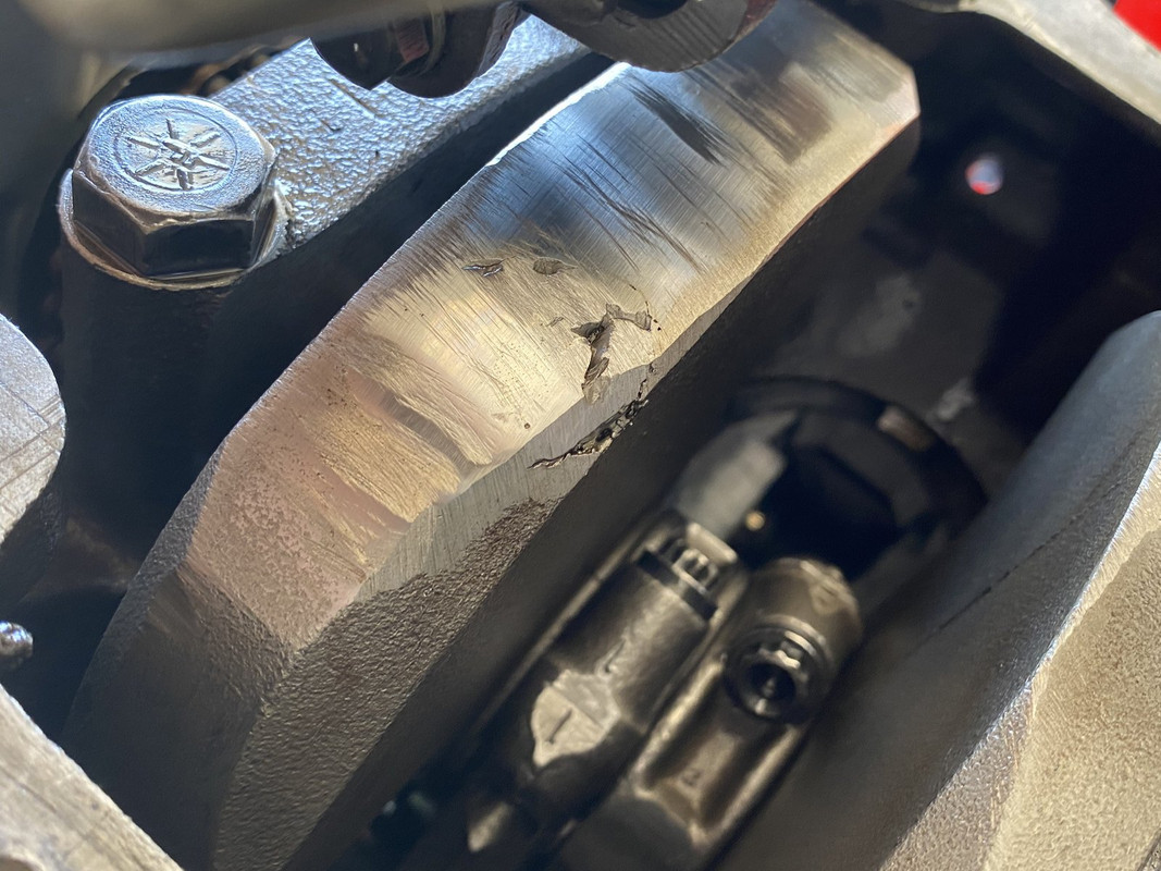

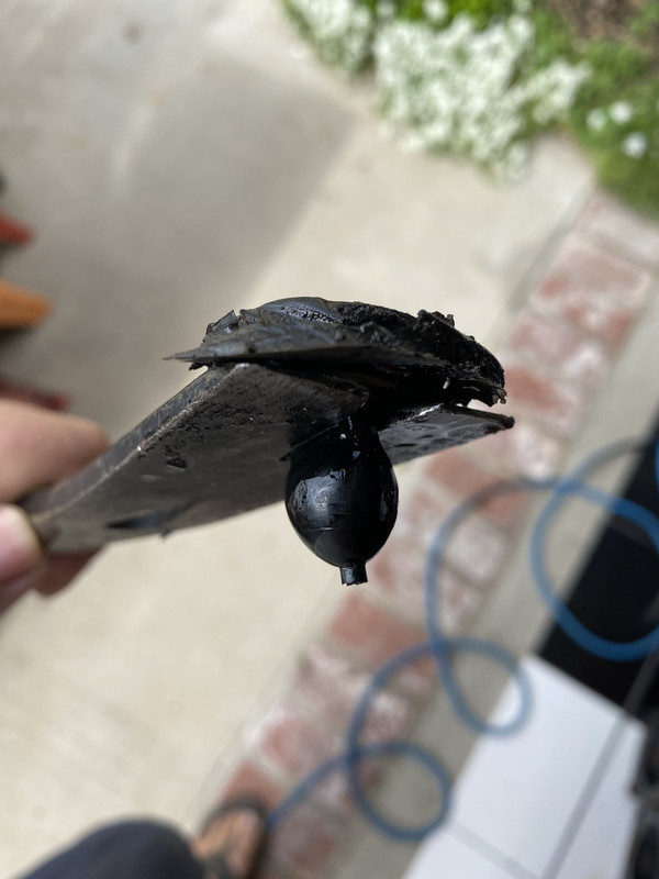

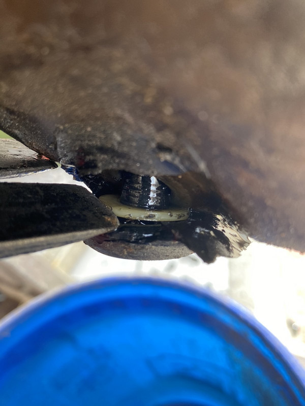

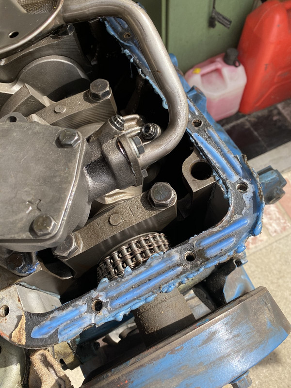

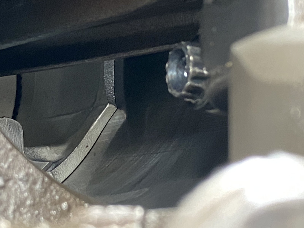

Took the heads off today and was met with a few problems. Suffice to say the bottom end has to come apart. The pics will tell the story.
Pic 1 The head gaskets. One side is great the other....hmm. The good side head popped right off. The bad side head was cemented on.
Pic 2 Houston we have a problem
Pic 3 These ladies are missing their skirts. 3 of them.
Pic 4, 5, 6 There’s actually a bolt in there.
Pic 7, 8 More gorilla snot
Pic 9 Crank
Pic 10 you know

« Reply #5 on: July 24, 2020, 02:36:42 PM »
Marc -  There's no hatchet on the damper, right?  Hmm.  I'd be looking for mallory metal on the counterweights of that nice SCJ crank.  Hopefully the journals are OK.
I've seen lots of 1968-70 cast Ford pistons with porous/ broken skirts.  (A broken skirt tab punched a hole in my old '68 Shelby GT 350's original 302  >:()  Boss 302 guys know this phenomenon well!
Yeah that engine was rebuilt by Mongo!  Mongo also had a very runny nose.  That stuff doesn't belong anywhere near an engine... I think you'll end up with something really sweet though, as long as the bores check OK and the crank isn't boogered (see what I said there  ;D).

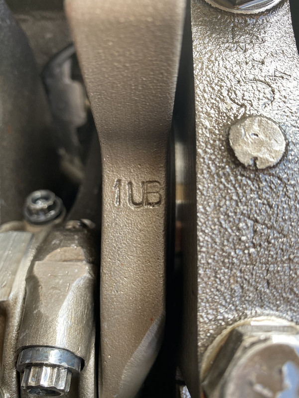

« Reply #8 on: July 24, 2020, 03:34:39 PM »
Those look like LeMans rods, but that is not an SCJ crank.  An SCJ crank will usually be marked 1UA, not 1UB.  You can also tell by looking at the center journal, see the 428 cobra jet web site.
Looks like whoever did that engine was thinking along the same lines as me back when I did my first 428CJ in 1980.  I hunted around until I found some LeMans rods, and replaced the stock CJ rods with those.  Added the balance weight required to the crank, no hatchet crank spacer.  Worked fine with no problems.

« Reply #9 on: July 24, 2020, 03:55:59 PM »
Sorry for the issues Marc. +1 1UB is a CJ crank but the balancer looks larger like the SCJ. Look and see if it the normal or the C8AE-C SCJ balancer.

« Reply #11 on: July 24, 2020, 05:25:34 PM »
Jay's right - I forgot about the 1UB representing the second generation "Standard CJ" crank.
