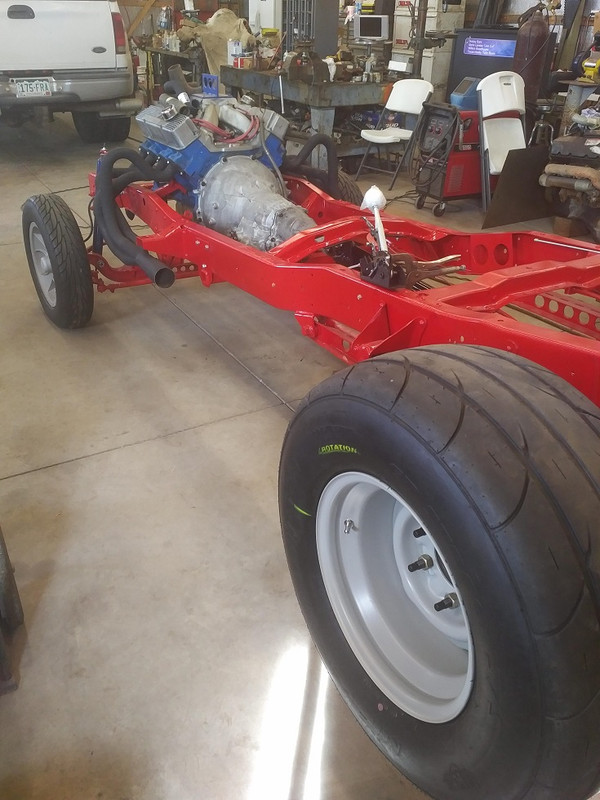

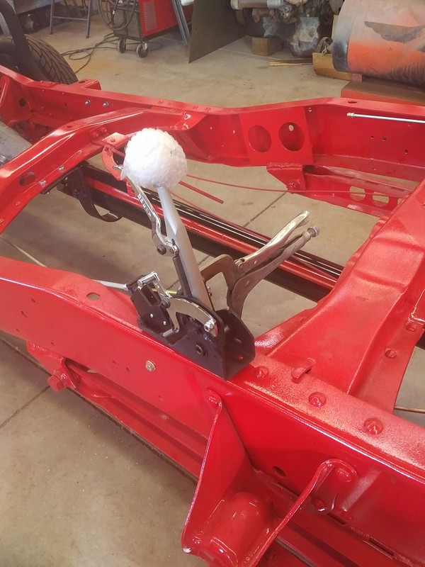

More progress! We carefully measured and checked everything when we married the trans to the engine. With everything being aftermarket (block, crank, adaptor hub, flexplate and torque converter) we were surprised that it all bolted together and was actually right.
One of the things we wanted to verify before dropping the body back on was the shifter. We chose the Hurst Quarter Stick for the reverse pattern valve body. Click for click we worked from park to 3rd gear. Each shift was dead nuts on. We must be living right.

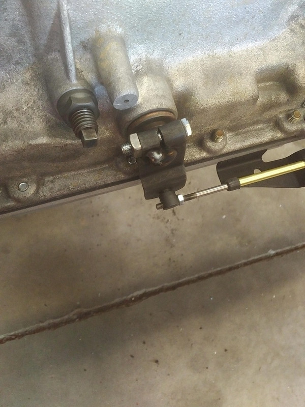

 One of the things we didn't like was the cheesy arm that came in the shifter kit for the C6. It did not want to grab the shaft very positively. Once we got happy about the location of the arm on the shaft, I tack welded it. Done deal.

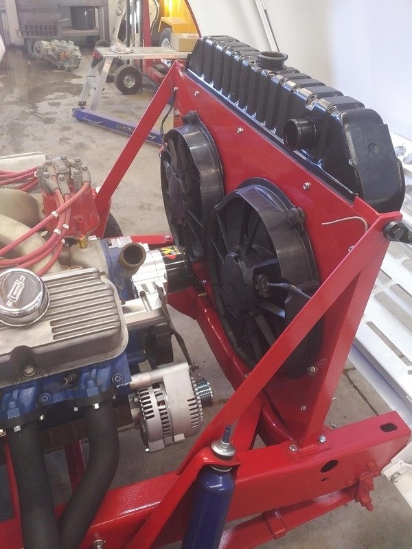

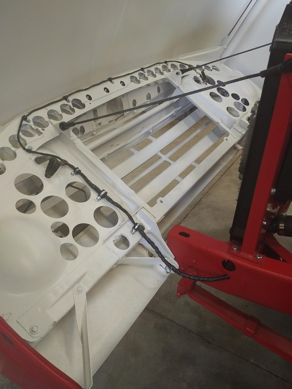

Thanks for all the kind words guys. Will pass em along to dad. We are starting to see some light at the end of the tunnel so to speak.

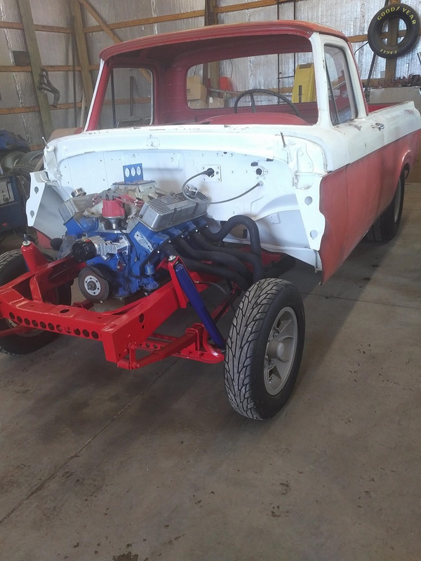

I finally got some time off from work. While I was away, dad has been busy. He put the front clip back on along with the radiator and built a cool little shroud with a couple of cooling fans. The fans came from a mid 90's Taurus. Hopefully they move plenty of air.

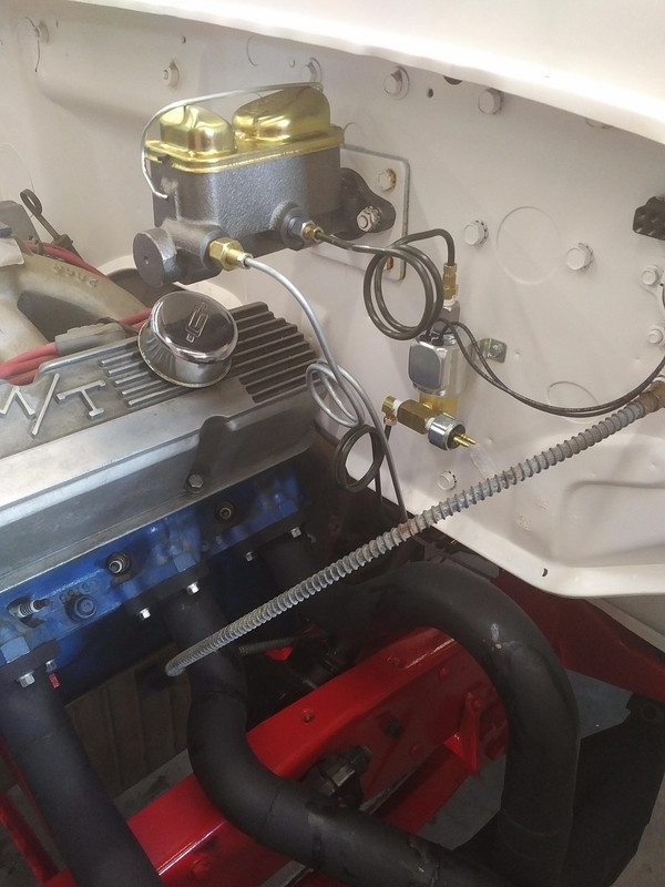

We have a working brake system now too. We finished running all new steel brake lines last weekend and vacuum bled the system. We also upgraded to a double sided master cylinder for a bit more safety. The factory emergency brake system works too. We couldn't wait to geek out with the line lock valve so we wired it temporarily to a jumper box. It works great!

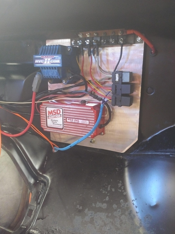

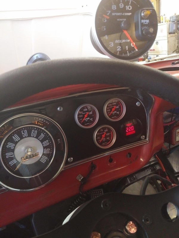

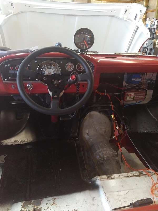

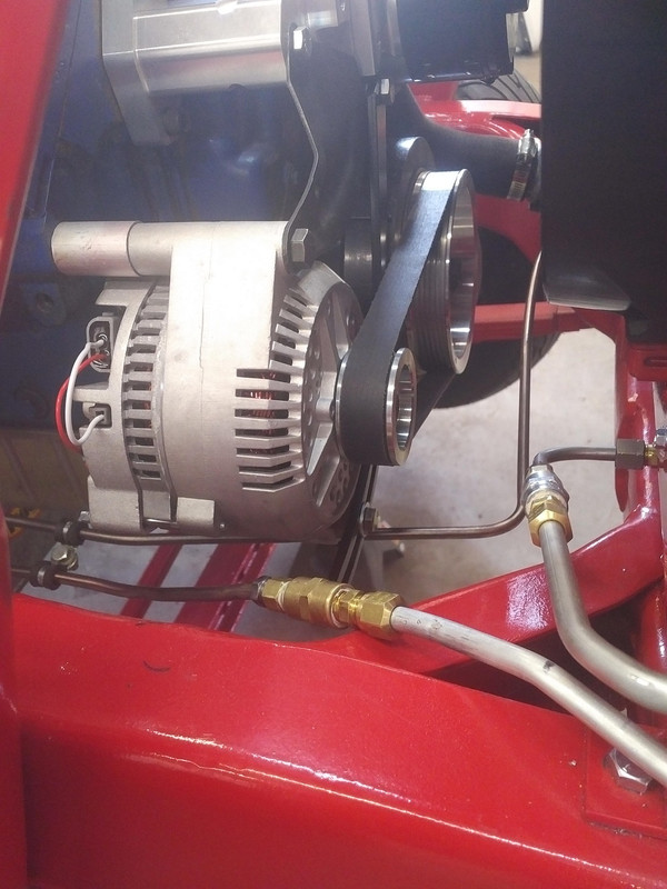

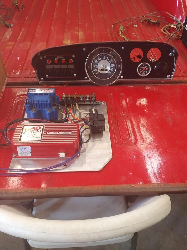

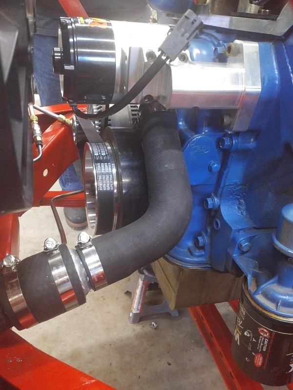

We've been busy with the electrical end of things for several weekends now. I took on the alternator myself while dad sorted out the factory wiring.
 Dad assembled a slick little panel for the ignition components with breakers and relays for fans, water pump and fuel pump. He pulled the breakers and relays out of an old Freightliner in his boneyard. Dads ability to make chicken salad out of chicken shit always surprises me.  I took some 18ga plate and made inserts for the stock instrument panel so we could mount switches and gauges.
I picked up a 3G alternator for a 95' Mustang at my local NAPA. It's a 135 amp large frame variety. To convert it to a true one wire alternator I found a conversion voltage regulator on eBay. I also clocked the output post around to a more suitable location. Easy peasy. The crank pulley is a March 7611. It's for a BB Chevrolet so it took some whittling. The lower arm is a Summit G4049B universal alternator arm. I had to cut a few inches off and drill a new hole in it. The belt is a Dayco 5060295 6 rib belt. Credit to Jay for passing along these part numbers to me. It turned out to be a pretty slick alternator assembly.
www.ebay.com/itm/New-Conversion-Voltage-Regulator-Makes-Your-FORD-3G-Alternator-One-1-Wire-Hookup/132286529580?hash=item1ecce4402c:g:mqoAAOSwTHRbex9w:sc:USPSFirstClass!81523!US!-1
The starter kinda screwed us around though. When this FE was in my Highboy, I used a stock type starter with a truck bellhousing and had to grind just a bit on the back screw in freeze plug. Now with a C6, the starter location is way closer to the block. Not even close to working. So we have a CVR starter coming with a smaller, clockable motor. We suspect the Genesis block has some extra beef on it causing our issue. Edit: Just remembered.....The starter mounting holes in the C6 bellhousing and the clearance holes in the shield plate were an issue also. Tolerances are getting stacked somehow. Along with the burly wall on the block. It's quite a bit thicker than a FoMoCo block.
With the electrical end of this project close to completion, we're on to the the fuel system now.
