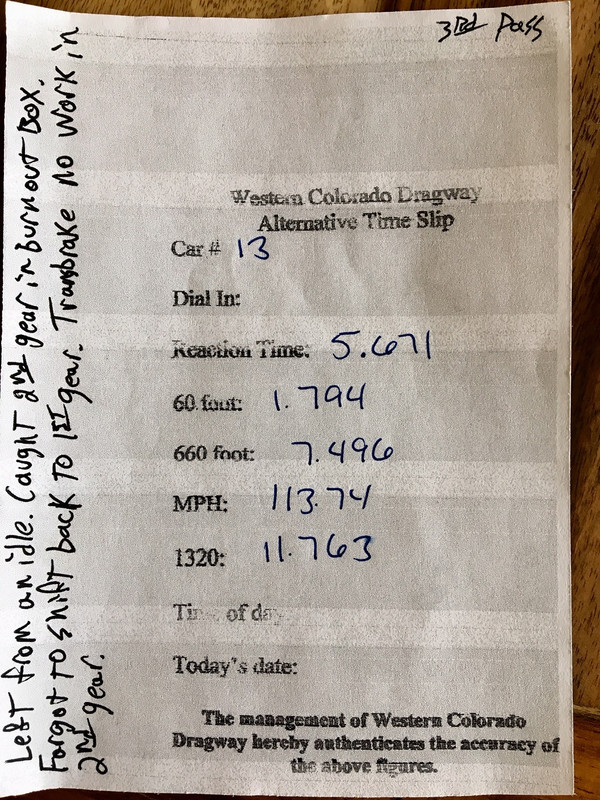

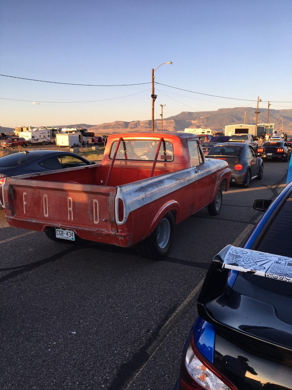

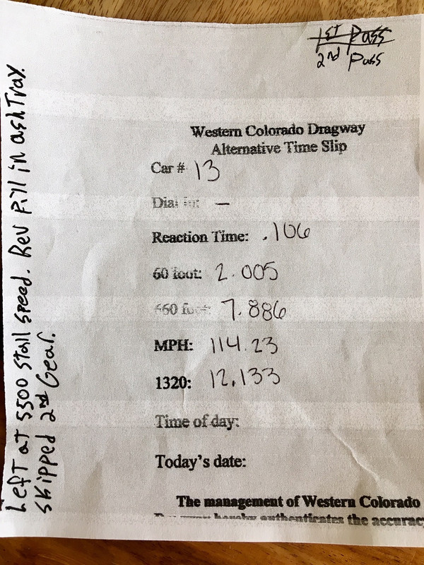

Happy 4/27 guys! We celebrated by taking our F100 out to our local drag strip. We made it through tech inspection ok. He did note we have to get a trans blanket before we come back next time. I didn't get any video but I did get a few time slips. I made some notes on each time slip about the pass. It really seems like I'm having to learn to drive all over again in this truck. I think I made just about every dumb mistake that a drag racer can make. We didn't have time to ride around the neighborhood so I made 2 shakedown passes to make sure the thing drives right. It goes straight as an arrow. No vibrations. Doesn't pull when I slam on the brakes. The king pin caster angle must be good too. I noticed when driving through the pits that the steering wheel quickly re-centers itself after a turn. The C6 worked great also. The oil heats up to about 180 after a pass.
The only negative I can think of was all the left over blasting sand in the cowl. It was hot sitting in the staging lanes so I opened the vents thinking it would cool down during my first shake down pass. At about 90 MPH the interior of the truck became a blasting cabinet. Which filled every orifice of my sweaty body with sand. Not cool.
Going forward we see several things that need addressed:
4:57 rear gears are too much. Something in the mid to low 5's would be better. Edit: We have a 5:13 set but they're not pro gears. Currently exploring options here.
We learned what a 2 step box does. So now I'm looking for one that will work with an old analog 6AL box. This will make launching more consistent. And improve 60' times hopefully.

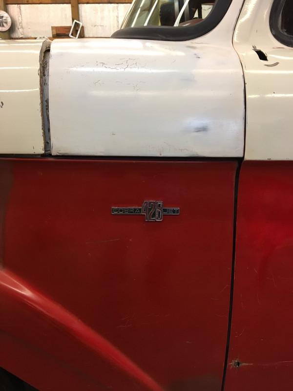

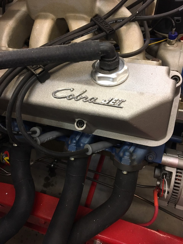

And last but not least, we buffed out the 57 year old paint. Heck.... just knocking off all the oxidation should be worth a tenth.   ;D  We also mounted a couple of old "Cobrajet" emblems on the valve covers. They came from a '69 CJ Torino that dad raced back in '75.

That thing looks great.
Love the 428 badge.
KMcCullah
  • Posts: 734
Re: 1962 F100 drag truck
« Reply #81 on: June 23, 2019, 09:09:03 PM »
Thanks Marc. Those badges have been in my tool box for 30+ years.
