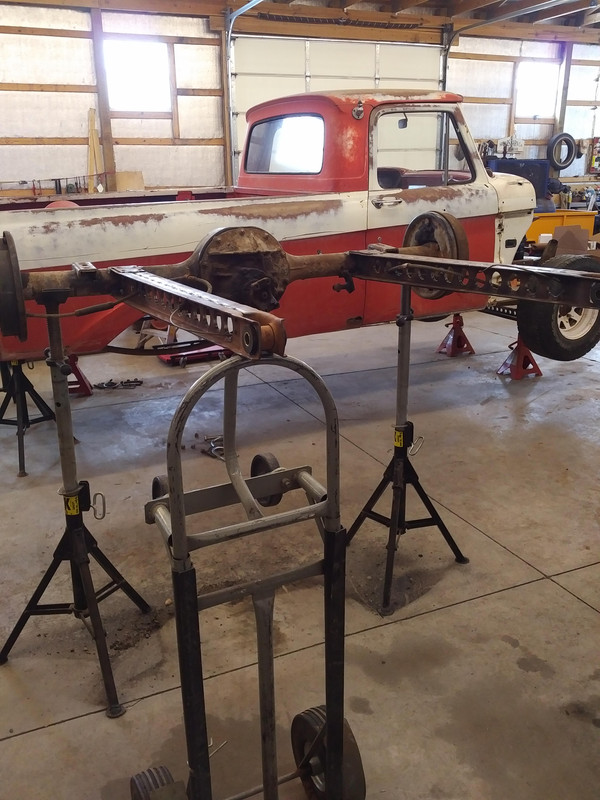

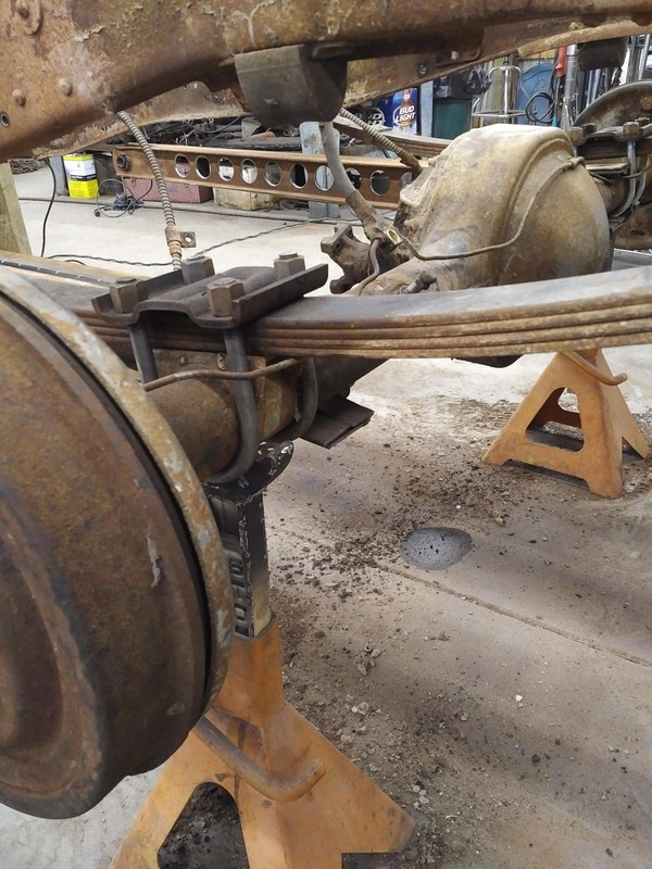

« Reply #26 on: February 10, 2018, 08:39:09 PM »

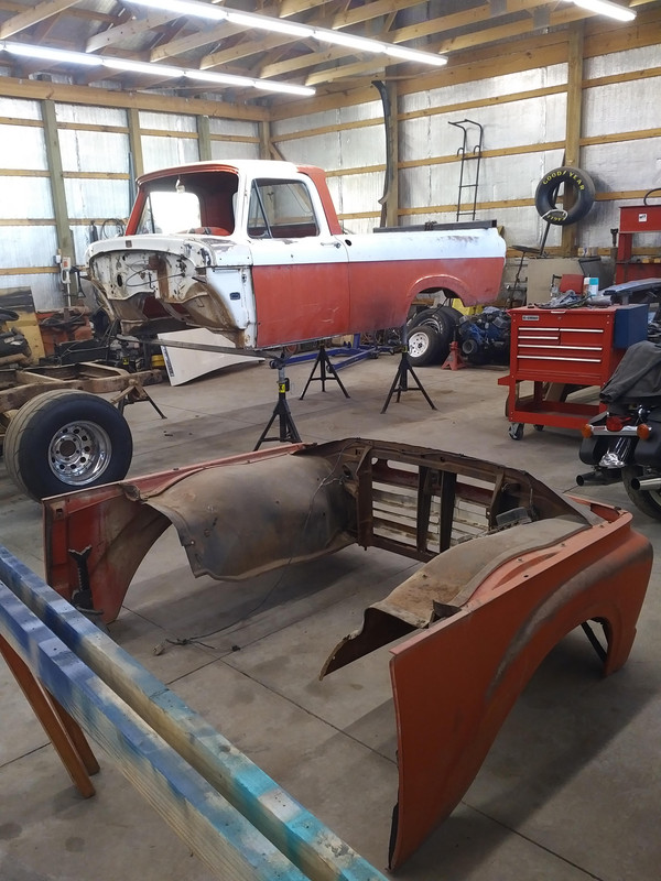

We've made some progress lately. The body was lifted off the frame so we could work on setting up the chassis for haulin ass instead of hay. The plan is to get as much fab work completed as possible and then sand blast and paint the rolling chassis. Over the last few weeks dad has implemented some of his 60's hotrod trickery. He has built ladder bars from some mid 60's Chevy truck rear end locator H beams. Hell I don't know the technical term for them. But those trucks had coil springs in the rear so those beams had to be pretty stiff. These particular beams were off of a 3/4 ton so it had some extra plates riveted to the axle mounting spot. Dad ended up cutting those off. The plan is to leave them unattached until ride height and pinion angle is established. And then weld the end of the H beams to the axle housing. The rear axle housing by the way is an early style big bearing housing. The backing plates have 1/2 inch bolts. The tubes are 1/4 wall. Dad's had Mark Williams himself on the horn recently for some axle dimension clarifications. Along with axles dad also ordered a bunch of other goodies. 1350 yokes, spool etc. It should be a fairly stout rear end. Will post a pic when it's done. He also rebuilt the spring packs and left all the overload/helper springs out. 4 total removed. Its a nice limber pack now. We plan to go completely thru the drum brakes and use them until we can upgrade to disks. The drums and shoes looked nearly new. Maybe a .010 step in the drums.

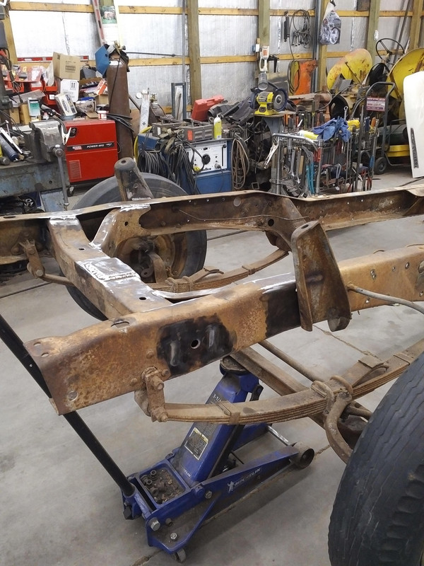

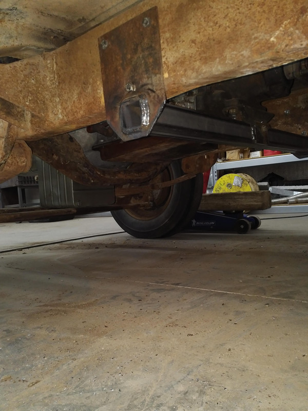

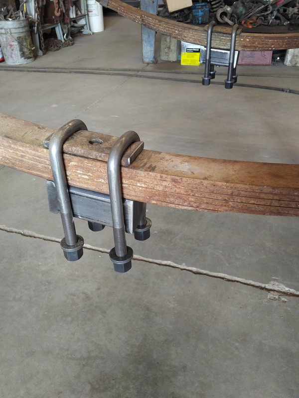

« Reply #27 on: February 10, 2018, 10:02:27 PM »

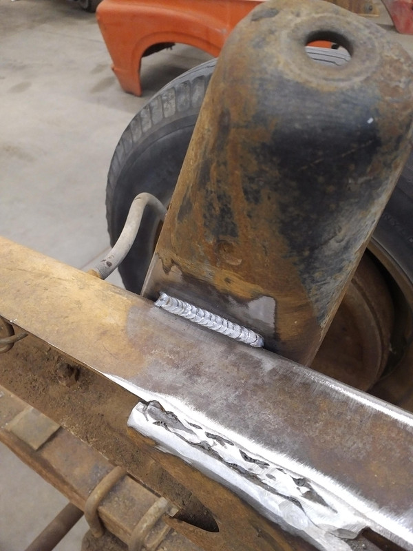

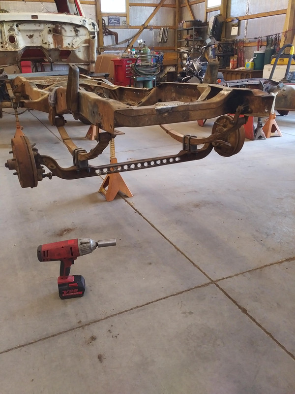

 We have changed a few things on the front end too. Since we won't be articulating thru hay fields  with this rig, I started out with shortening up the shock towers about 4". Getting the rivets out was a bitch! I plug welded thru the rivet holes when I welded the towers back on. I also cleaned up the ends of the front cross member. The center of the cross member was hacked up when the straight 6 was adapted to the frame. I patched the holes up and smoothed everything over. I rewelded some of the more sketchy looking factory welds too. Dad made some 2" riser blocks and had some new U bolts made. He also rebuilt the spring packs and put new bushings in. We talked ourselves out of relocating the shackles since we're keeping the stock steering sector and drag link. We punched 13 holes in the axle webbing also. That damned web is 1/2" thick! Oh...and the H beam ladder bars have 13 holes too. Yep we're badasses.   8) Or at least dad is. ;D

« Reply #28 on: March 15, 2018, 09:25:29 PM »
Progress has been creeping along. We've had the rear end in-and-out several times. The way we did the H-beams was not at all forgiving so it did take some time to get it right. Dad fabbed the truss out of a 2X4 rectangle tube. It should stiffen up the early truck axle housing pretty well.

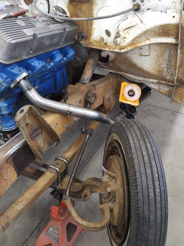

Last weekend we started on a set of headers. These are going to be equal length, stepped headers. 1 7/8" 2" 2 1/8" Just regular steel. We don't have the budget for stainless. The exhaust side of our Pro-Port heads have Jeff Colverts' exhaust port. So they look a little different than the usual FE head. Blair just happened to have a set of header flanges hanging around for the Colvert exhaust ports so we scooped em' up. He also sent us a sweet pair of merge collectors for the project. They're set up for pan evacs already. (Which reminds me, Jay. I need to change the valve cover configuration that I originally spec'd. Will email you soon.)

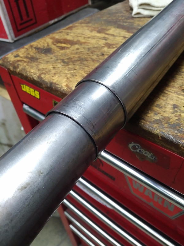

  Check out the milled register in the header flanges. It took us a minute to figure out a method to fit the 1 7/8 tubes to the flanges. Another round peg in a square hole scenario. Normal for us. We heated the tube to a dull red and squeezed it in the vise. And then with the tube still in the vise, squeezed it square with a C clamp. 16ga tubing was the better choice for fitting into the flanges but the majority of the straight tubing will be 18ga. Mandrel bends I found on ePay. They're 16ga. I found non-aluminized 10' sticks of 18ga tubing at our local NAPA. Bare steel is by far the better choice to tig than aluminized. The tubes all slide together also. This feature will be a big time saver over the course of the project.
