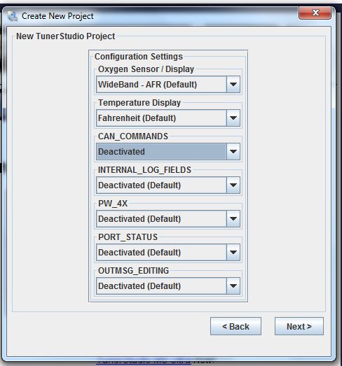

Next is a screen to set up some of the key functions in the software.  The first two items are probably the one ones you need to
worry about, using a Wideband oxygen sensor, and Fahrenheit for the temperature scale.  You can deactivate all the other
functions, as shown in the screen below.  When finished, click Next.

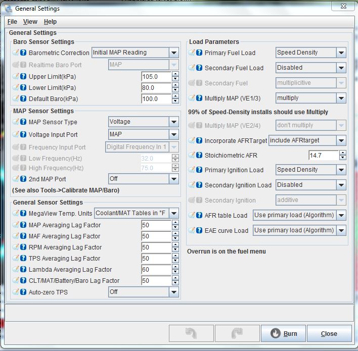

Next lets open General Settings under the Basic/Load settings tab.  Here we are going to set up the MAP sensor.  Just change the
values in the menu to match those in the picture below:
