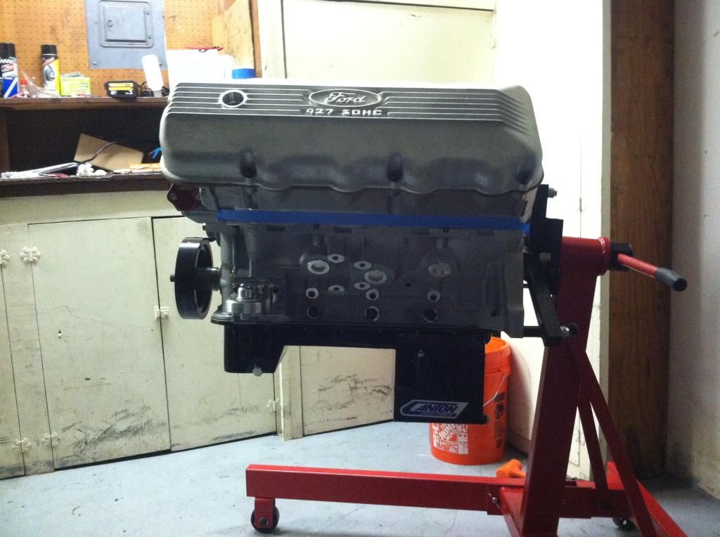

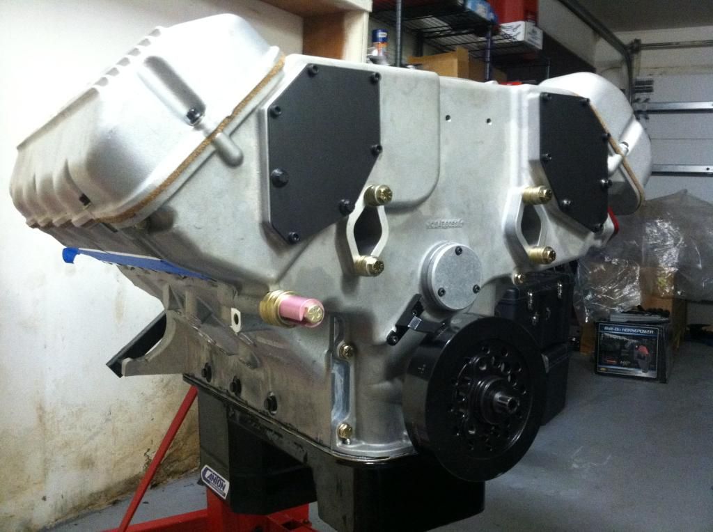

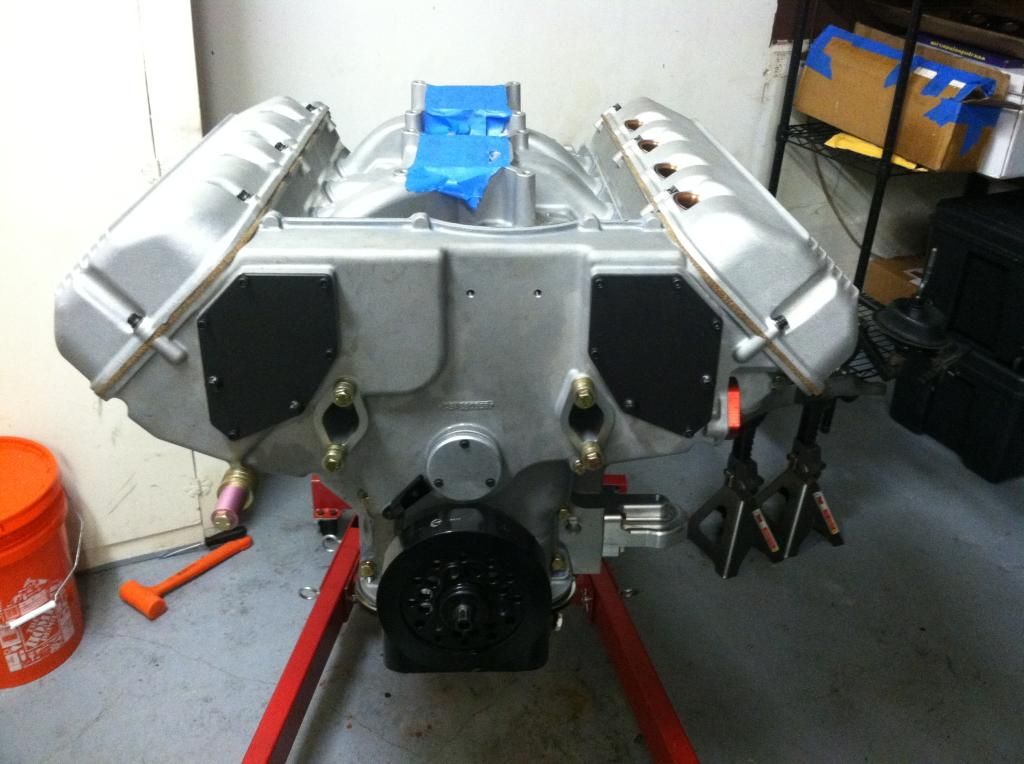

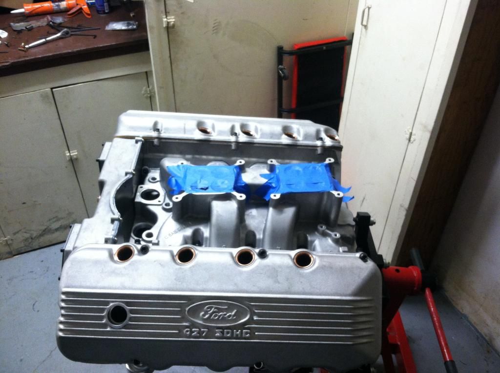

« Reply #279 on: September 29, 2014, 08:09:16 PM »
Took some pictures tonight when I got home

OK small updates.  I went to Jegs and purchased 2 oil filters.  I purchased a K & N filter just for the break in Oil/ Period.  Then I purchased a Moroso Race filter after the break in is complete.
I was able to seal up the water pump gaskets to the pump and then seal the pump to the block. Before I installed, I installed plugs into the 2 areas where I believe fittings go for the heater core.  Being in South Florida, no need for heat so plugged with thread sealant.  Then on to attaching the water pump. Just to be safe, I put thread sealer on both the top and bottom bolt threads on the passenger side bolts.  I believe one or both of them goes into the water jacket, but just to be safe I put sealer on both.  The drivers side bolts did not get any sealer.  All 4 bolts were torqued to 25 ft lbs.
I pulled out the large water neck from its storage box.  Wasn't too pretty at all since it looks to be just raw steel pre welded.  I cleaned it off with brake cleaner to remove any debris or oil residue, and wiped it down.  Then I sprayed it with a VHT grey paint (good up to 550 degrees).  I let it dry over night and plan to seal it up with a gasket (and some TA-31) tonight using some extra stainless steel studs and self locking flange nuts I had from the oil pan install. (mistakenly had two packs of the oil pan studs, so had an extra pack after the install).  Should work and look great.
What I am curious about is this:  There are plently of tutorials out there on how to replace a distributor on a car that had a distributor already, but how to you install a brand new distributor on a brand new motor.  My guess would be to start by getting the engine to TDC on the compression stroke for cylinder 1 and installing the distributor so that the rotor is touching the #1 wire.  This would make the spark ignite at TDC and then you can time it to fire some degree before TDC when it gets running...... but that's just my guess.  Does anyone have any tips?  Distributor wont be back from MSD for a few weeks, but I would like to start planning my "Attack"
