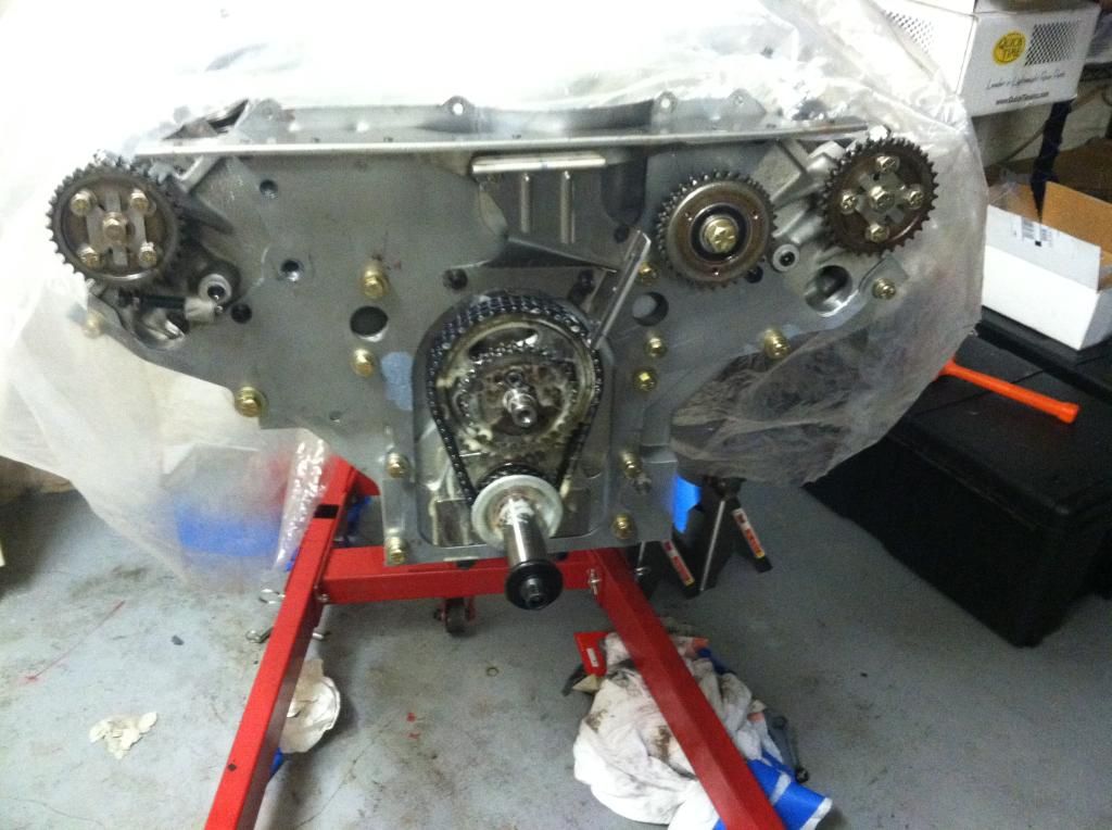

« Reply #243 on: September 08, 2014, 08:32:52 AM »
Well,  yet another hiccup.  After I got everything buttoned up (as Pictured above), and the cylinder walls have all been machined so the intake valves no longer hit them, now I have PVC issues  LOL.  The first valve lashed (intake) was the #1 cylinder.   This time I now have piston contact when the rocker arm is lashed to 0.023.  If I back the rocker off some (which is outside the range of normal for the engine), then I don't get the contact.  However in taking with Jay, I believe I am just going to re-check the timing.  To me, it would seem that I am 1 dowel hole off from not having interference, however I will just retime it to be sure.
I am going to slide all of the rockers off except for Cylinder 1 and cylinder 6....  this time I am just going to leave the regular springs on there (as they are not that hard to rotate) to check (and with the rockers backed off, the piston doesn't touch the valve).  Luckily if I need to make any modification to the cam timing, it can be done without screwing up any of the assembly I have done so far.  Each time I get this close, I get stopped!  I cannot wait for the day where I can lash all 16 rockers and install the valve covers!  Then it will feel like progress.
As a positive, at least I was going super slow and did not bend anything.  As soon as I hit the hard stop.... I stopped for the night!

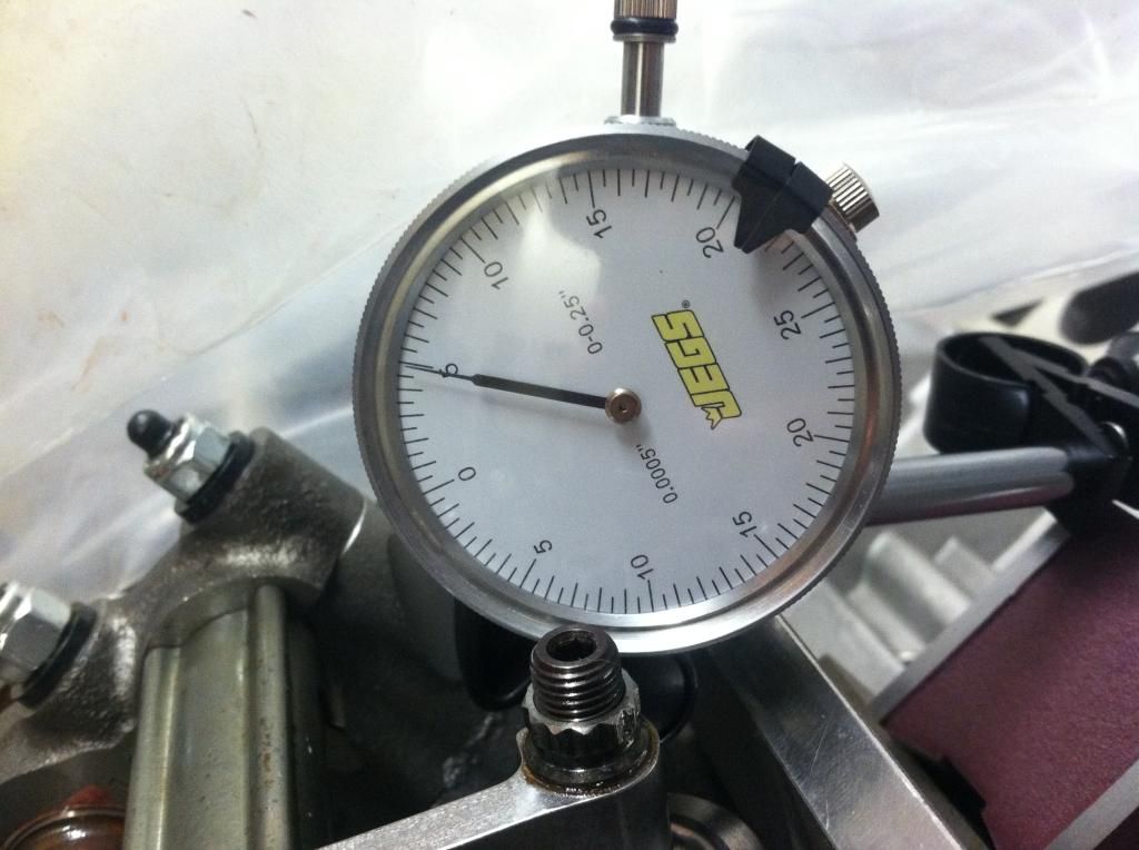

OK all, time to share my newest issues/problem... when do they end?  Now that I have fixed the valve to cylinder side wall issue, I found that I had PVC issues.  In talking with Jay, it seemed best to start back from scratch on the timing.  Since the front cover does not need to come off again to set the timing, I decided there's no time like the present.
Last night I got the rockers all out of my way and installed the check spring and rocker (backed all the way off) on Cylinder 1-Intake.  I pulled the cam retainer plates off as well as the bolts that hold them on and loosened the center cam bolt.  After pulling the dowel out and re-aligning the cam sprocket  to be "straight up", I went about checking to ensure that the factory centerline advertised as 108* was true.  With the dowel in the correct location, the chains verified that they are in the correct location and the gears all verified, I put the Piston stop down the spark plug hole on cylinder 1.  After a few minutes I had TDC.... and just to be 100% sure,  I went back and forth 2 more times to ensure I landed on the same number (Somewhere around 33 degrees) before and after TDC.  So from this point, I know everything is in order and TDC is now indicated by my temporary pointer.
Before I went any further, I unscrewed the piston stop and stored it away.  Since its an aluminum block, I have a plate of steel I temporarily bolt to an intake bolt hole and set up my magnetic base with dial indicator.  I placed the pin of the dial indicator on the spring retainer next to the rocker arm, and push it down so that I don't run out of "reach" as the valve is pushed down.  Turning the crank in a clockwise rotation (normal direction), I waited until the needle on the dial reached a stall point before heading in the opposite direction as the spring decompresses.  At this stall point (Max valve lift), I zeroed out the dial indicator.  Now turning the crankshaft in a counterclockwise rotation until I was at .015 (or 15 on my Jegs dial indicator).  From this point, I turned the crank again in the clockwise rotation until I reached 5 on my dial indicator (which is 0.005).  the reading on the degree wheel was 30 degrees ATDC.  Now that I marked down that value, I continued to turn the crank in the clockwise rotation until the needle hit "0" and started back around the dial.  When I was at 0.005 again (5 on my dial indicator), the degree wheel was at 52 degrees ATDC.  Since the degrees were already in ATDC, I added them together and divided by 2 to get a centerline of 41 degrees.....  ONE HELL OF A FAR CRY FROM 108* on the cam card.
So what I am gathering is that the piston hits TDC.... then on its way back down at about 41 crank degrees, the valve is open at its max.  The way the cam card reads is that the intake valve should be opened to it max at 108* after TDC.
Below is a picture of the degree wheel I am using.  Right to the right of the TDC yellow arrow is degrees marked with a black line (as opposed to in yellow when its to the left of the TDC arrow).  I got 30 degrees after TDC and 52 degrees after TDC.
Jay had pointed out that my dial indicator is in 0.0005 increments so rather than timing the engine at 0.05 Lift, I was timing the engine at 0.005 lift, but I should still come to roughly the same centerline doing it the way I was with my dial indicator.  At this point, I am open to any and all ideas.  I know for seasoned engine builders, the timing probably doesn't pose this much of an issue, but as much as this is becoming a HUGE pain in my ass, I still have a lot of fun learning new things and building this engine  :-)

« Reply #247 on: September 10, 2014, 12:08:27 PM »
Of note, I did just realize going through my pictures on Photobucket that I am using a different Dial indicator this time.  I am using the dial indicator I used to measure the main bearing oil clearances and when I timed the engine the 1st time, I was using the dial indicator that came with the degree wheel/timing set.....  I am going to switch out the dial indicators when I get home to see if there is any difference.  The one that came with the degree wheel is a lot more detailed (where as the simplistic one I am using now is very basic).  Just a thought/ shot in the dark

« Reply #248 on: September 11, 2014, 03:53:03 PM »
OK been staring at the picture of my degree wheel in a trance.  I figure this. (and this is more so I understand.... not so much the traditional way its probably handled)
I came to 30 degrees ATDC and 52 degrees ATDC at 0.0005 lift (5 on my dial indicator).  This is a 22 degree split.  So I can assume that the way I am using my dial indicator, I need to get the cams to read 2 numbers at 0.0005 lift before the needle stalls on the indicator, and also at 0.0005 on its way back down.  These numbers came to:
97 degrees ATDC and 119 degrees ATDC. at 0.0005 lift.  This gives you 97+119 = 216 / 2 = 108
So from where my cams are now...I would need to retard them a lot.  From 30 degrees ATDC to 97 degrees ATDC is 67 crank degrees.  In reading back through Jay's 519" build, moving the cam dowel 1 hole moves the cam timing 1.5 cam degrees, or 3 crank degrees.  I would need to retard the cam about 22 holes.  This sounds like a lot, but the cam dowel holes are all only "slightly" misaligned....  when you move the dowel 1 hole, you barely have to move the cam in relation to the sprocket to get it to move.  The problem is that after a certain number of dowel movements, the 4 small bolts that holt the retainer plated to the sprocket to the cam wont align.  You would have to turn it until the 4 bolts around the circumference align again.  luckily, the dowel holes go all the way around the cam without a break.  Hopefully by the time I move it 22 times, the 4 bolt holes will be aligned again.
In looking at a picture of the cam on the racedyne website, 22 dowel holes seem to mean that the degree markings on the cam are about 28.6 degrees in the wrong place.  When I alight the "o" on the cam with the cam sprocket @ 90 degrees off the head surface, the "0" is truly 28.6 degrees retarded from that mark.  Again, I will check probably this weekend and report back.  I have noticed that when I go into the garage tired after work and the 4 hour round trip commute, things usually go wrong.  Weekends are way more relaxing.
