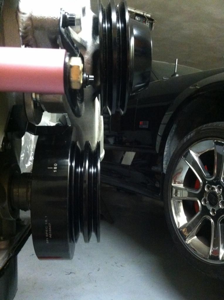

Pulleys on.... As you can see not even close!
Jason

Factory SOHCs used a special bottom pulley to make the alignment work.  They are kind of hard to come by, and they are single pulleys, not double.  What you will need is a spacer for the bottom pulley, to make it line up with the top pulley.  Use some long bolts and washers to mock things up so the pulleys are aligned, then you can measure the thickness of the spacer you need.  You'll have to find a local machine shop to make it out of aluminum for you.  Make the center hole in the spacer large enough to fit snugly over the little lip in the center of the harmonic balancer, to keep the spacer centered on the crank.
Nothing's easy, is it? ::)

I will take some measurements, but as you can see from the picture, the spacer will be the exact same size as the pulley itself.  Thanks!  On a "smaller" note, thermostat will be here today so I can button up the water neck.  Oil filters came in this weekend, but the bolts (grade 8 hex) that I used to install the Oil filter mount stick out a little too far.  I ordered the Socket head bolts that will recess into the fitting itself and end up flush.  I wanted to throw out some boxes and such this weekend so I filled the engine up with the Joe Gibbs break in oil (left 1 qt so I can fill the oil filter itself before I install) and threw out all of the empty bottles.  Its an odd feeling that the shelves are almost empty of parts..... Since I have had these parts for years now.

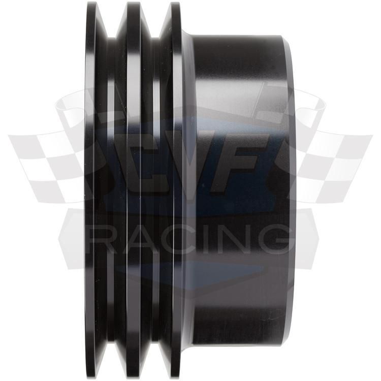

This is a small block (Ford 302) crank pulley.  From the measurements from the website, it seems to be exactly what I need width wise.  Only issue is the 3 hole spacing on this one does not exactly match the Ford FE pulley (by a very very small amount).  Curious if I would not be able to clock this pulley and drill 3 new holes using the FE pulley as a template.  This would make life easier.
Jason

In other news, I measured last night for the crank pulley (just to be sure) and it seems like its going to be spot on as far as distance.  In searching Google images, there were one or two pictures of Cammer engines that look like they are also using the small block ford pulley (from what it looks like).  I say that because it does not look as if there is a spacer, but rather a deep dish pulley (unless they had a custom made pulley).  I digress!  The pulley is on its way and it should line up nicely.
Jason
