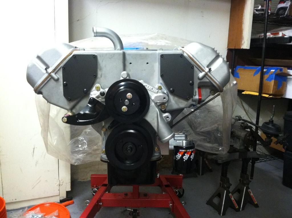

OK Alternator and Pulley arrive tonight.  I will hopefully get those sorted this weekend.  Here is another picture of the engine with the water pump, Oil filter, water neck (with the #@!*@ thermostat installed.  I temporarily bolted the water pump pulley with some washers and bolts just so I could get an accurate measurement to the Dampner face for when I was ordering the crank pulley .
Jason

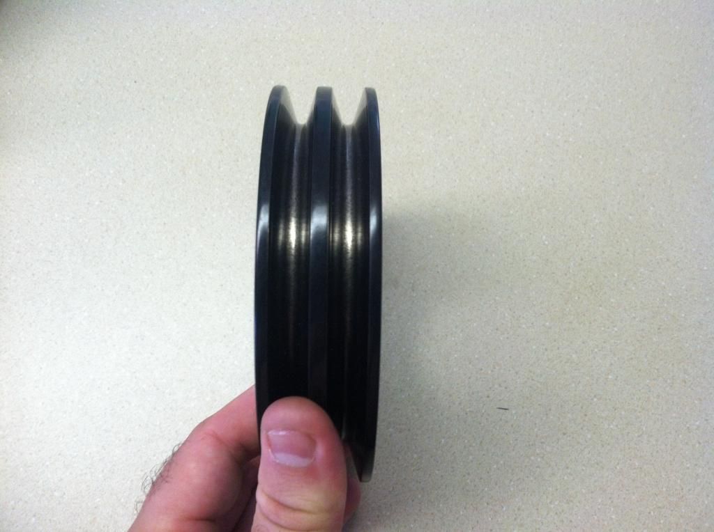

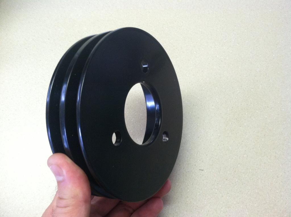

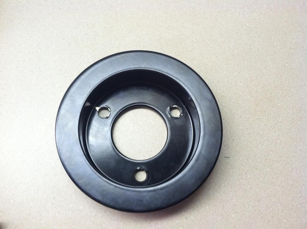

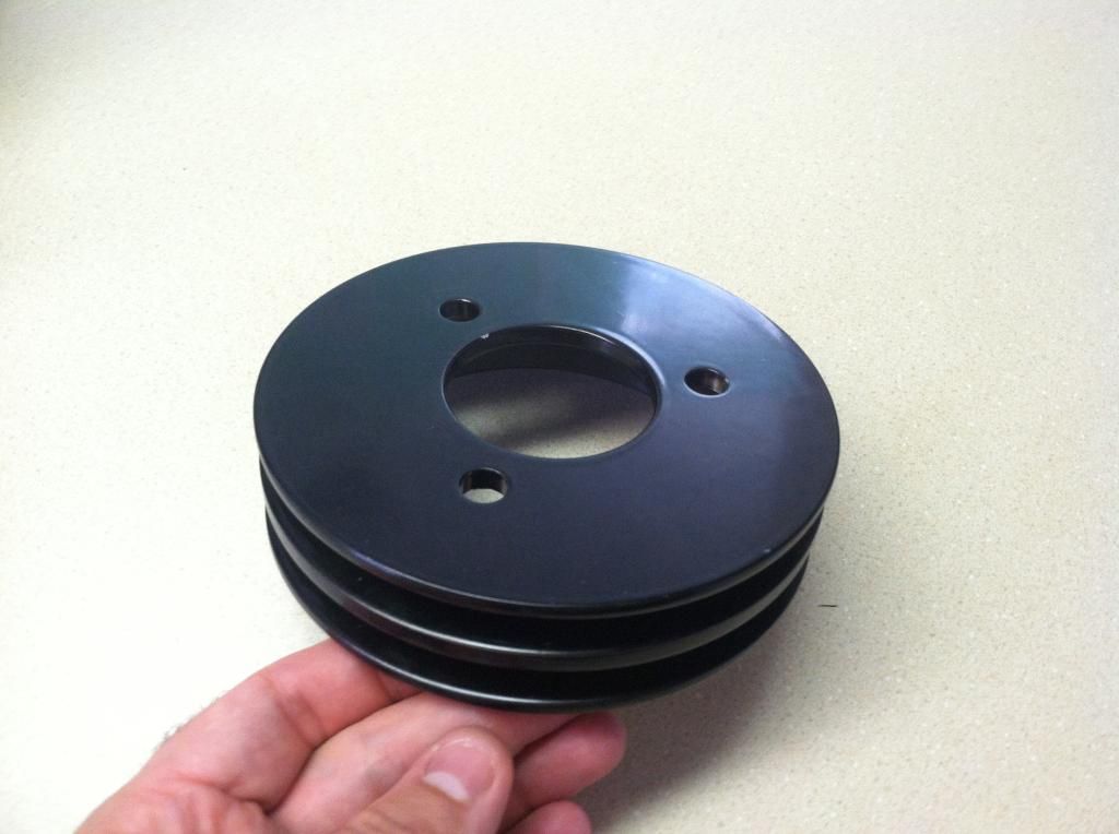

LoL. I bet!  Ok so alternator is on.  Large case and 200 AMPs, i needed to trim the bracket a tiny bit, but other than that, perfect!
Unfortunately, the small block crank pulley that came today is off like 0.5 inch. Sucks!  I could use spacers on the water pump pulley, but the the alternator will be out of line. Looks like i will need a spacer for the crank pulley after all. 2 steps forward and 1 step back
Jason

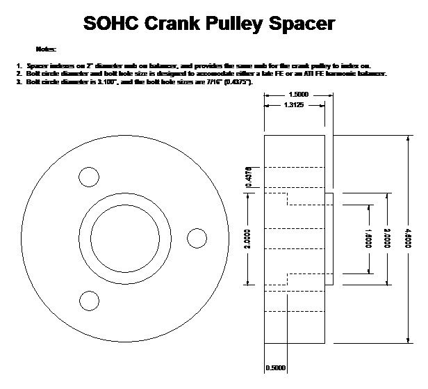

« Reply #313 on: October 13, 2014, 09:51:20 AM »
Hey Jay.  I cant really make out some of the measurements.  the "0's" and "6's" possibly look the same (Or maybe they are 5's  LOL).  I wanted to use this to double check my measurements.  I don't have the measurements I sent you with me, but from what I can remember, they look close?  If that's the case, I will most likely go with your measurements!

« Reply #314 on: October 16, 2014, 02:48:32 PM »
OK, Sent out my Crank Pulley to Jay for a custom Machined Spacer so I can finally slap the belts on this puppy and get her installed.  I also checked in on MSD for the gear swap on the distributor...  They received it on the 9th and I should expect it back about 3 weeks later.... so that's also pending.  The March Pulleys look so nice on this engine, that I decided to pick up a March Water pump Pulley cover. (March is located just a little drive away from me).  Since this car will retain its electric fans, there will be no fan/clutch on the front.  My pulley kit came with the cover for the alternator Pulley, but the water pump cover was separate.  It came yesterday and fits perfectly!

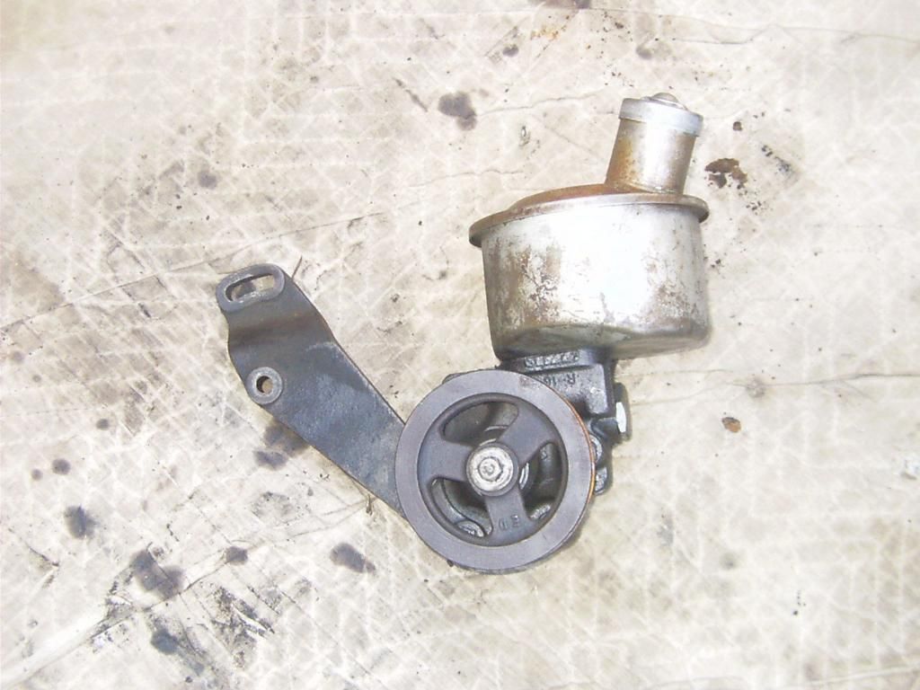

Also, I have been going back and forth with this.  I got the Power steering pump and bracket (newly rebuilt).  I was told by the tech I purchased it from that it produces 1,000 PSI.  I have called all over to find out what PSI the power steering pump on the 2005 Saleen produces with no luck.  I then tried to find out what was the optimal PSI the 2005 Saleen (Mustang GT) rack operates under.... Also no luck.  I called every since Auto parts store (including Napa who usually always has the answer).... Nothing.  Then I contacted 3 or 4 different Mustang specialty shops what rebuild power steering pumps for the 2005 Mustang GT....  even though their advertisements say they test the pressure, etc, they didn't know what that pressure was!  How do you check the pressure on these remanufactured units but not know what the pressure is/ should be?>  HAHAHA
I tried the ford dealership, I tried looking in Mustang II rack conversion PDF instructions....  Nada!  I did read somewhere that you will only run in to trouble mismatching power steering pumps if you turn the wheel all the way to one direction (Lock?) and then raise the RPM's.  The article said that the power steering rack will only use the pressure its supposed to under normal driving conditions, and the highest pressure is when the wheel is turned as far right or as far left as it will go.  Since I will still have the saleen pump set aside, I am going to try the 1963 Ford power steering setup I got and see if it works.  It would be the easiest as I have the correct brackets and Pulley.  If it doesn't work, I can always bring the car somewhere to have them fab a custom bracket to hold the Saleen Pump in its stead.
