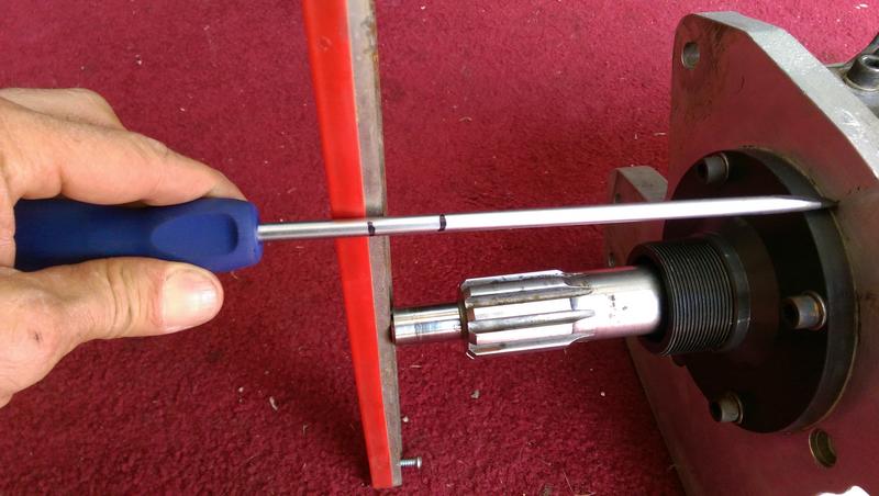

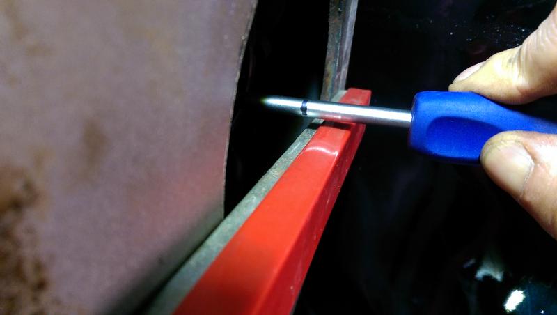

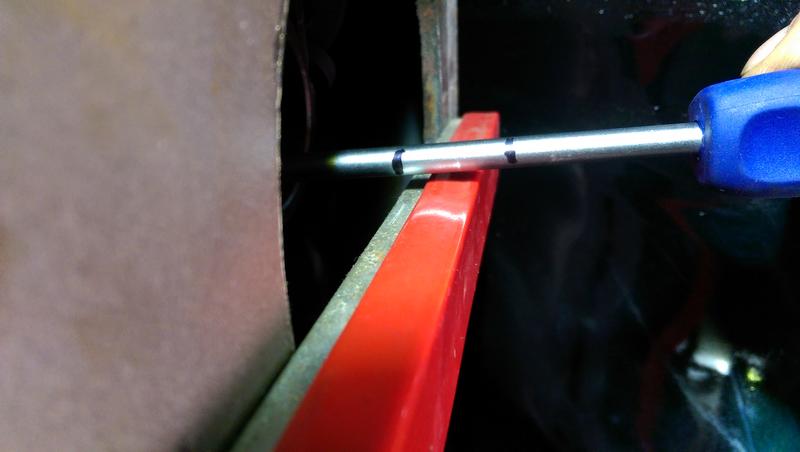

I started out with concerns that the smallblock pilot snout that was on the Jerico would cause interference in the stock steel crank on installation. That would have stopped everything. I talked to Rory though, and he told me that his trans was a long snout also, but that it didn't cause any issues with his stock crank, then I verified from the forum member I bought it from (BH107), that the trans was indeed used behind an FE. Still having concerns, I did some measuring the best way I could with everything still in the car. I didn't want to remove the bell, clutch and flywheel assembly because time was limited, and working on my back on the floor is not my favorite thing to do. A lift would have made this entire job much easier!!
I measured by using a screwdriver to find the depth from the mounting flat of the bell, to the bottom of the crank hole for the snout. I was careful to only go in as far as the top of the bevel in the crank hole, since it's a drilled hole. Going to the bottom of the hole would have given me a false clearance measurement. Here's how I measured...
Then I measured to the outside of the pilot bearing, so I knew my input shaft splines would not interfere with that area.
I knew these measurements were "rough" measurements, but it was the best I could come up with because my vernier caliper didn't go deep enough. I was hoping that they would be close enough to give me piece of mind. As it turned out, it appeared that I had plenty of room, so that concern went away. Here I'm comparing my depth marks to the input shaft on the Jerico. This shows the depth to the top of the bevel in the crank hole. Plenty of clearance! And the shaft splines showed even more clearance, so I figured I was good to go...

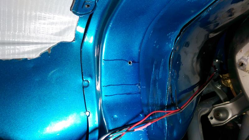

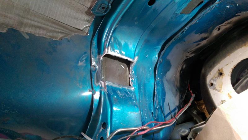

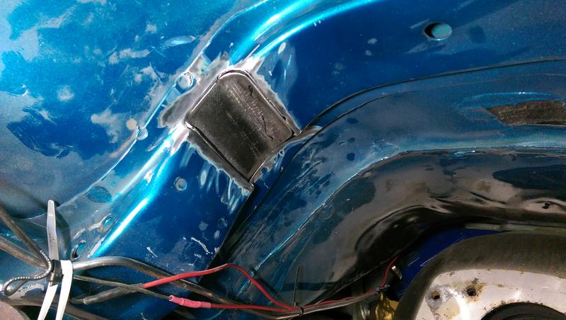

Next came the installation, and I knew I'd have issues with shifter rods and clearance against the tunnel and crossmember. I wasn't wrong. I didn't want to hack a big long area of my tunnel out, so I decided to see if I could gain the clearance needed by just notching my crossmember and and doing a little hammer work on the tunnel. After having the trans in and out about half a dozen times (thank God for that 23 lb weight savings!..lol), I marked where I thought the notch needed to be...

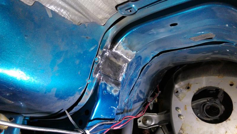

Then proceeded to cut the area out, make a template out of cardboard, then bend/make a piece to fit in the area and weld it back up.
Remember, I was doing all this cutting, grinding and welding while laying on my back, directly underneath the work area which was about 2' above the floor. I think I'd rank this about 1 step above getting my fingernails pulled out with pliers!

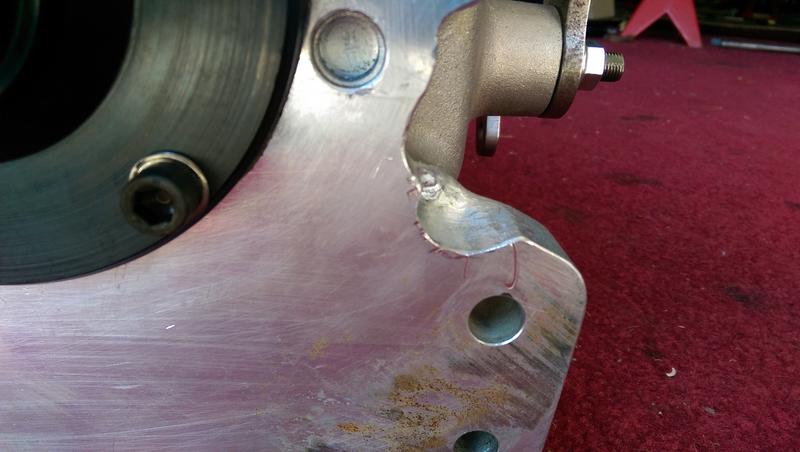

I also discovered that I needed to clearance the trans face to clear the small bolts sticking out of the bellhousing that hold the pivot for my clutch arm. I'm not sure how others got away without doing this, but I couldn't rotate the trans into place to line up with the bell holes without doing this.

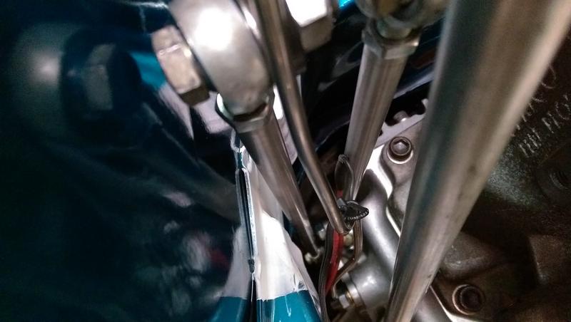

After about the 8th time installing the trans ( :P), I finally had it in place for the final time, and appeared to have the clearance I needed for the shifter rods. This shows the clearance I gained, and with the engine being tied down, I don't think movement will be an issue....I hope.
