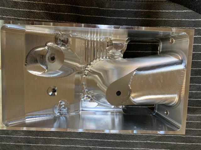

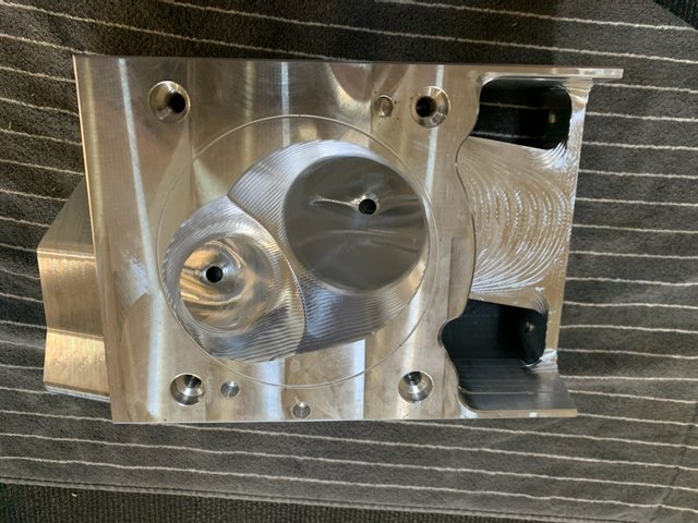

We won't have a firm timeline until we have a design, and a commitment from the foundry.  However, we do want to move as quickly as possible.
Our development process is as follows:
  • I create a CAD model which includes all of the constraints, and has our best shot at the port/chambers.  The layout often driven by the valvetrain and it's constraints.
  • I create a prototype of a single cylinder for flow development.  Below is the most recent example - this is an updated Boss head for the 385 series.  On this one, I removed most of the material on the outside of the port so Dave could easily locate and install a down nozzle for wet flow testing.  This head will be primarily used on methanol burning engines.
    You may notice it doesn't even have valvetrain mounting provisions - it is for flow development only.  We expect to be at this step in a few weeks.
  • Dave does his magic with flow development, and final sparkplug location in the chamber - which is based on wet flow testing.
  • I digitize the optimize ports, chamber and sparkplug location then put them in the CAD model, then finish the design of the remaining items.
  • I program and machine a billet version of the heads for early testing.  At that point, we will have to decide whether to include water passages (for gas) or test with methanol.
  • The cast version will become available as soon as possible after testing and any revisions.

Dang , that Boss section would look good on the mantel above the fire place in the living room :)
Ha, ha.  I was thinking the same thing.  Instead of those bland glass globes, corporate recognition trophies should be that carving.  At least it would be a startling conversation piece.  At least the guys would appreciate it.  I don't know what you'd do for women...maybe a sponge or something like that.

Weather or not you go ahead with it....please post more pics of your development units, that thing is just plain cool!
