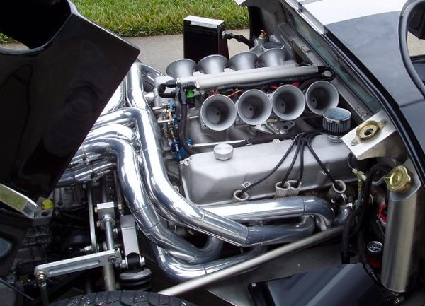

I'd love to see it happen, would also like to see a port injection-ready modern intake that will fit under the hood (if you need specifics, a Boss 9 scoop on a 70 Mustang...)   ;)
Wasn't there an IR crossram cast for the tumnelport? That should fit under a hood.
[/quote]
Funny you say that.....here's a recent story of mine. I have spent a significant number of hours in my life looking up and researching those intake manifolds, tried to get David Dove to make me one too. I was in a local shop a few weeks back, the guy was showing me some of his stuff, and on the bottom shelf sits a tunnelport IR intake manifold complete with all the throttle blades, linkage, everything! I have shifted my efforts from having one made to sweet talking this guy out of his  ;D

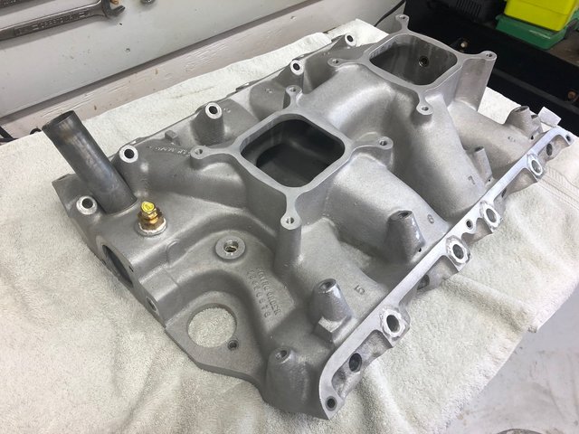

Tunnelport related.... This engine should hit the dyno next week, Blair almost has it ready. 482 cube, BBM block. The intake manifold is a little funky, its a dual plane that somebody had cut all of the dividers out of. Whoever did the work did a real clean job! The dyno headers will have an O2 sensor on each cylinder to make sure the intake isn't causing problems. The intake may work great, may be a handicap, we'll have to see.

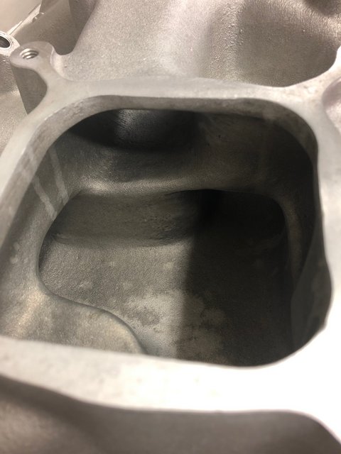

Mike or anyone for that matter I have seen a lot of the plenums cut out or cut down I should say. What is the purpose of that and does it hurt or help? Seems like I saw this done in some early to mid 70s magazine article . I have a high riser intake thst has been done that way. Thanks Lance

The ones I have seen lose over 50 hp and torque, and spit and sputter until the engine gets over 4000 rpm.  Hard to dyno test because of the lack of airflow at lower speeds.  I would never do that for a customer, nor would I recommend it to anyone.  Joe-JDC
I've done it on similar engines and not seen any difference, but those similar engines were lower rpm stuff, around 5500-6000 rpm.   On higher rpm engines I've seen it add power.
I don't cut the divider out, I cut down about a half inch, then shape it into the plenum, and bull-nose the leading edge.

Brent, look at that picture again.  Someone cut down into the lower plane, not just the divider.  Now the runner is only a few inches long at most.  No velocity, no torque.   Joe-JDC

Gotcha.  I thought Lance was asking about just cutting/shaping the divider.
