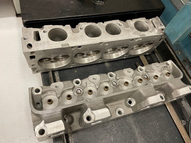

Jim was game to do about anything. The Ford guys told me that the idea of reshaping the PR tube, using various protrusions in the runners and other such ideas had produced absolutely nothing of benefit---ON THE INTAKE side. I was advised to pay attention to the exhaust.
The end result was a set of Dove TP heads with the FoMoCo intake lay-out and Dove's 'Type Two' exhaust runners. The exhaust side was changed so radically that the head lost most of the FE identifying characteristics. The runners were raised, spread further apart, and reshaped.
Jim's design had the angle of the exhaust runner re-done to such an extent that the runner opening was markedly 'up', almost pointing at the edge of the hood when bolted to a block in the car. The exhaust port shape had one lower corner filled-in quite significantly.
I think these may be the heads you're describing? I pulled these down out of the attic this weekend out of curiosity. The exhaust has been significantly worked over and would require a custom made set of headers because the exhaust runners are directly in-line with the exhaust valves. Probably as straight of shot as you can make with the exhaust.

It's been some years since I actually had my hands on the heads Jim made up for us, and your photos don't let us look directly into the exhaust ports. My memory says the external view of the exhaust runners isn't exactly the same as what I remember but it is quite close. Very like revisiting an old friend. :)
