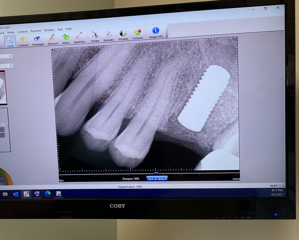

« Reply #160 on: April 13, 2021, 04:11:38 PM »
Now that made me laugh Bill.
Check this helicoil out from a surgery I had last week.
My dentist said he actually has a torque wrench to mount the tooth. That part is coming.
Re: CJ love
« Reply #161 on: April 13, 2021, 04:23:10 PM »
Ok Marc.  This is going off the rails!  I raise you three titanium deck screws.  These are the actual ones the surgeon put in  :D
Seven years later I got them back when they put in a hip replacement.  I'm sure they'll be useful for hanging stuff in the shop:
Seriously - Good luck with the implant(s).
