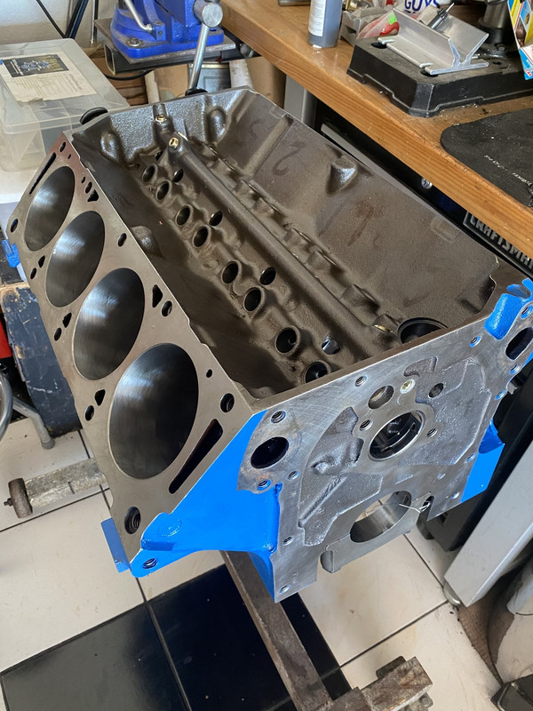

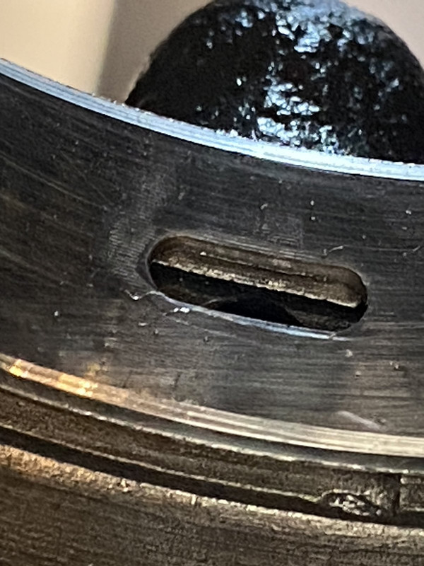

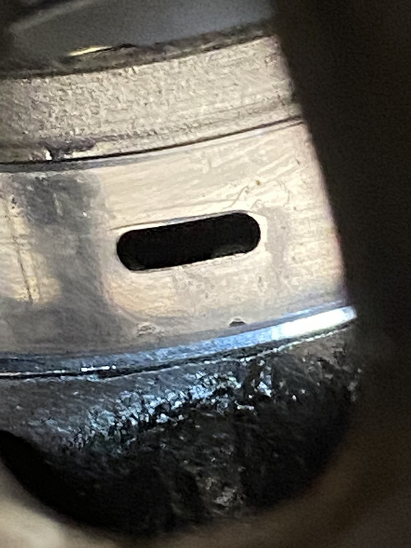

Got my block and rotating assembly back yesterday.
Spent the morning putting my hands on it by chasing all the bolt holes, cleaning leftover crud in the water jackets and just eyeing everything like cam bearings to make sure all is well. Only thing I found was in the rear cam bearing. When I first looked at it, it was from the bad angle (see pics), then I saw the good angle. Alignment looks ok to me, whatcha’ all think?
One thing I did not know (maybe a po did it). The oil supply gallery to the pump is 1/2 in diameter. Is that a CJ thing? Took a quick look on the Cobra Jet site and did not find anything but I will keep looking.
QMP did a nice job on everything. Just needs a little more cleaning.

« Reply #87 on: March 18, 2021, 04:09:06 PM »
Previous owner for sure on the oil passage, they didn't come like that.  Hard to tell on the cam bearing, a close up photo picks up minor scratches that really aren't a concern.  If it feels smooth to your finger I think it'd be OK.

« Reply #88 on: March 18, 2021, 04:17:00 PM »
Yeah I think it’s ok. There’s a couple rag hairs here that need to be cleaned out but it’s all smooth. The telescopic shots on these darn cameras really make it look worse than it is.

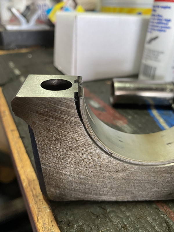

« Reply #89 on: March 21, 2021, 10:55:46 AM »
Initial fitment check of main bearings.
I’m going to label this under, things you don’t notice unless you’re actually doing it all.
I checked another set of caps I have and they are the same.
Gives me the heebee geebees.
