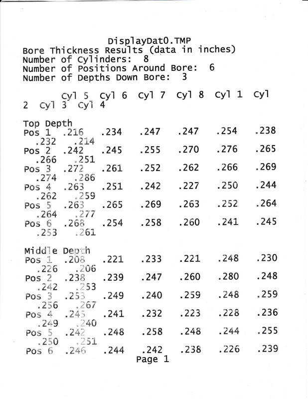

Got the sonic test back.
It’s the best one I’ve ever had. Your results may vary ;D

Dude - bad news on the sonic check.  Those numbers are way off.  Bore spacing on the FE is 4.630".  Factor bore for the 428 is 4.130".  This leaves 0.500" spacing from bore to bore on the 428.  Looking at your map for one example, the middle numbers between cylinders 1 and 2 are .228" and .230", total of .458".  That means that there would be only .042" between the outside of the bores.  That never happens.  Look through the frost plug hole between cylinders 1 and 2, and observe the gap between the cylinders.  Stick a drill bit in there, and find the largest one that will fit.  Subtract the drill bit diameter from 0.500" and that will give you an idea of how much material thickness you have for cylinders 1 and 2 combined, at that point.
That sonic checker was badly out of calibration...

« Reply #73 on: October 02, 2020, 03:26:03 PM »
Running over there with bits in hand >:(

Yeah, Jay beat me to it.  Even in my oxycontin-induced haze, those numbers seemed WAY off.
I threw out my back a few days ago working on the house  >:( >:(  The pain got bad enough that I have to break out the big guns.  It will pass, but life is not fun right now.  Jay - you might get a few amusing FEA studies out of me right now!!
Marc - Have him check the thickness of a China wall with his probe.  Hopefully he's using a proper curved probe as well.  You never know what people try to pass off these days.
