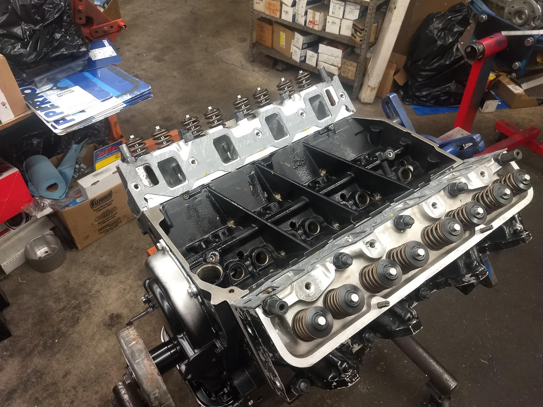

More work done Saturday.
What the new ports look like with the 2.25 intake valves(old was 2.15):
Flow bench
With just hand work they went 280/220.  Now they are 320/240.  That is in line with what Edelbrock was doing with them back in 97 when I bought them.  They sent me flow sheets and info on what they had tried to get from them.  I'm not worried about it being a Max effort build.  Just adding some improvements as I can.
Crank installed:
Degreeing the cam:. Old cam was .63 lift, now .66.  I forgot to check new duration numbers but I know it was reduced a few numbers to keep the peak rpm down.
Check valve clearances.  Need to move pockets slightly, though they are deep enough.
Should be able to button it up next week.

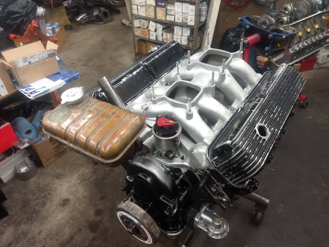

Weekend update.  It's complete, ready for Dyno this week.
Sorry cam card is sideways.  Didn't go through the hoops to rotate it.
Flow numbers:
Up 40 int/20 exh.
12.5/1 comp.  Going to try my 1850 Holleys.  I have my 780 single feed conversions to try also.
Any armchair Dyno numbers from anyone??
