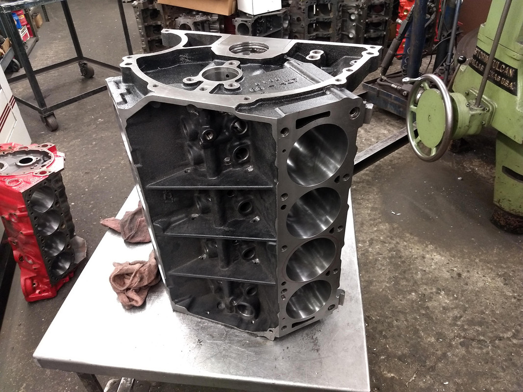

Small steps.  Getting the bores opened up.  Final finish will be with a deck plate.
After asking why he is honing it instead of boring it?   It is easier to just let the hone work on it unattended for a few hours then have to watch over a boring machine.  We're only going .060.

« Reply #25 on: August 06, 2019, 09:14:25 AM »
Well, some progress on it.
I spent Saturday morning deburring(still), I took Monday off for other reasons, but went down Monday afternoon to do more work.  Pressure checked it and file fit the rings.
The heads are back from CNC work.   We're upgrading the intakes from 2.15 to 2.25 since I've got the bore size to fit it now.  Getting some blend work done this week, hope to maybe throw one on the flow bench to see what improvements it made.  They were flowed back in '98, we talked that we should have put them on their bench before cutting them to get a new baseline using their machine.  Hindsight, though not really a big deal.  Whatever it is, it is.
The cam is on the way.   Took a few degrees of out of it and added about .03 lift which should keep my peak RPM down where I want it.  It's a bracket car, I don't want to spin it hard.  It's not about being the fastest(remember it's 4000 lbs).
I weighed my existing 1973 428 service block that is 3/4 filled.  Right at 220#.  The new BBM block is 230#(same scale), so I'm not really added a bunch of weight like some had contemplated.
Hope to have the crank back this week to check clearances.   Then check deck.  With any luck I might be able to wash the block up this weekend?

Curious why folks are concerned with boring the BBM to 4.310" since it is supposed to be safe to 4.440"and have .200-.250" walls?  Anyone actually bored one past 4.375" yet?  Joe-JDC
Re: Time for some upgrades....
« Reply #29 on: August 06, 2019, 09:44:06 PM »
I forgot to Sonic it.  Maybe this weekend?  I'd just like to know.
