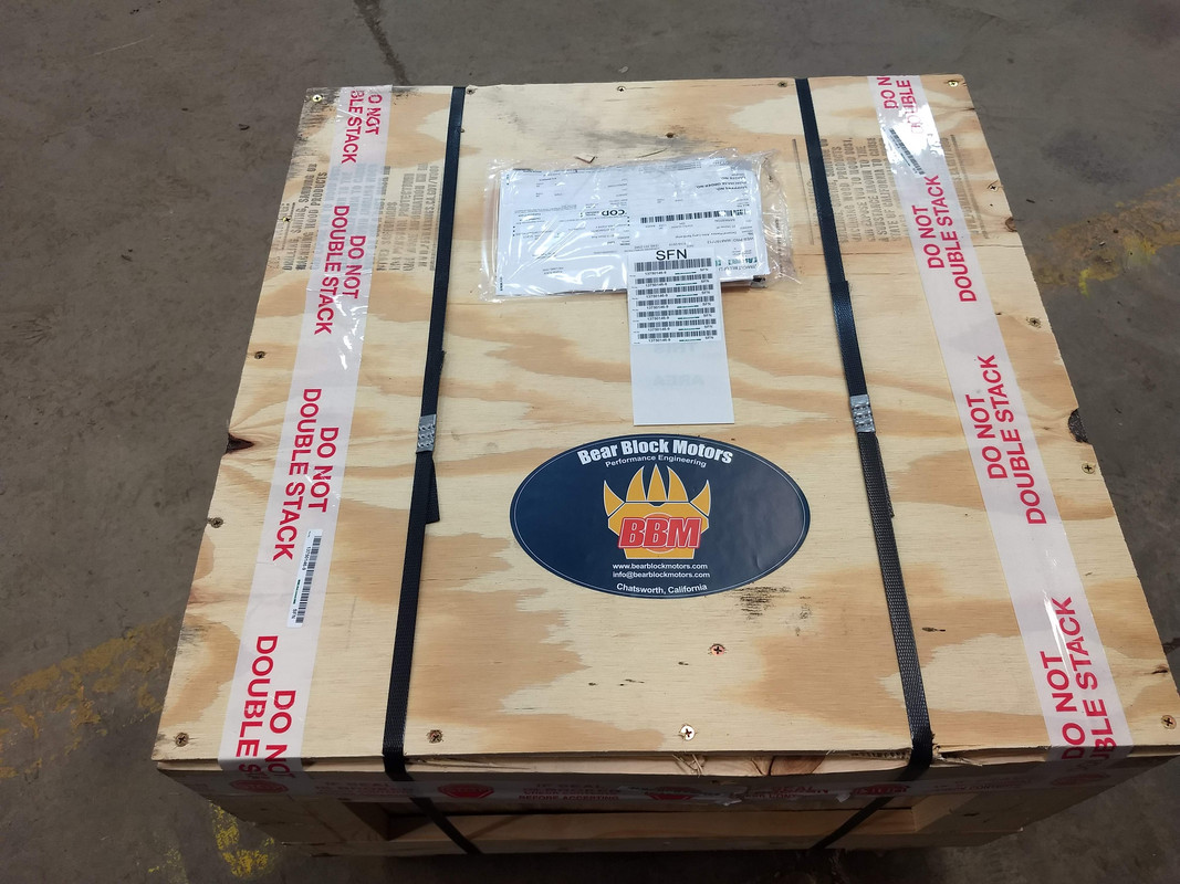

I got the old 428 torn down.   The 4.25 crank will be checked out and fitted to the new block.
I have 4.310 flat tops coming from JE Pistons.  Should put me about 12.7:1 compression.  (I want to run 110 oct fuel.  Don't want to deal with $12/gal fuel)
Reusing my rods.
The camshaft is yet to be determined.  I was going to run my old .63 lift flat tappet, but I bought some of those fancy Nascar diamond coated lifters, so I'm going to look at increasing the camshaft a bit.
The heads are going to Fox Lake for a CNC job.   They were hand worked back in 1996 when I bought them new.  They flowed 280I/220E, which was fine but going with another increase in CI, I think I could use some more wind.
The old motor (462) made 625 @ 6500 rpm with 600 ft/lb at 4000 rpm.  No real idea what it will make now.  Not really shooting for any specific number.  I am just letting it fall where it may.  I'm working on deals to make improvements.  So far, so good.
My original block could be fixed(just needs a sleeve), but I just said "what the hell" and decided to live it up a bit.  Hope to have it together by end of August(maybe earlier depending on piston arrival).

That’s just a beautiful thing Larry.
Good luck on your build.

Boy am I jealous Larry. I waited for 6 months when I ordered a Bear Block. Never did get it. I bought a used marine block from Carls.  I started getting it prepped last November and I still have to get Head gaskets. Its assembled on the lower end and I mocked the heads, Jays manifold adapter and my tunnel ram on the engine. Still have some misc. (new carb) stuff to do before putting it in the 63. The way the summers going it will be Oct be fore I can pull the old 427 out and install the new one.  Good Luck!
Got lucky I suppose.  Didn't really want to do all this, but figured WTH?  The block was available, so I took the plunge.

Hey Hey, I like the looks of that block!  I thought you might go that direction when I saw you had a block issue............ I think I'd want to just leave the block sitting around in my living room for several weeks so I could admire it before starting the new build.
Re: Time for some upgrades....
« Reply #11 on: July 22, 2019, 07:39:26 AM »
Well, just going to have to look at pictures of it.  It's at the shop, I was grinding on it Saturday, deburring and chamfering and stuff.  Baby steps.....
