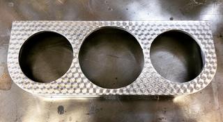

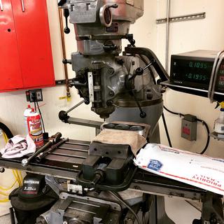

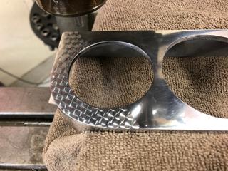

I got the idea to match the gauge panel to the the factory dash pattern. This Saturday I gave it a whirl, here's how it turned out.

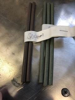

Those sticks are made by Cratex. Specialty made abrasives for engine turning. I'd highly suggest them. Made it look like I actually know what I'm doing.
The process was completely time consuming, took me about 5 hours to get done I believe. Because of the pattern, every move I had to make both an X and Y shift, couldn't just lock it in one axis and do a whole row (I guess I could have rotated the mill head, but that would have required some pretty shifty math :-\).

That is NICE. You'd never know it wasn't a factory option!

Man that's nice. Makes my attempts with a wooden dowel, lapping compound and a drill press look awfully primitive.

That is super nice!  I'm tempted to write a little program for the CNC to knock out some engine turned surfaces.  It would do something like that in a matter of minutes!  I love that look  :)

I thought about that, the only problem I see is that the sticks wear away and I was using a file to straighten up the tip of it probably every 10 dots.
Here's where I got them. Q046
https://www.cratex.com/Products/Rubber-Abrasives/Blocks-and-Sticks/Round-Sticks
