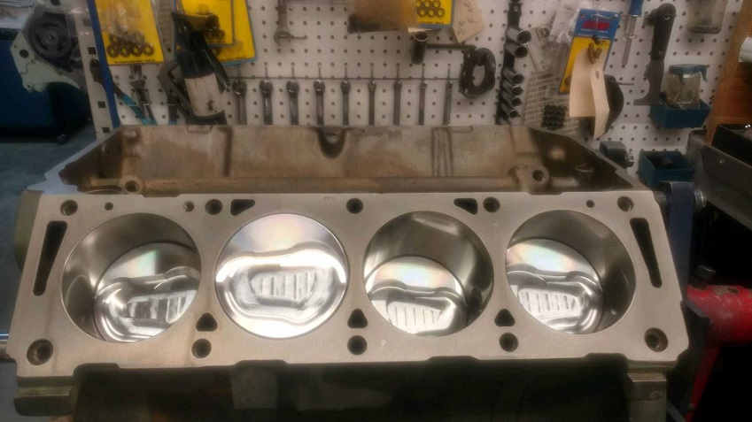

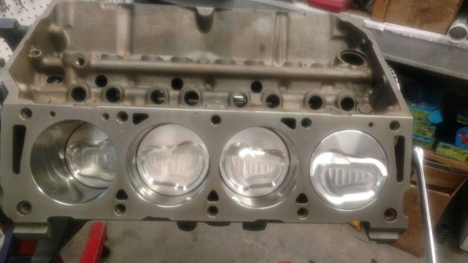

The engine is coming together in Tennessee. 428CJ block, 4.25" crank. Will receive a set of Blair's "EMC" cnc ported C4AE-G heads and an Edelbrock RPM intake. Should be plenty of engine to pull the car around.

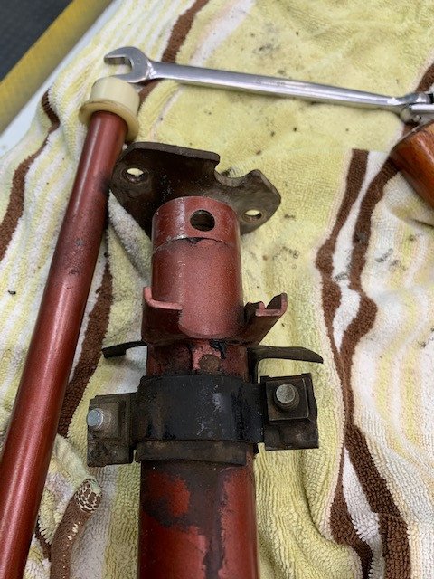

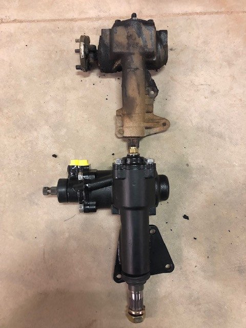

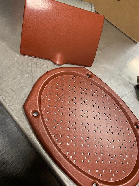

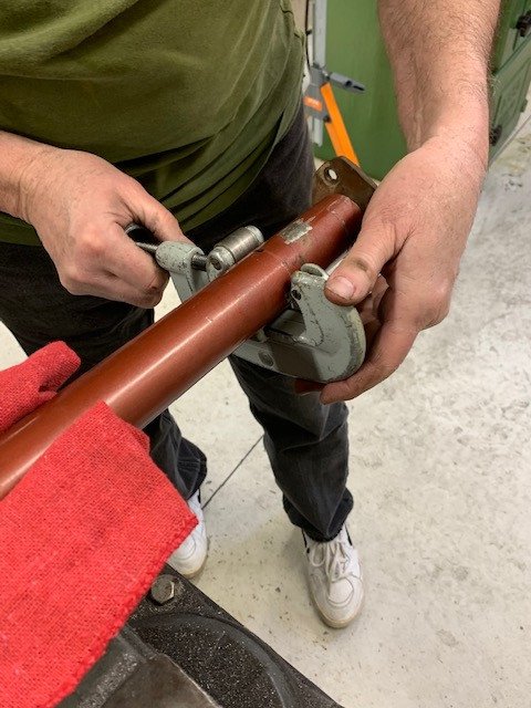

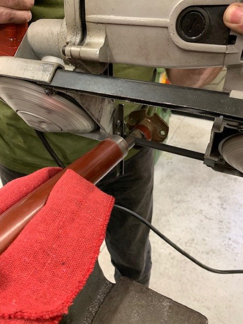

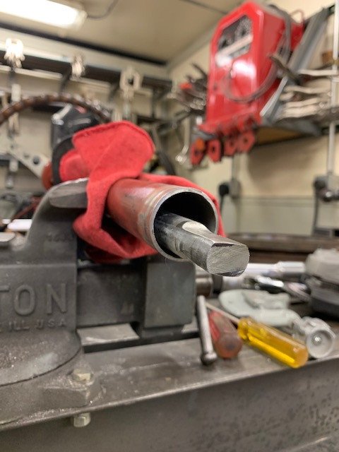

This weekend we messed with the steering column. The Borgeson power steering box requires that the column be shortened roughly 2-3/4" (2.675" to be exact). I was in a hurry and didn't get a picture of it all put back together. This column isn't the easiest to mount a gauge to, so I'm going to have the neighbor machine an aluminum piece that will fit around the multiple tubes and will bolt together in two halves around the column. I used the rear speaker grille to test out some interior spray paint I had mixed, looks like the guy did a pretty solid job!

Is the purpose of this steering box so you can do away with the power steering ram cylinder?

« Reply #36 on: February 19, 2020, 02:01:52 PM »
Yes. I would love to do away with the wonky ram. However, it can't be used on FE Mustangs with headers.  Of course, I wouldn't cut up the steering column on my Shelby.
The older Bendix units leave a lot to be desired being they float all over the place.
                                                                                                                     -Keith
« Reply #37 on: February 19, 2020, 02:12:00 PM »
I don't believe on the Mustang units that cutting the steering shaft is a requirement, but it does look like cutting back the column tube is. Agreed, wouldn't do that to a Shelby car.

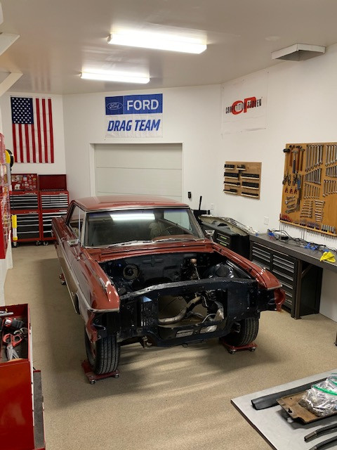

I've got two more lower control arm bolts and the Galaxie will be as far pulled apart as I plan to take it. Going to spend my week scrubbing parts and painting the suspension components now.
