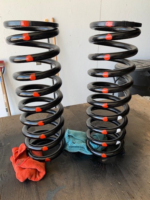

Suspension components are painted. Hoping to have the car back on the ground next weekend.

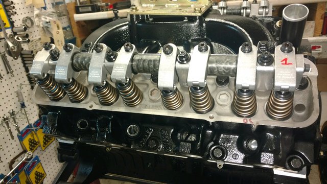

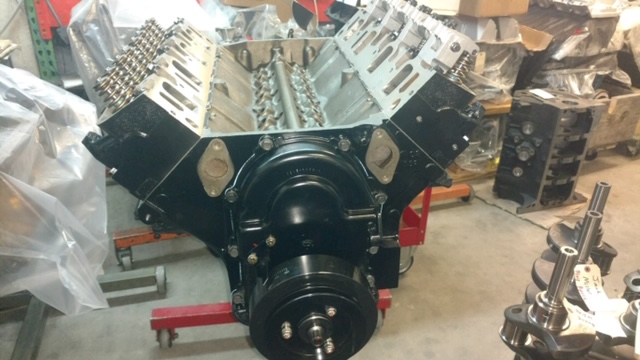

Heads are done, engine is moving along quickly now.....I better get moving on the car.
BP "engine masters CNC" head for those wondering. C4AE-G castings.

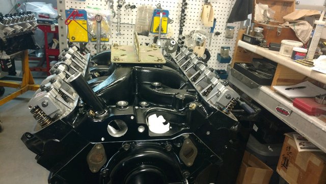

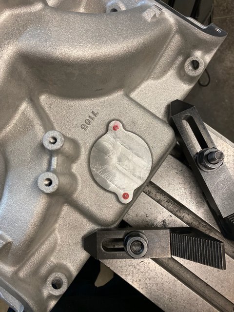

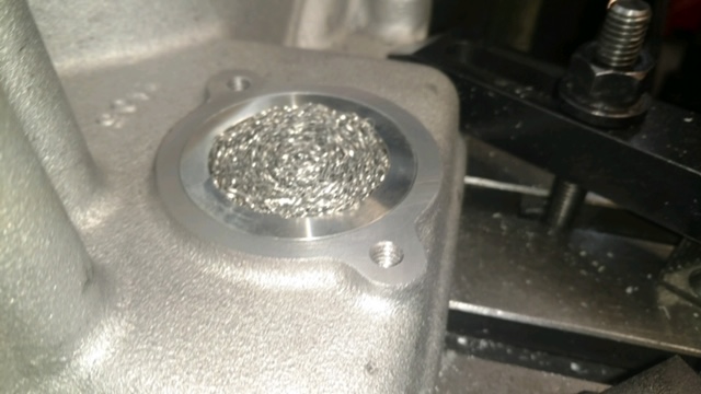

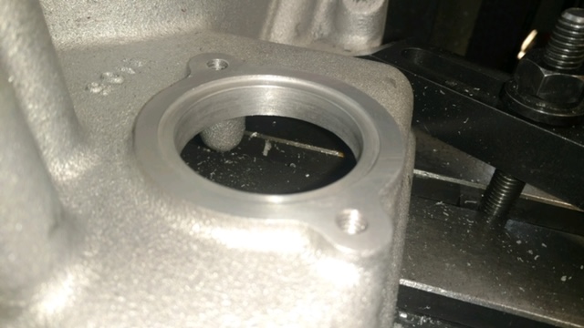

Some engine pictures, coming together! The pictures show some of the odd requests I've made on the intake. The Performer RPM intake does not come with any provisions for an oil fill tube or PCV, which creates a situation where you can't run the factory Thunderbird valve covers. Here are the modifications, oil fill tube welded in and draft tube connection in the rear. Script will all be deleted and intake painted black.
By the way, the oil fill tube hits a water jacket when you drill the hole, so the modification should be left to someone who knows how to weld on cast aluminum.

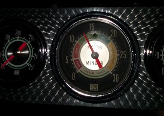

Thanks Brent. Every time I walk out into the barn and look at the car I add 5 more things to the "to-do" list. No promises on when the car will be on the road, but I'm picking away at it.
Tested out my old motor minder gauge on my Dad's Glaaxie last night and determined that the gauge still functions properly, so that was a win. Don't have to send it in and have it redone.

Alright guys, here it is, the "300hp Z-code 390". Heading to the dyno this week.
« Reply #84 on: August 24, 2020, 10:40:43 AM »
I'd say that "Z Code cast iron 4V intake" has been to the all-you-can-eat buffet a few too many times  ;D
Engine looks great!  I do like the understated factory paint.  Your car is going to be a sweetheart!
