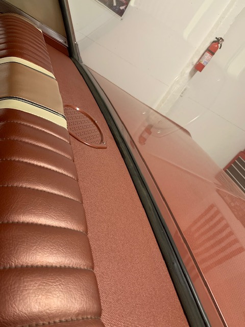

This weekend we messed with the steering column. The Borgeson power steering box requires that the column be shortened roughly 2-3/4" (2.675" to be exact). I was in a hurry and didn't get a picture of it all put back together. This column isn't the easiest to mount a gauge to, so I'm going to have the neighbor machine an aluminum piece that will fit around the multiple tubes and will bolt together in two halves around the column. I used the rear speaker grille to test out some interior spray paint I had mixed, looks like the guy did a pretty solid job!

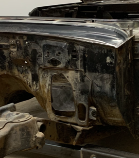

I found this picture of the '60....the hole in the firewall and the 3 holes in the frame for the steering box all look consistent with my '62. I'd see no reason why it wouldn't work? There could be some funky things going on with the '60 steering column, but as you can see, there's customization that has to happen anyhow.
My setup is more involved than what I see most people do, because I think 95% of people choose to avoid the rag joint. It would have been quite a bit simpler to avoid it and just run a simple rod coupling, but I don't tend to make things easy on myself.

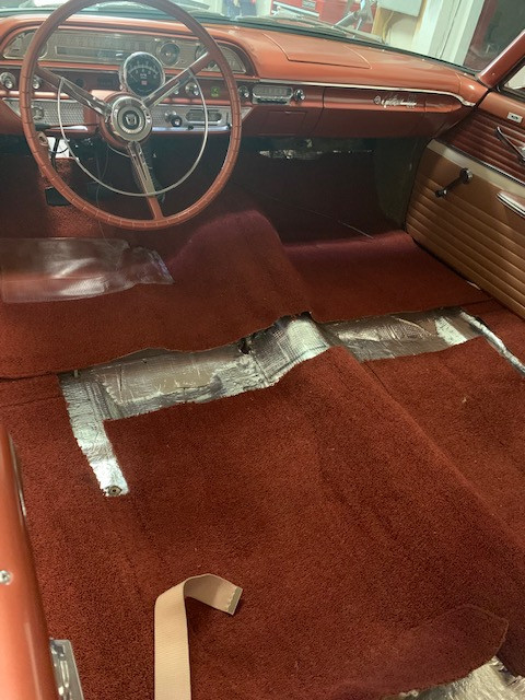

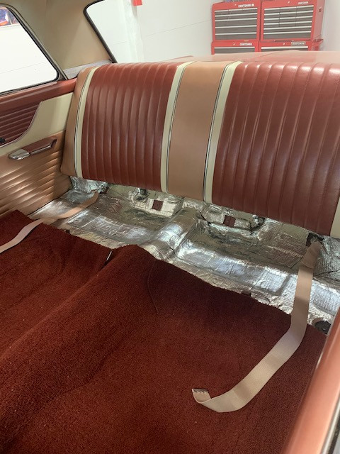

I received the front seat from the upholstery shop so now it's time to put the interior together. Back seat was nice enough that it didn't need to be redone. This weekend I fixed up the package tray, it was a little worn from sun. I got half way done installing the rear seat belts and realized that I didn't have enough of the hooks so I'm kind of stuck waiting on those to come from Pennsylvania.
The carpet you see is actually NOS carpeting. I got SUPER lucky finding it. My dad stopped by and looked at it, he immediately advised that I rip the heater core out of the car and get a nice new one in it so I don't ruin my fancy carpet. So now I'm waiting on the heater core to ship in from New York too. The carpet was folded so you can see the crease in the middle of it, I'm hoping it relaxes and the seem goes away.
There's an exposed part of the carpet underneath the front seat. You can't really see it unless you are looking for it once the front seat is in. Being that I have a few days waiting on stuff I think I may paint it black or at least slide something underneath the carpeting that is black so you don't see the silver sound deadening foil.

If the carpet is easily removable set it out in the sun to warm it up and relax the backing, smooth it out as you put it back in to remove the crease marks.
If they are stubborn a wall paper steamer would help.  The marks may be slightly visible for a while but they should go away as long as the backing wasn't heavily distorted by the folding.

Mike, I just replaced the carpet in my '63 Fastback with a new set from ACC which was supplied by SMS.  The exposed areas won't show and your NOS carpet was cut the same as the original set on my Dallas-built car.  Mine came rolled up and quickly relaxed when I laid it out flat for a day or so.
