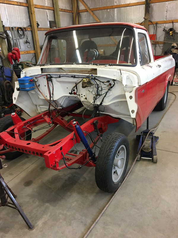

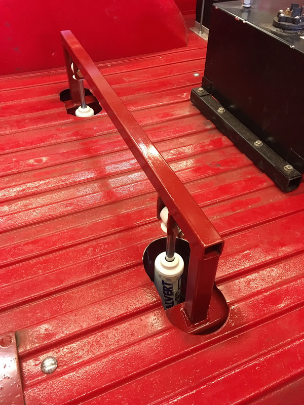

We've got the rear end tore apart now. The factory shock mounts had the shocks laying at about a 45* angle. So we weren't using much of the shocks travel. They're gonna be standing straight up and down when we're done. Calvert adjustables.

We hauled the truck to town last Friday for the street legal drags. Ran a new best of 11.47@113. With a 1.567 60’. Getting back down to 1.5xx something in the 60’ is certainly a win for us. Getting the rear shocks squared up with the springs seems to help the launch. Pic of the new shock arrangement below.
 And following Blair’s advice on the burnouts was spot on too. Thanks again, Blair.

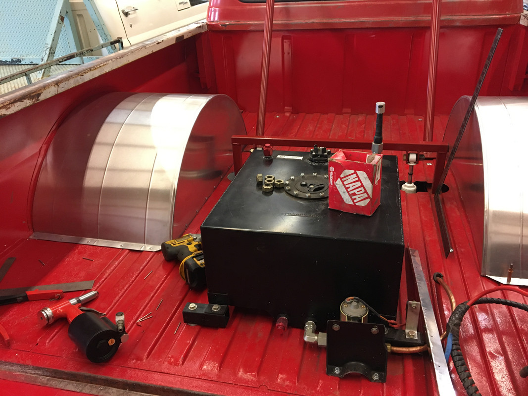

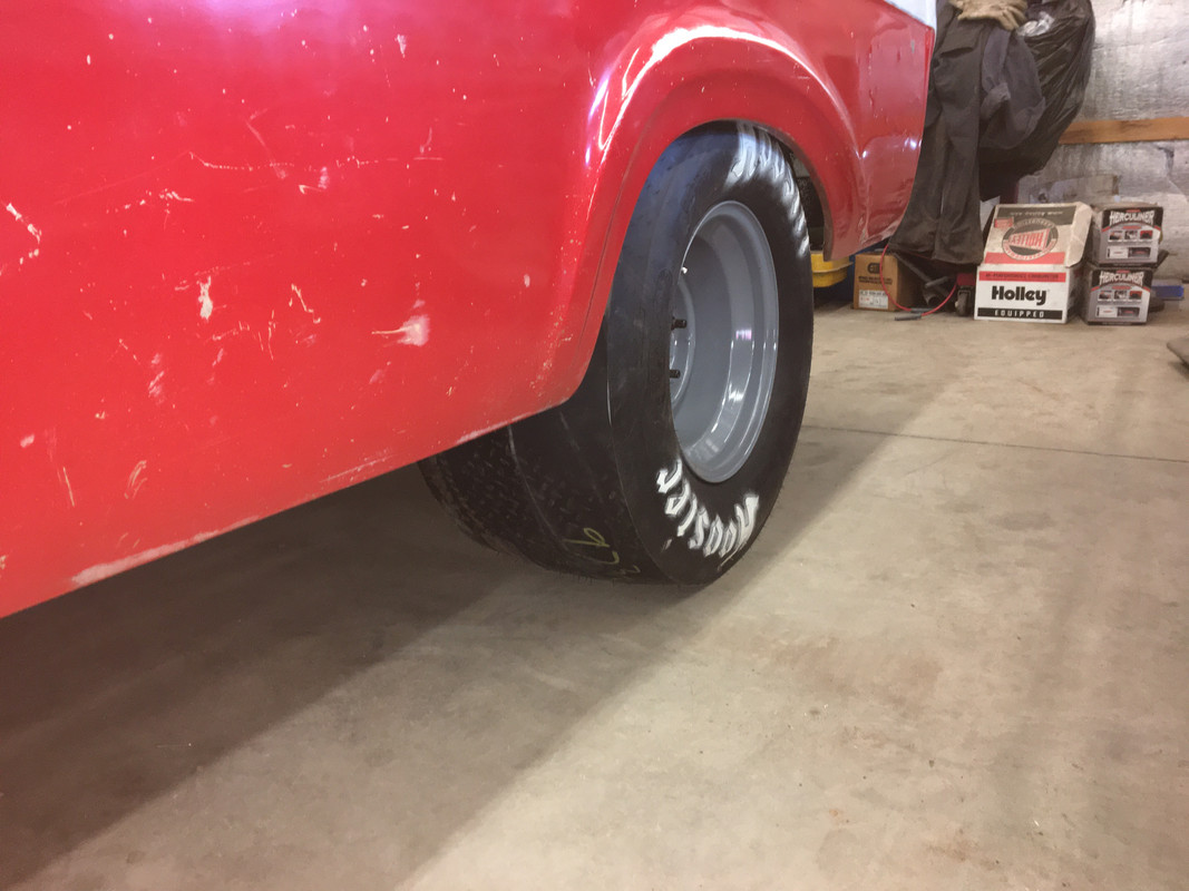

One of the big issues we had at the track last season was traction. I went with M/T DOT drag radials because several acquaintances liked them. They all have much lighter cars so maybe they work better for that application. They don't like a heavy truck. They did work better for us with a well prepped starting line. But still shook the truck. So after much measuring and discussion, we ended up with a 30.5x13.5 Hoosier bias slick with a stiff sidewall. Hoosier lists this tire as a 29.5x11.5W. It seems odd not being able to look at the tire to see what size it is. Anyhow, we also had a pair of custom 12" wheels made. We didn't want to radius the bedsides so it took some back spacing.
 To get all that tire to fit, I cut out the old factory wheel tubs and got an aluminum wheel tub kit. These are no fun to assemble at all. Dad and I fussed with these for a while. But in the end, we came up with a pretty sweet installation.

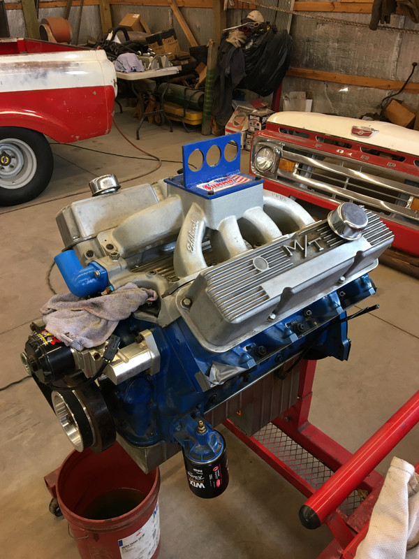

After we finished the cowl ducting, we tore the whole thing down for a thorough inspection. I didn't get many pics.
 Everything in the 504 looked pretty good. The cam lobes and roller lifters looked new. The T&D's didn't show any signs of distress. Nothing turned blue, Lol oiling thru the push tubes is working good! We did give it a new set of rod bearings, with an additional .0005 clearance. A few bearing shells showed some weirdness.

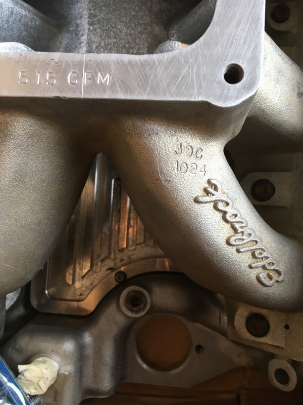

The intake was sent to Joe-JDC for a judicious porting job. Thank you Joe! The roof of the ports were raised to better align with our Pro-Ports intake port. This was the last part of our plan to move more air thru the 504. We can't wait to see the improvement!
