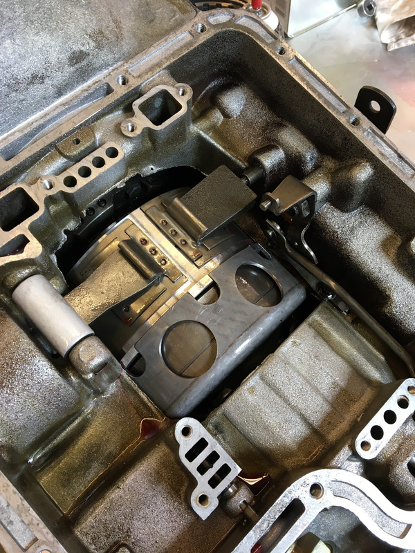

When we put the engine and trans together the first time, we thought we double checked everything. We were surprised that all of this aftermarket junk actually fit together. Well....what we found when we dropped the tranny was some pretty good interference. Between the heads of the flexplate bolts and the anti-balloon plate of our torque converter. We just used factory Ford flexplate bolts with the 3/4 hex. They've since been replaced with some short 12 point ARP flexplate bolts.
The pic below shows six rusty looking smudges from the bolt heads.

Thats not too bad, another option would have been to install a flat washer between the flexplate and torque convertor to add a little space, as long as there was still enough room to do so, (usually is). I have seen some SB Fords where the flexplate bolt heads left a complete image on the torque convertor, right down the slots of the bolt heads.

What got us wondering was the strange wear pattern on the ring gear. The starter gear was engaging the full width of the ring gear in spots and other spots only showed about half the width of the tooth engaged. Once we found the rub spots from the flexplate bolts, we figured the flexplate was probably ruined, having been pulled on "against it's will". A quick check of the face run out showed it still ran within .010. We straightened it to within .004 and called it good. Got lucky.

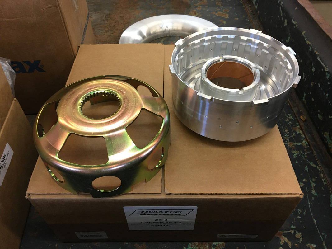

After finding the interference between the flex plate bolts and anti-balloon plate, we decided to take a look at our hotrod C6. Aside from the burnt clutches in the direct drum, everything looked pretty good. I had machined a new snap ring groove in the direct drum to fit 5 clutches, but that was it. Some builders like to swiss cheese the shit out of it with 1/8 holes to lighten it and let the hot oil out. But without a way to spin balance it after drilling, it didn't seem like a good idea. It's the biggest, heaviest piece in the C6. Almost 10lbs. So we didn't go down the path of drilling our direct drum. Maybe it would have prevented the slipping clutches, who knows. Slamming it back into 1st gear at the top of 2nd gear could be some of the problem. :)
I picked up some light weight goodies while we were inside the C6. The aluminum direct drum weighs just over 3lbs, quite a bit lighter than the FoMoCo piece. I also got an ultra light sun shell driver.
I was able to fit 8 clutches in the aluminum direct drum. I used the Red Alto E4OD kit. This should help with the slipping. We were bummed when we realized we couldn't use the ultra light sun shell driver. It's made to fit the Stock C6 1st gear inner planet. Our hotrod C6 uses the lower 1st gear out of the E4OD. I forgot about this detail. So I set up the factory E4OD sun shell driver on the Bridgeport and punched some holes in it. It had been modified already to clear the wide Kevlar band. Forgot to get a pic of my handy work. Anyhow, I hope it doesn't vibrate or cause some other issue.

I am curious to see the improvement from the lightened parts. May not be noticeable at your levels, or with other changes, but it has to help. Anytime you can lighten rotating weight is a plus, as long as it holds up.
