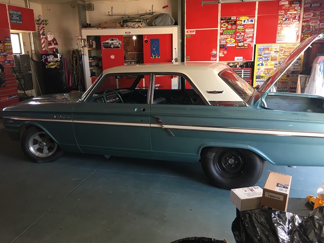

Sounds great! We were sitting in the garage Friday night kicking around the idea of heading over the hill sometime this summer and racing in Grand Junction. That's your track right?
Car just got repainted. Factory colors, just a refresh.

Hey that Fairlane looks cool! I like the color too.
