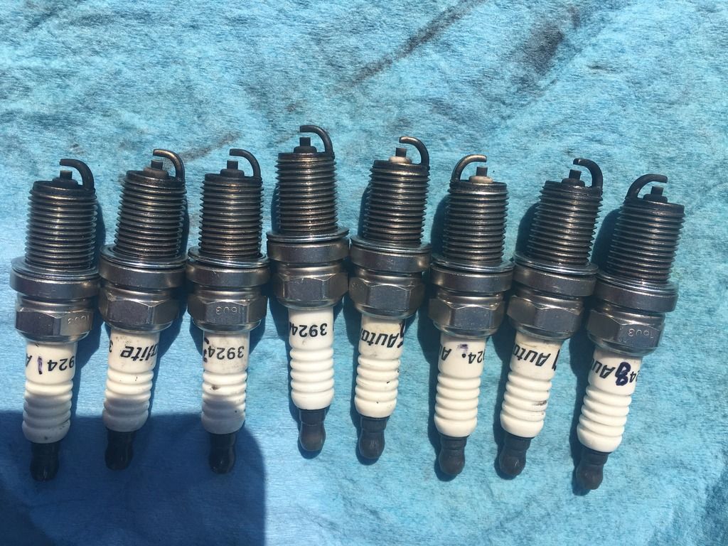

I did get the carb off yesterday - I haven't figured out how to adjust the rear plates without taking it off. Reduced both plates to just a tiny bit of exposed transfer slot.
Then I pulled the plugs in preparation for adjusting the preload and took this picture of the plugs:
Some of them seem a little sooty. More variation than I expected but I'm really new to this.
On the preload I was surprised that I could rotate all the pushrods with my fingers, a few of them very easily. I backed off each screw, then turned them down until the pushrod would not rotate between my fingers (and could feel the screw engage the pushrod) then turned down one full turn and torqued the lock nut.
