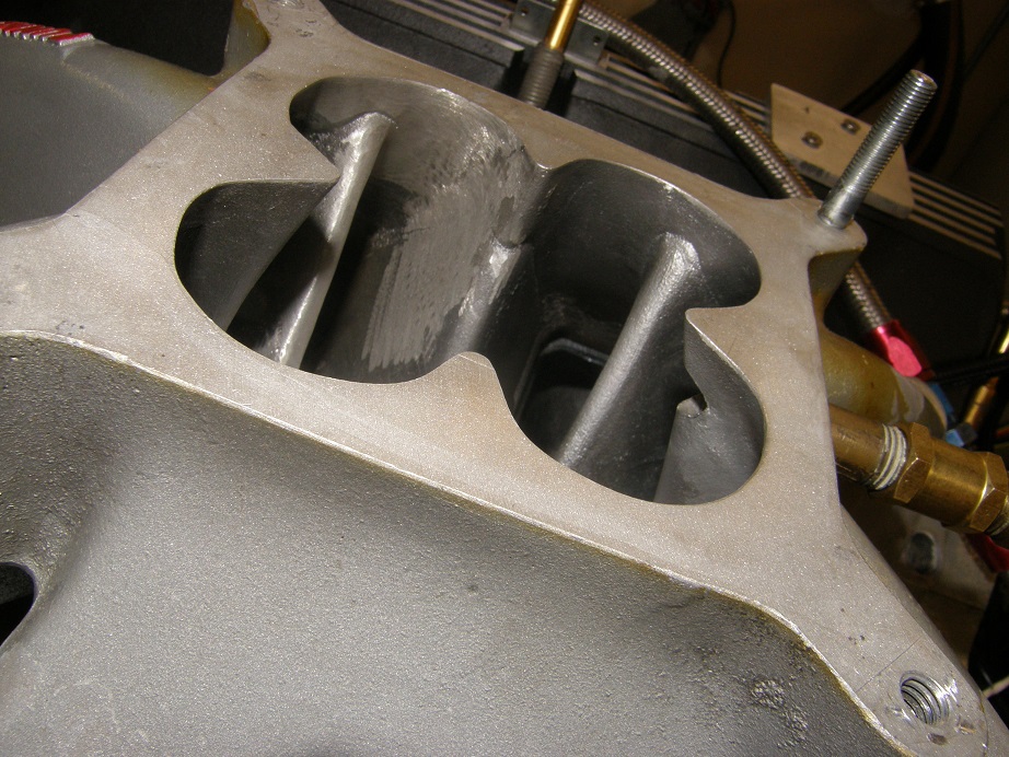

Thanks Earl, I'll be fine by the end of this week.  FYI, here's a picture of your Strip Dominator with the bottom cut out.  I tried to remove just the hump in the middle but it still wouldn't fit, so I had to take the whole lowered area out of the bottom.  I will send you a PM on this - Jay
