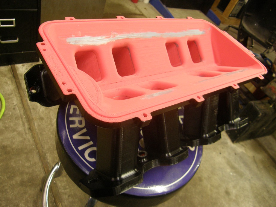

For my last test with carburetors (for now), I bolted on my 3D printed intake.  I was really looking
forward to this test, but also was quite concerned about air leaks.  There was no guarantee that
the 3D print was airtight, and in some places it was quite thin.  As a result I re-printed a couple
of the runner sections to make them a little thicker.  I also found some strands of plastic coming
loose inside the plenum, so I smeared some TA-31 over those to keep them in place.  I also took
the time to spray the outside of the intake with a couple heavy coats of black paint, to try to
give the intake every chance to seal. Here's a couple of pictures of the intake with the sealer and
also the paint on the outside:
After getting the intake as ready as possible, I bolted it on to the engine for a trial test.  For
carburetion I used the two 660 center squirter carbs that I had run on the Weiand tunnel ram at the
beginning of work on this dyno mule.  Holley makes an LS top that allows bolting on the two carbs;
here's a picture of the intake with the top, and also the complete setup bolted on the engine:
The moment of truth had arrived.  I started the engine, but it would only fire for a moment and then
it would quit.  I experimented for a while and did manage to keep it running at around 2500 RPM for
a few seconds, but vacuum was nonexistent and the engine was running super lean.  Obviously, I had
a severe vacuum leak, which was what I had been afraid of.  No way I could run the engine like this.
However, when I pulled the intake off the intake adapter, I found that the problem was different than
I had expected.  It turned out that when I tightened the plastic manifold down, the bottom of the
ports had curled up, so that I had no seal on the bottom half of the intake ports.  In fact, on one
port I measured a gap of nearly 1/8" between the plastic runner and the intake adapter.
At this point I went on to do the EFI manifolds, but after that I came back to the 3D printed intake
to try again.  This time I didn't tighten the plastic manifold down so much, and also used a thick
bead of TA-31 around the bottom of the ports to make it seal.  However, when I was done tightening
the intake I found that another problem had surfaced.  The runners of the intake are held to the
plenum with screws, and the plastic threads in the plenum were pulling out, allowing the plenum to
separate from the runners in several spots.  Again, an obvious potential vacuum leak.
The solution to this would have been to drill the attachment holes in the plenum all the way through,
and put a through bolt, like a small carriage bolt, through the plenum from the inside with a nut
on the outside.  This would have been a fairly time consuming project, though, and my friend Royce
had arrived with Honest Abe, his Lincoln Y-block for Engine Masters, and he needed to get the engine
on the dyno.  So, I ended up pulling the 504" dyno mule off the dyno without having had the opportunity
to test the 3D printed intake.  I will get the changes described above made so that I can test it
when the mule goes back on the pump.

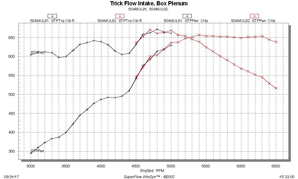

I decided to test the box style plenum first; here's a picture of it on the engine:
Royce B was up with his Engine Master's engine by this time, so he pitched in to help me with the
 dyno work.  Soon we started the engine and began tuning.  These were different fuel injectors
than the ones Marc H had brought for the previous EFI test, so we ran several pulls to dial in the
A/F curve with these injectors, and with this intake setup.  Once we had the A/F correct I ran both
the low RPM pull and high RPM pull back to back; they are shown together on the graph below:
Peak torque with this setup was excellent at 670 foot pounds, and average torque in the lower RPM
range was excellent.  But the torque curve was on a real roller coaster ride up to 4500 RPM.
Horsepower was only just above 650 HP, but it was flat almost all the way to 6500 RPM.  Manifold
vacuum was up to an inch at the end of the pull, indicating that an even larger throttle body
would help the power output.  In light of that there was really no reason to test the smaller
throttle bodies.

the ability of this induction system to make good power, and it sure seemed that way from the dyno
results.  This intake was smoother at the lower engine speeds than the previous one but fell off
pretty dramatically at the top end.  Here's a picture of the low RPM pull and the high RPM pull from
this setup on the same graph, and then put together with both pulls from the box style plenum on
the following graph:
At least for this engine, the box style plenum seemed to be far superior.
That pretty much covers all the dyno testing I'll be doing for a while on this particular mule.  I
have plans to do more testing in late fall or early winter, with a few more intakes, and will post
in this thread when those tests happen.  In the meantime, I have updated the table below with all
the results, and have also included some graphs showing all the intakes and how they performed in
the different parameter areas (Peak HP, Peak Torque, Avg HP 4500-6500, Avg Torque 4500-6500, Avg HP
3000-5000, and Avg Torque 3000-5000).  Hopefully this will allow someone with one of my intake
adapters to make a good manifold choice when running it on the engine.
