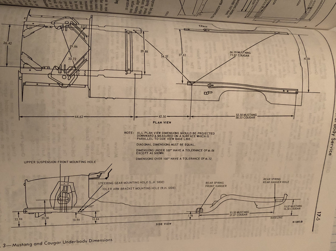

Yeah Doug that’s what I’m worried about, I guess I will be doing some measuring. To bad there aren’t any specs that I can measure against
The 1967 Ford Mustang Shop Manual has the pertinent body measurements you can check against.
Re: 1967 fastback 485
« Reply #76 on: October 14, 2019, 09:44:54 PM »
Awesome thanks Kevin that’s a big help.
