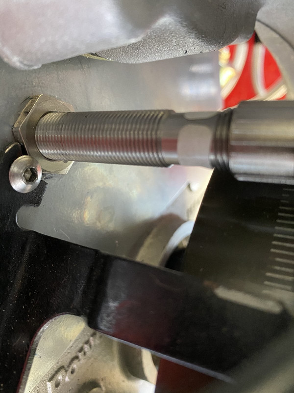

Here it is.
Thank you for the kind words.
The link to Jays set up thread is below.
Here’s the target
Here’s the thread where Jay explained how he set his up.

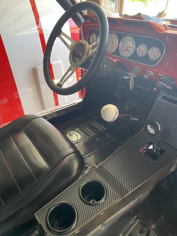

I’ve progressed far enough to finally clean all the cut off wire and tools out of the interior and get it kinda together so here’s a pic of the control room. Sorry it’s bright sun out in front so it’s flare time.
Getting closer. :)

« Reply #264 on: May 20, 2020, 09:14:16 PM »
Looks great....I have a TKO 600 in my 68.Tell me about the shifter stick and knob...That's looks like the stick I want..Resembles the comp plus stick...
1936 Diamond T 212BD
1990 Grizzly pick-up
« Reply #265 on: May 20, 2020, 09:34:47 PM »
Thanks
12 inch Hurst stick right off Summit. https://www.summitracing.com/parts/huu-5388022
Lots of lengths to check out.
The knob too.
BTW the bend and length of the shifter fit perfectly. I’m a big dude, I’ve moved my seat stand back 4 inches and two inches lower.
