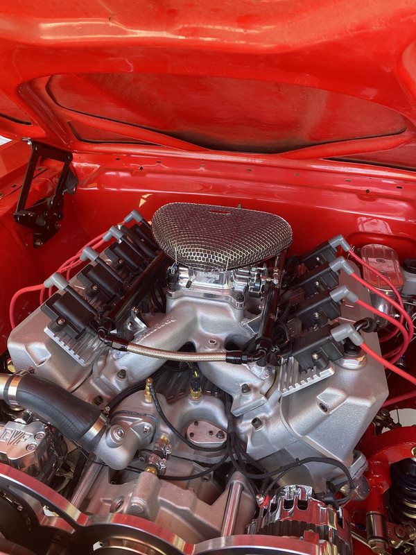

Getting details done for the street. Ya know like seats, lights, air cleaner, hang doors (try that by yourself), little stuff. ;D

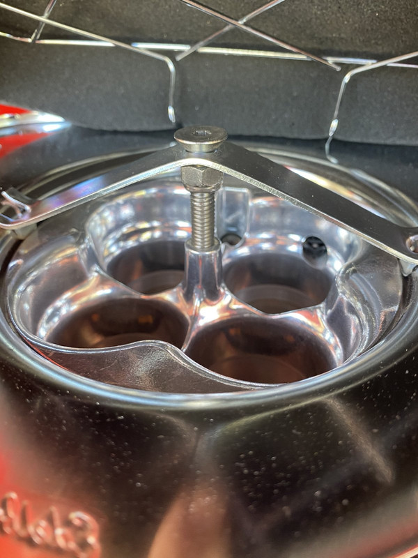

Speaking of air cleaners. I have barely any clearance. The scoop does afford me a chance though. I got one of these Ed triangle deals and darn if it don’t work. It’s mounting system is a bit hinky though. It’s a bar that spans the throat that is held down by nut. Only problem for me is that it’s inside the whole deal and the vision of a nut coming loose and heading down into my new engine is a no starter. So I am using a bolt and a nylock nut under the bar to lock everything in place so nothing can take a bad trip.
I had to hack off a half inch of the base so it would make it and it still clears the throttle linkage.
I’m not sure about the looks of it but for now it does it’s job.

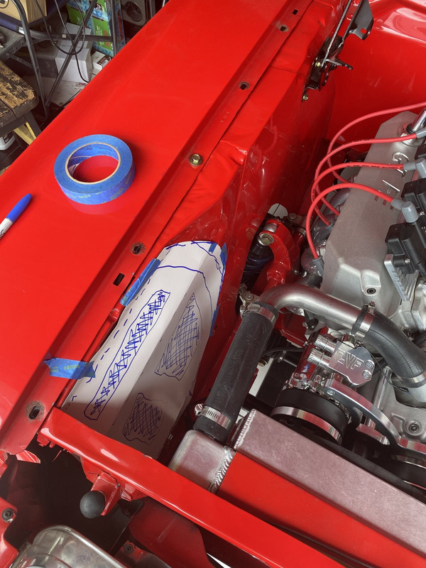

One other job is fabbing a cover for my headlight and fan relay board that I mounted in the old battery compartment. The scribbled in area will be some type of screen to allow air flow and hopefully look good.
« Reply #296 on: July 04, 2020, 08:14:08 AM »
Marc, a brushed aluminum cover with some Windows would where you would rivet either some light expanded metal or screen for ventilation might look good there. Maybe something to match the Ed air cleaner?  McMaster sells many types of rubber molding that you could use on the outside edges.

17 year old me nearly lost a 75 Ford pickup due to a carb fire because of one of these.  I got a sneeze through the carb and the foam caught on fire instantly.  Be careful!   :)
« Reply #298 on: July 04, 2020, 10:09:11 AM »
Interesting
Edit
Well after some snooping around the web this air cleaner may be a non run only cap. For right now I’ll take it off for running.
There are plenty of stories about them breaking down and dropping pieces in or catching fire.
Thanks for the heads up drdano.
« Last Edit: July 04, 2020, 10:24:02 AM by turbohunter »
« Reply #299 on: July 04, 2020, 11:17:09 AM »
I've got one of those air cleaners on my 68 fastback and I too have had issues with backfires causing the foam to melt and drop into the carb.  Never had it catch on fire though.  Marc, if you get your EFI system tuned right I don't think it will be a problem.  My issues have always been carb related, for example with the car sitting for a week or so, you have to pump the accelerator pump a few times to get the fuel in the engine to fire, and if you go too much on that you can get a backfire.  With your direct port EFI system I think this is much less likely.
