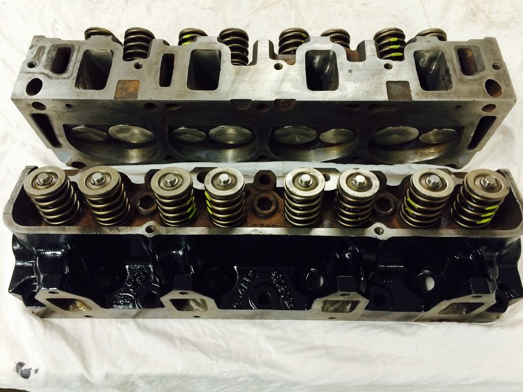

Well then i got a set of assembled heads
Re: Finaly
« Reply #46 on: March 21, 2017, 09:47:03 AM »
This guy have grinded the tips of the rocker arms so..... So find some one who can grind rockers nowadays....
or find a other set of  adjustabel rockers....or bite the bullet and buy roller rockers
This engine is fighting me
