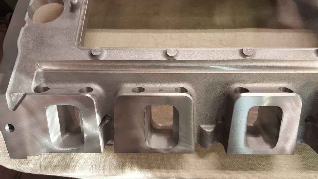

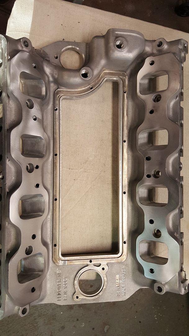

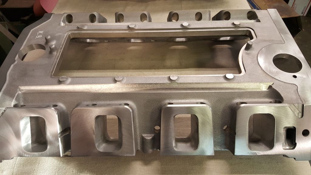

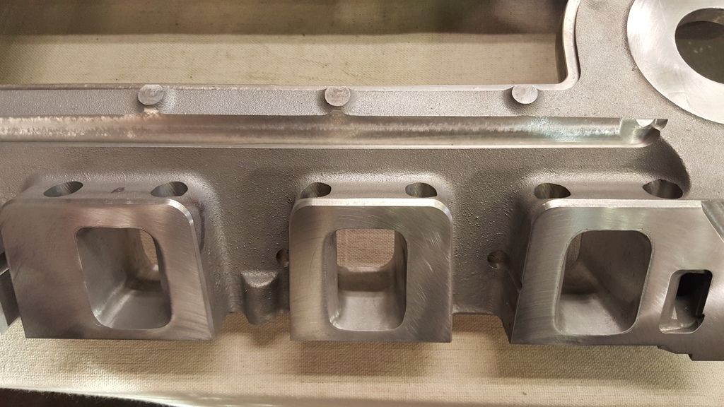

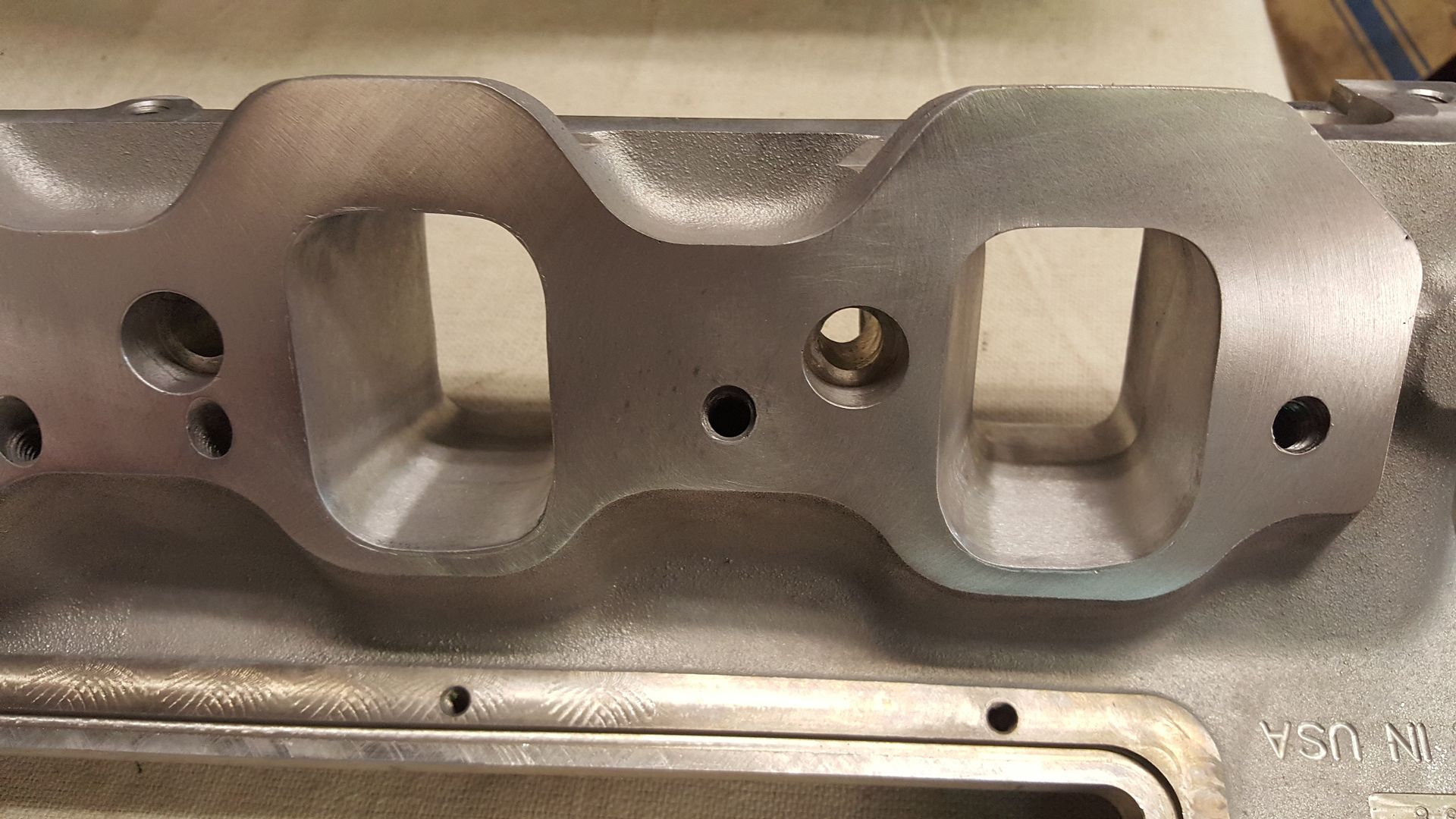

Finally all done with port matching the adapter to the Cleveland 4v (massaged ports) Tunnel FAB and Funnel Web intakes i have. The ports turned out nicely on the intake side.
Also got the head side all done and matched up nicely to the Kuntz CNC intake ports. I'm concerned a bit about how much pinch there is after working around the pushrod passages. Especially #2,#3,#6,#7.  I'm wondering how much or how badly this is going to effect things.

The pinch will definitely affect your airflow.  The only way around that is to run offset rockers, and move the pushrod holes.  I know of at least one guy who plugged the pushrod holes and redrilled them outboard when he switched to offset rockers.  I also think you could fill the holes with an epoxy and re-bore them.  FYI I have a whole bunch of programs to move the pushrod holes outboard from the port, exhausts as much as 0.100" and intakes as much as 0.250".  If you decide to go that route, Keith, let me know, I'd be happy to rebore the pushrod holes for you - Jay

I have for sure been thinking hard about just that. I will for sure do it once it goes over onto the pond block and I go to the TnD race setup. Problem is I'm a good ways out from even getting a good start on that project. I have done some looking although not alot but does anyone make offset rockers for the regular single shaft type system? If so I'd like to get the info because I'd like to be able to make the mods to the adapter now if offset shaft rockers are available. Should offset lifters be used as well if I try and take as much pinch out as possible ?

« Reply #56 on: April 18, 2016, 01:08:13 PM »
I guess I'm not sure if anyone makes offset rockers for a normal FE shaft system; maybe Dove or Harlan Sharp?  I've always just gone with the T&Ds.  On the lifters, offsets of 0.188" seem fairly common, and that makes the pushrod angle less if you run one of the 0.250" offset rockers on the intake.  I run offset lifters in my high riser engine.  Not sure what that does, if anything, to longevity of the lifters, but it does give a little more room for the port.

I think I have solved my offset rocker issue. I been messing around this morning and experimenting some. I was really wanting to use my erson rocker shaft assembly because I have made alot of mods to it so it will have 7 mounting points, (2 end head bolts and the center head bolt). What I came up with is some jessel rockers. A  roundy round engine builder friend of mine litteraly has boxes full of that stuff. I found some 178 ratio rockers that where straight,  .200 offset both left and right hand, .300 offset both left and right and some as much as .500 offer left and right. I'm sure the .500 is to much but the .200 and .300 are very close to your #'s. Ofcourse the shafts are smaller than the erson shaft but I figure I can press the bearings out and bush the rockers to the erson shaft size then re drill the oil holes for the roller and pushrod ends. Use the adjusters from my erson' s and be good to go. I fig its worth a shot, besides I like to experiment . unless this sounds like a terrble idea I think this is the way to go. He also has a bunch of offset solid roller lifters as well. I didn't sort through them much yet as I probably would just get new ones instead. If this doesn't sound to hacky then I'd be interested in having you re position the pushrod passages once I can mock things up and see just how far I need to go and if both the intake and exhaust need done. How much is the 178 verse's the 176 ratio gonna effect me. ? I pressed  the bearings out and stuck a make shift bushing In one of the jessels and slid it on the shaft against the erson. The tips, and pushrod end line up almost perfectly looking at it with a forgiving eye. Ofcourse more checking and measuring needs to be done but it was a quicky test as like I said I was supose to be working lol. Thanks for any input.
Also Jay, did you say once that you had elongated sleeves for the pushrod tubes ? If so would they fit in the re drilled passages so there would be something there to back up the epoxy ?
« Last Edit: April 18, 2016, 02:12:51 PM by fekbmax »

Sounds like good old hot rodding to me, Keith, I'd go for it.  Besides, Jesel is really good stuff.  On the pushrod holes, they are sized so that a 3/4" diameter thinwall aluminum tube can be squashed flat and pushed in there.  I don't sell those tubes, but they would be easy enough to make up.  If I remachined the holes, you could make up the tubes and put them in place, then fill the gap between the tubes and the port with epoxy, and I think that would work.

Got ya on the aluminum tube, wasn't sure if you had some already elongated or not. I can handle that no prob. I'd probably feel more comfortable letting you re drill the pushrod holes though. I know I could hack them up and make it work but feel like if I let you do them it would be much cleaner therefore much easier to make the repairs. Could you possibly e mail me with the info as to $ for doing the intake side and the best way and where to send it to ? Thanks for the help.
