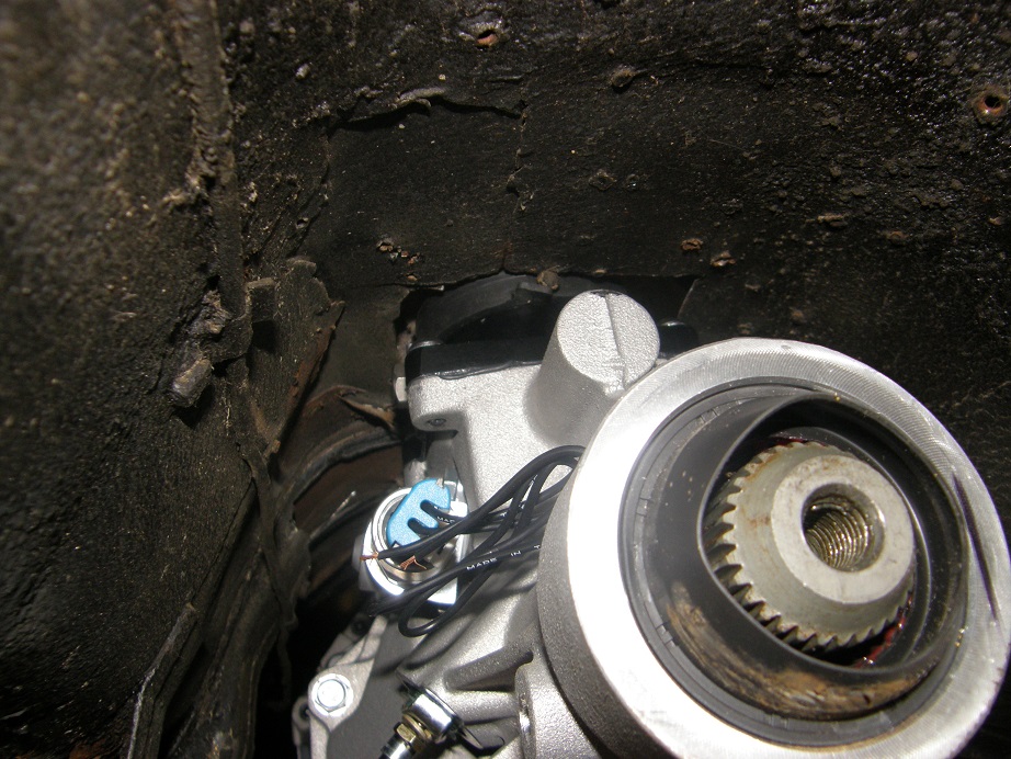

Thought I'd take a lunch break and post some more pictures and a progress update.  After getting the engine installed and one the mounts last night, this morning I worked on getting the transmission mount installed, and the transmission positioned where I wanted it in the car.
I started by jacking up the back of the transmission to see how well the shifter on the trans would align with the hole in the floor.  To my surprise and delight, it was nearly a perfect fit:
I could see there would be some minor trimming required around the opening, to clear the bolts on the left and right side of the shifter housing, but other than that there were really no issues.  Next I measured from the center of the transmission shaft to either side of the frame and the pinch weld of the rocker panels, and unfortunately found that the transmission was off center towards the drivers side by 1/2".  I thought I would try to just push it over into position, but there was interference with the tunnel in several spots.  The biggest interference spot was with these triangular ears that protrude from the passenger side of the transmission:

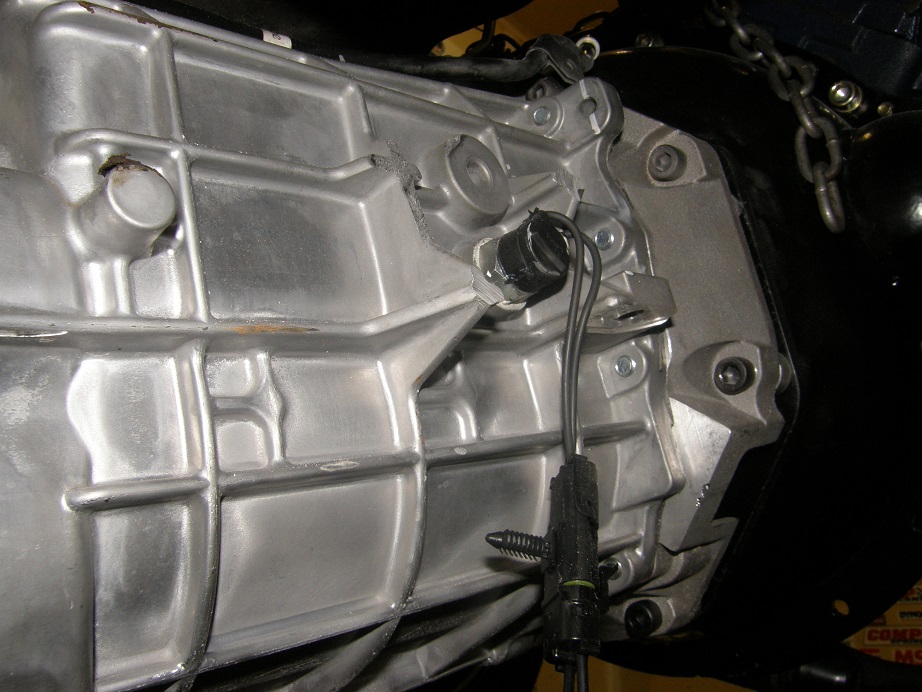

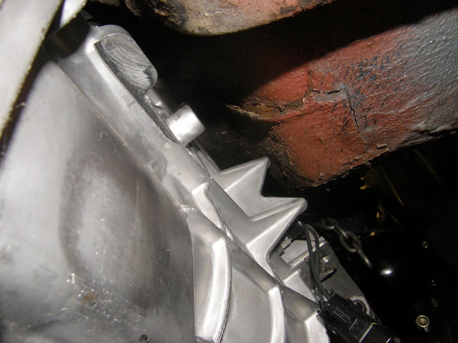

It didn't look like these things really did anything.  The top rear one was the biggest offender, so I decided to cut that one off with the sawzall, and grind a little on the lower rear one and top front one to add some clearance in that area.  Here's a picture of the modification:
After the modification I put the trans back up in the tunnel, but found more interference, this time with the factory crossmember support welded to the floor.  Some of that had been cut away already on Saturday, per Cory's post, but in order to get the trans centered in the tunnel I needed to cut away quite a bit more of it on the passenger side.  Down came the trans again, and with no good access for a cutting wheel I ended up using my plasma cutter to take out some more of the material.  Then I went in with a die grinder to clean it up.  Now with the trans jacked up I was able to get it centered in the tunnel, with at least 1/4" of clearance all around.

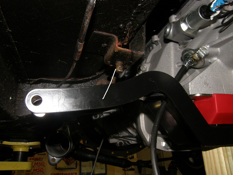

Next I tried to bolt on the transmission mount and figure out how that whole thing worked.  I ran into another intereference problem here, with the stud that comes down from the frame bracket that holds the emergency brake cable bellcrank.  In the photo below I've dropped the trans down a little; that stud sticking down has got to go:
This is kind of a problem because I was hoping to use the factory emergency brake cable to activate the emergency brakes built into the rear disc brake kit.  There is no way that bellcrank will fit in there, even with the stud still in place, because the transmission mount is in the way.  I think I'll end up dropping the whole emergency brake cable setup down a little, and fabricating a new stud that welds to the transmission mount, in order to make the emergency brake functional.  Just a little more fabricating  ;)

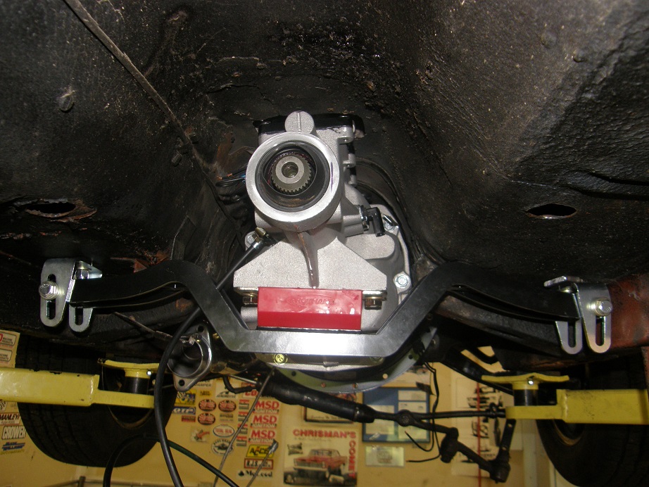

Here's a picture of the transmission mount installed from underneath, and then one of the interior of the car with the transmission up into position.  Based on how well it fit through the stock opening, I think it will fit my console just fine:

Jay, the transmission crossmember is not supposed to be bolted through the floor.
I don't have a picture of mine right now but I found a couple of pics online that shows the correct way to do it.
http://www.ronmorrisperformance.com/01hot_new/
The instructions that came with my kit was very clear on this. Are you missing the instructions?
Re: 68 Mustang Memorial Day Weekend Thrash
« Reply #49 on: May 25, 2015, 04:32:49 PM »
Thanks for that picture.  No, my kit did not come with instructions  >:(.  Looks like I bolted it up wrong, but to be honest I don't like the way it looks when is bolted up correctly, either.  I'm going to weld some tabs from the frame rail over to the bracket that I have bolted to the floor, and strengthen it that way.

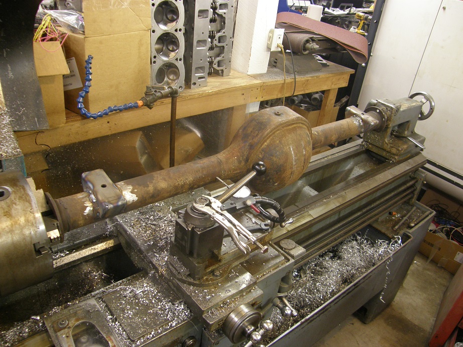

Over the weekend, amid a whole bunch of other stuff to do, I got the spring perches welded on the axle housing.  This is the first axle housing I've done in a few years, since I got my big LeBlonde lathe, so I thought I'd chuck it up on the lathe and look at the runout of the tubes after the welding operation:
I had about +/- 0.035" runout on one tube and about +/- 0.050" on the other.  I figured that was close enough; what do you guys think?

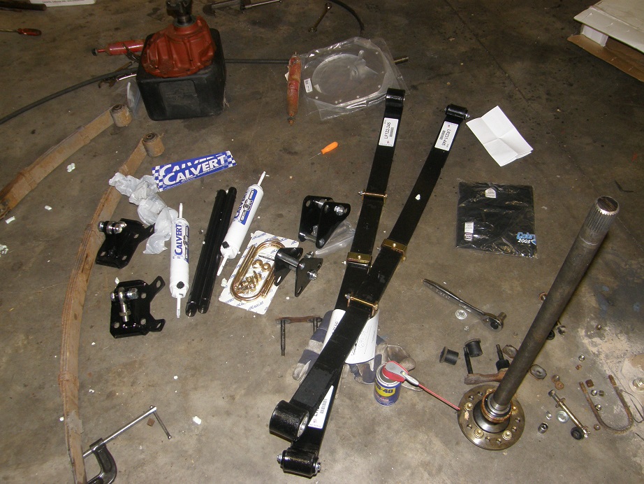

Also last week I called Calvert racing for the rear suspension package.  Today was Calvert Christmas:
I think I'll put the leaf springs in tonight...
