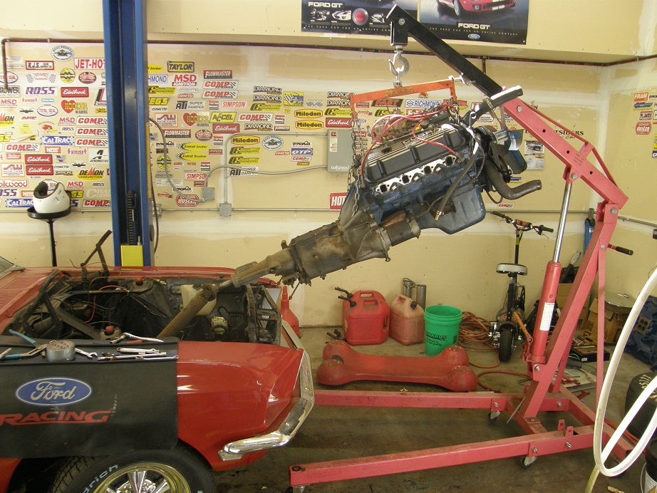

« Reply #8 on: May 22, 2015, 05:20:35 PM »
5:20 and the hated small block is out!
Now for a quick pressure wash of the engine compartment, and then I can spend the evening painting the engine bay.  Ready for the FE/Tremec test fit tomorrow...
