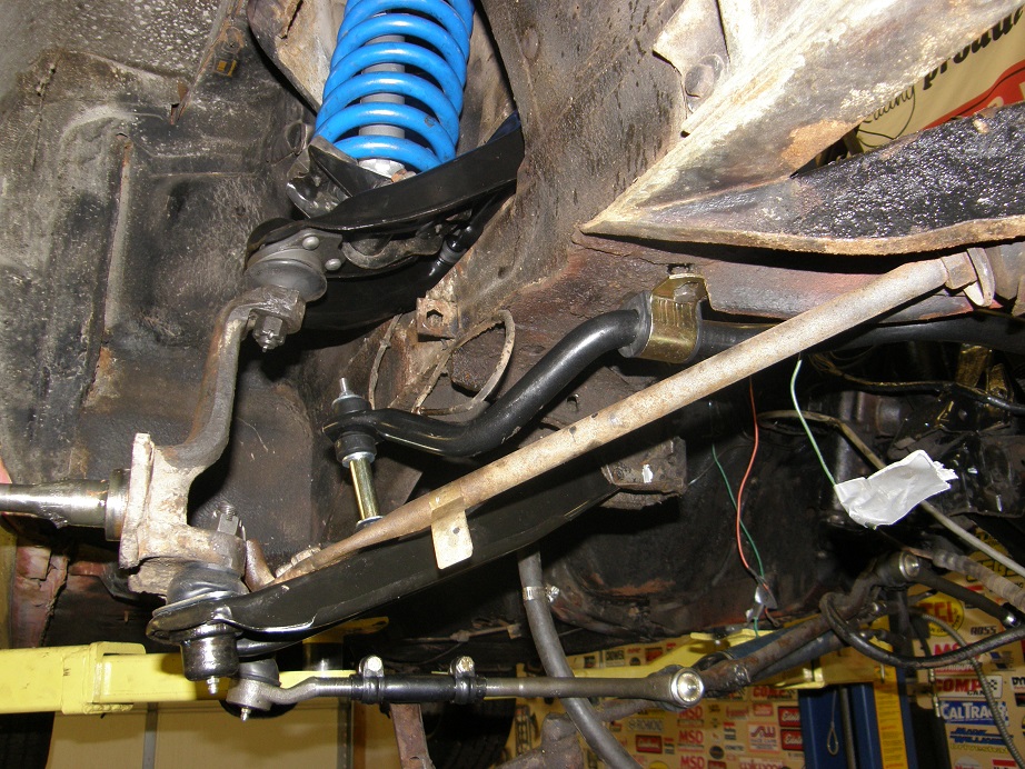

Steve and I also installed new front shocks, and a 1" front swaybar.  Finally, Steve removed the front drum brakes in preparation for the front disc brake installation.  Here's a picture of one side of the front suspension as it sits now:

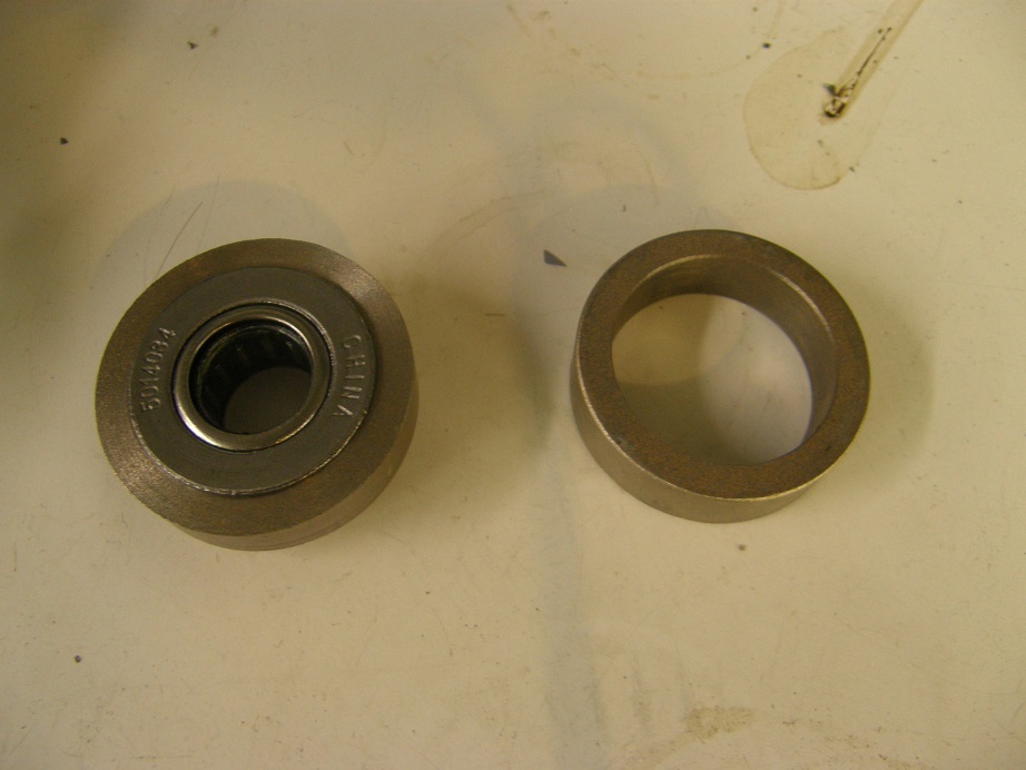

Back to the engine and trans, which I spent most of time on today.  Here's a picture of the new pilot bearing with the roller bearing installed, with the old one, which was too small in diameter, on the right:
Made in China.  Great ::)

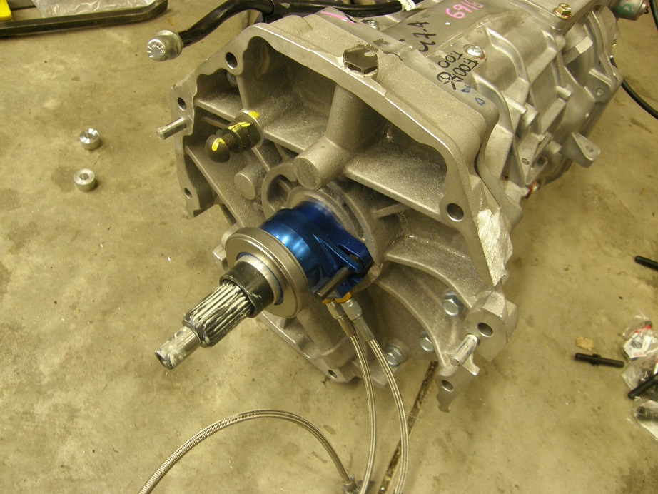

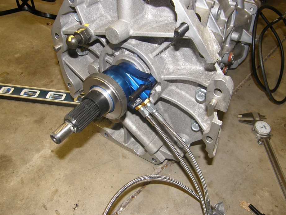

As mentioned earlier I did get some instruction sheets for the hydraulic clutch cylinder and throwout bearing.  Here's a picture of the throwout bearing installed on the transmission:
The instructions had me take some fairly precise measurements to set the distance from the throwout bearing face to the clutch fingers.  They gave you a bunch of shims to shim the throwout bearing to get it closer, in order to achieve a gap of 0.150" to 0.200" between the face of the throwout bearing and the clutch fingers.  Well, with a 1/2" spacer between the bellhousing and the transmission, I ended up with 0.110" of clearance, with no spacers.  It says in the instructions that anything over 0.100" is OK, so I'm going to stick with what I've got, but I guess if the spacer ends up being more like 0.550", it would put me right on the suggested range.

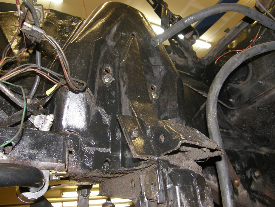

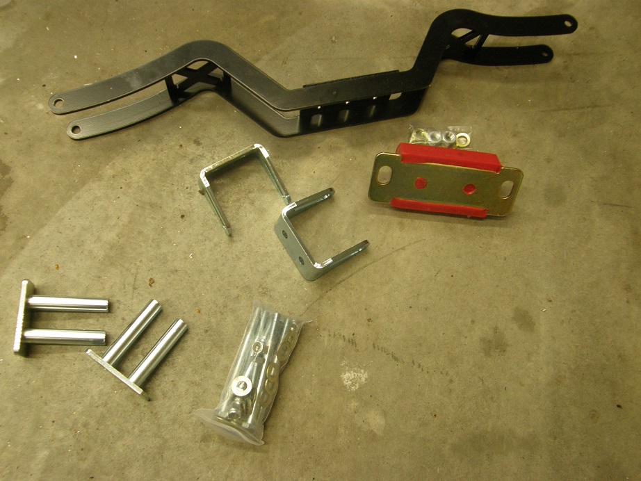

In preparation for tomorrow, tonight I started looking at the transmission mount.  These are the pieces that I think are involved (again, no instructions on this):
It is not obvious to me how this mounting arrangement fits into my car.  Anybody have any suggestions on this?

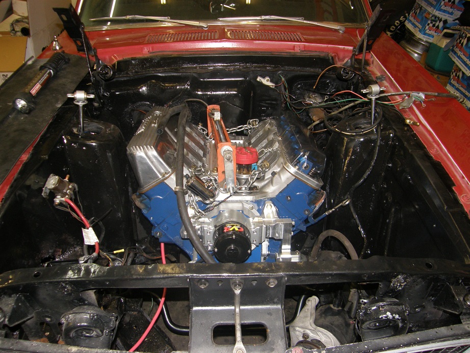

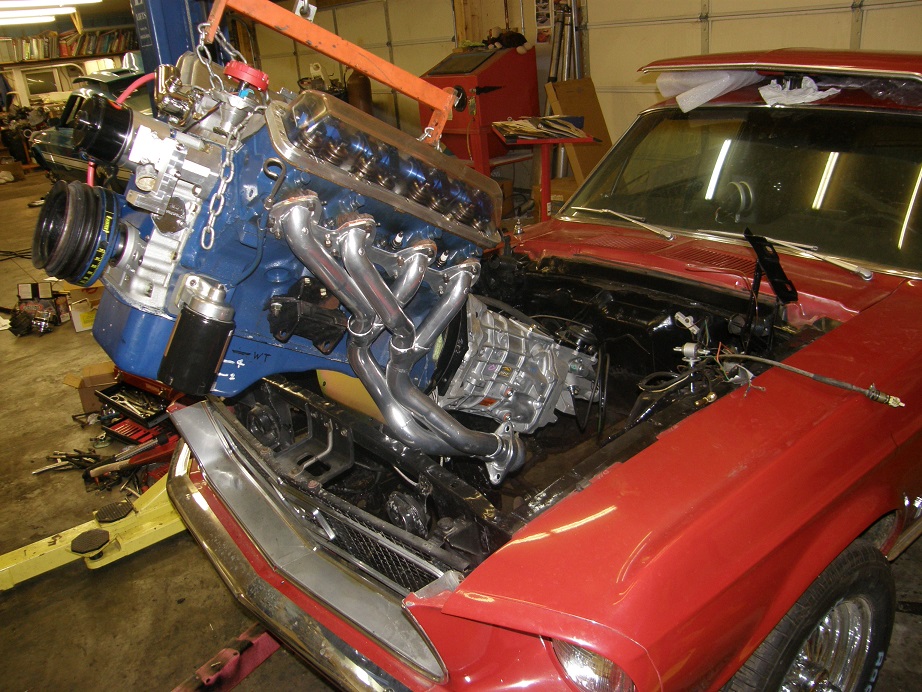

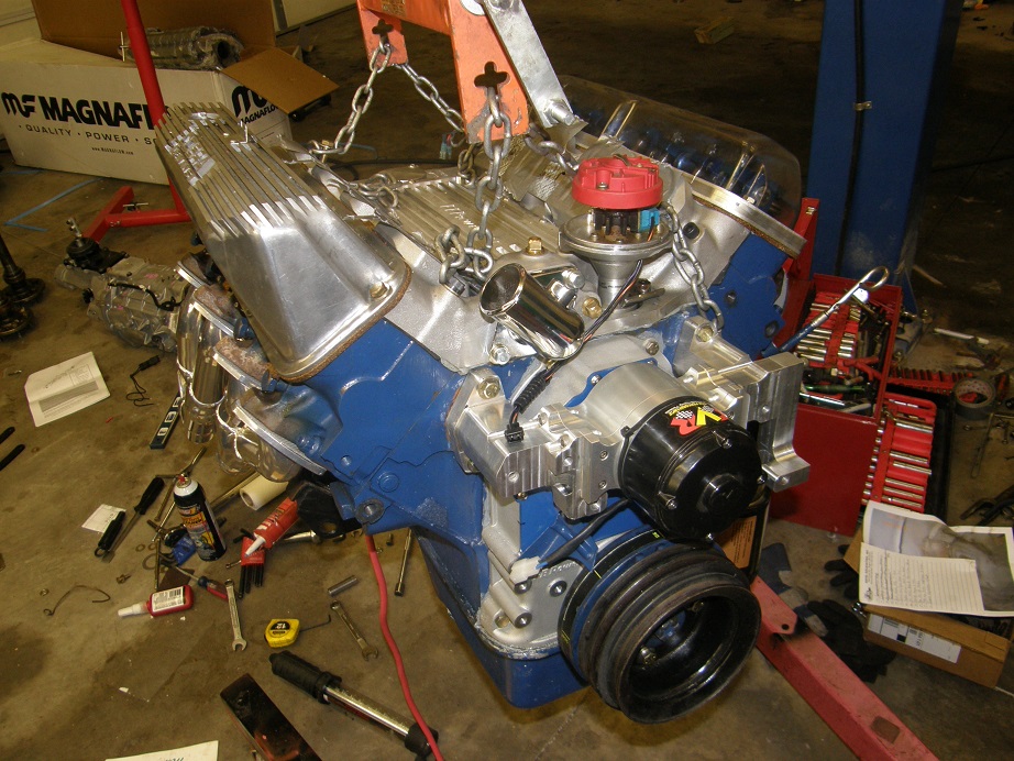

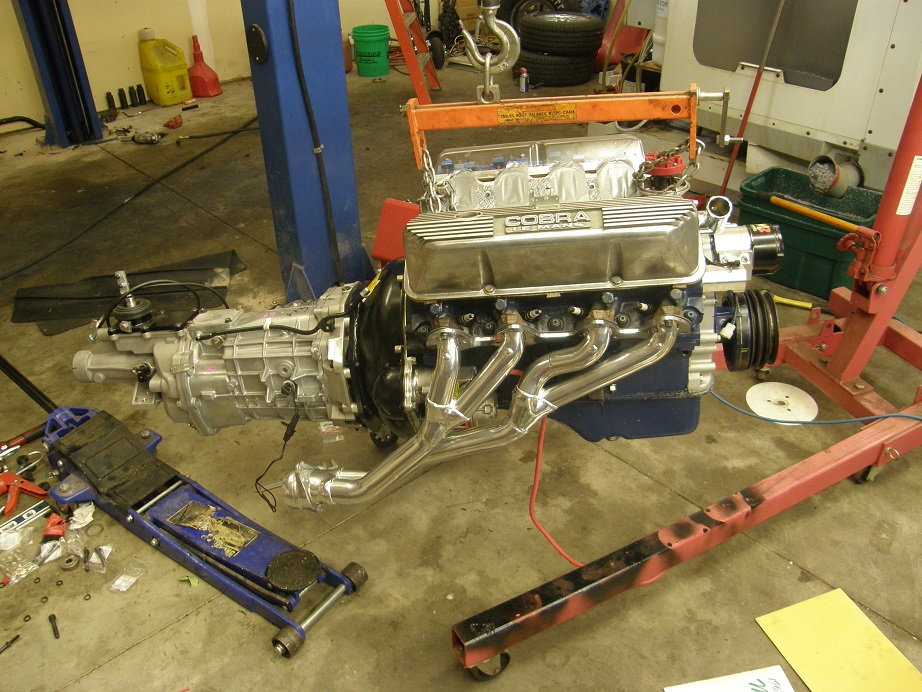

Its pretty late, so I'm going to let the pictures do the talking.  The first one shows the transmission with extended alignment pins, so I can use the 1/2" spacers to install the trans.
Next is the engine and trans assembled, with help from my friend thatdarncat:

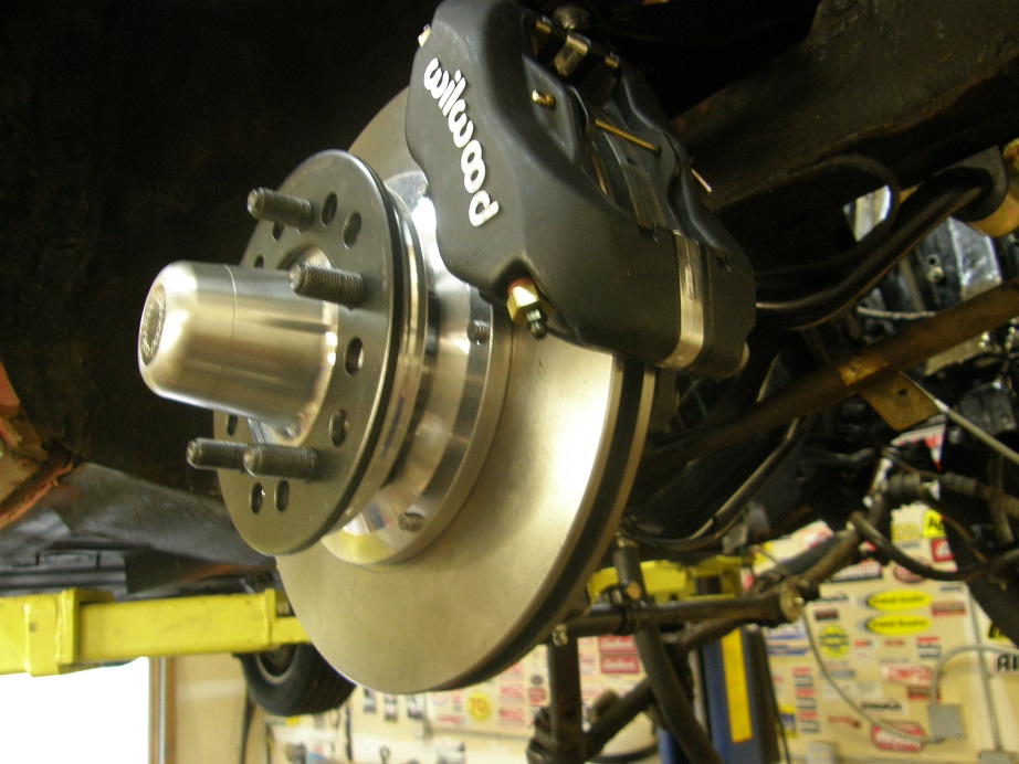

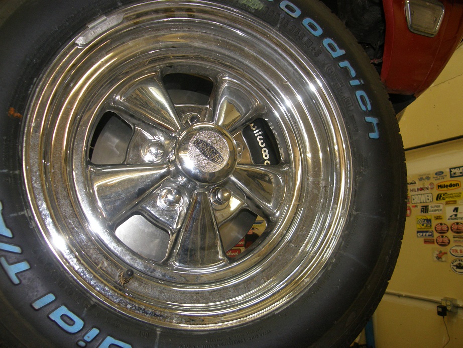

Here's a couple of pictures of the front brake installation, which I had to complete before I could roll the car around to get it ready for the engine and transmission:
And, here's the engine going in the car, and temporarily installed:
More tomorrow...
