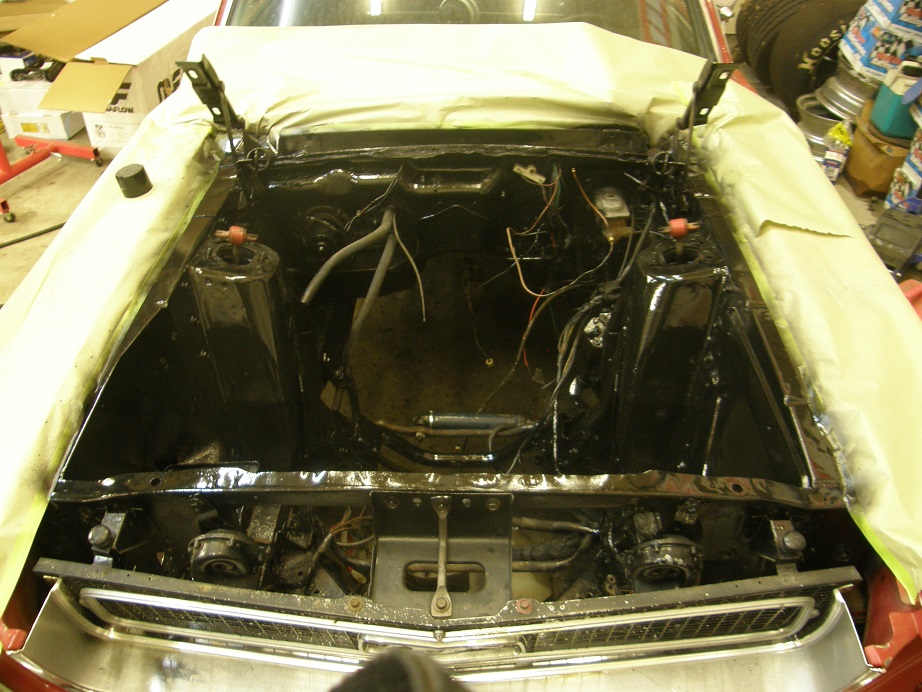

10:00 on Friday, and time to call it a night.  Just finished painting the engine compartment:
Its not perfect, but it will do.  It actually looks better in person than in the photo.  Some of the parts, like the shocks, sway bar, and master cylinder will be replaced so I didn't bother to paint those.
Its been a 15 hour day in the shop, but I've actually only been working on this car for 10 hours.  This morning I went to start my Mach 1 and move it away from the lift so I could pull the 68 in there, and it wouldn't start.  Took me three hours to figure out that all my fuel injectors had been stuck shut.  These are a brand called Injector Dynamics, and they are supposed to be extremely linear in their response, especially at the lower pulse widths, to provide better idle while allowing a very large injector.  But I had one of them stick on me once before, and after pulling them out of the car this morning I found that all four that I checked were stuck.  I didn't bother to check the other four; fortunately I have another set of injectors from Ford Motorsport that will work, so after a call to my EFI pal Scott to coach me on the changes to the EFI software with the new injectors, I got them installed and the engine fired right up.  Scott also mentioned to me that over the last year he had heard of a bunch of people having problems with the Injector Dynamics fuel injectors.  So, for future reference, my recommendation would be to stay clear of that brand.
Tomorrow my friend Steve is coming over to give me a hand with the installation, so with luck by dinner time all the issues will have been worked out, and my 68 will have an FE installed  :D
