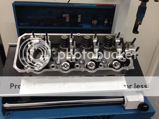

Well Machine shop called and my head is ready.  I had the valve guides on cylinders 2,3, and 4 honed after my valve bending debacle.  Here she sits ready for pick up tonight  !!  :

OK Head is home and now just awaiting the new set of gaskets from Precision Oil Pumps and then I can do final assembly.
