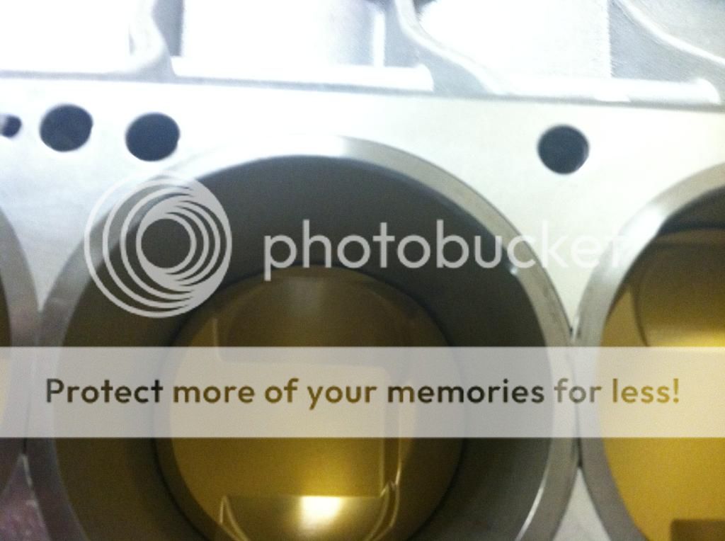

OK guys....  took the head off and surprise surprise.....  The intake valve nicked the lip of the cylinder!  Didnt touch the piston and wasnt stuck in the valve guide.....
So, with a little dremmel action and a diamond cone...  this problem will be overcome!  See photos below.  You can see a tiny witness mark on the lip.....  Just barely knicked it.

Update. Tried replacing bent valves on passenger side head this weekend, and it would seem i "scuffed" the bronze valve guides. Had the bring the head to the machine shop so they could hone the guides on intakes 2,3 and 4
While this is being done, i took off the timing cover, tensioners, backing plate and dampener spacer. All have been cleaned of old gasket material and sealant. I then spent about 1 hour taping up any openings in the block with painters tape for the cylinder notching process
With the head gaskets on, i used a blue magic marker to mark the cylinder lip. This was done to make sure i didnt notch too far. Then using a rotary tool and a diamond grit cone bit, i notched the lip of the cylinder where VC was needed. No contact on drivers side previous, but this was done as insurance
After, cylinders were cleaned for any debris until the oiled rag stayed clean. Rest of blocked re cleaned just to be safe before and after tape was removed. Head gasket, head and cam were reinstalled. Next will be passenger side. What did surprise me is how little area there is to notch. But i guess the original interference wasnt than much. There is no scarrier feeling than not being 100% sure when maching your $5,000 block LOL. But i must say so far so good. Hard to see in photo, but here is the notch in 1 example:

Before you cut did you stuff the cylinder to prevent debris from getting down in the between the piston, top ring & cylinder wall? That crevice would be impossible to clean without removing the piston from the block. Flipping it upside down while cutting might no be a bad idea either. There is allot of time, effort & $ in your build to rebuild because it was not internally clean before firing.
