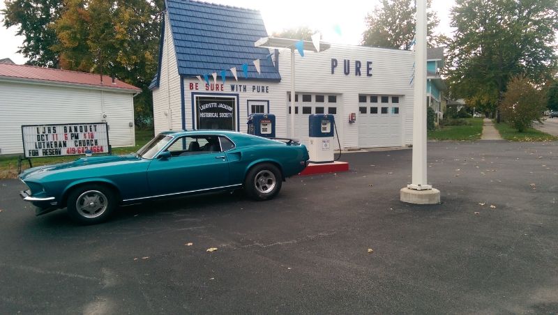

And here's a pretty cool filling station that was restored back to its former glory and turned into the local Historical Societys building just a few miles from me. Stopped just to get a photo op.
